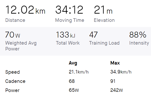

Thanks @mschwett and @Stefan Mikes I rode somewhat conservatively and came home with 2 bars of battery still! Interesting (black images are from Specialized app) and (white ones are from it being shared to Strava)
You’ll note 50km/h + max speed which isn’t in the ride app… strange…. Max speed on ride app is 36.7!
Either way great news is I made it home! Battery still with capacity and turbo used for the hills I needed it on!

Kris, it is so good you made it! I'm setting off for one of my shopping rides soon. I will use the standard SL Sport mode (60/60%) and will precisely measure energy consumption on the route similar to yours.
Strava tells you lies regarding the max speed. The system is re-analysing your trip and doing own calculations. The max speed I'm getting in Strava is always wrong regardless of how the Vado SL data had been collected. Funnily enough, it never happens for my big Vado...

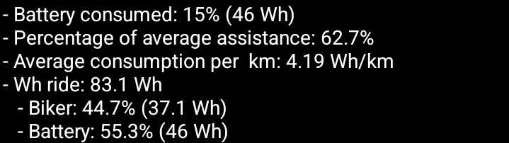

Mark,
I've just emulated a ride similar to what Kris had before. At 60/60% SL assistance (default for Sport on Vado SL) and with my sub 100 W legs as well as with the 25 km/h limiter, the motor used 4.19 Wh/km.
The useful charge in Kris' battery was (0.4 - 0.05) x 320 = 112 Wh. With the factor of 4.19 Wh/h he could have made a 112 / 4.19 = 26 km ride. No worries mate, she'll be right! 😊
