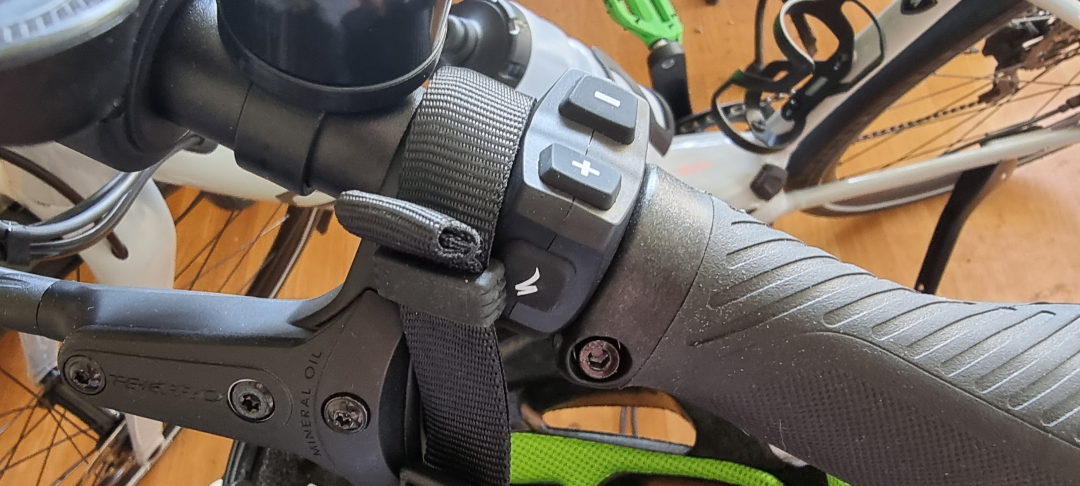

In full power Vado/Como, the wired display pages can be flipped with a handlebar remote button. As Vado/Como SL are so different, two distinctive buttons exist in the handlebar remote: Walk Mode (very effective) and Specialized Lightning: You get into Turbo mode instantly.
The S-button.
The status of the SL bike is reported on the TCU. The 10-bar battery indicator is impressive. If you connect a Range Extender, you can see two sets of flashy indicators! And you can see the current Assist Mode there (and even set it). When the optional TCD display is connected, the TCU display becomes redundant. The Stealth Mode can be turned on; the mode hides the TCU diodes that only re-appear when really necessary.

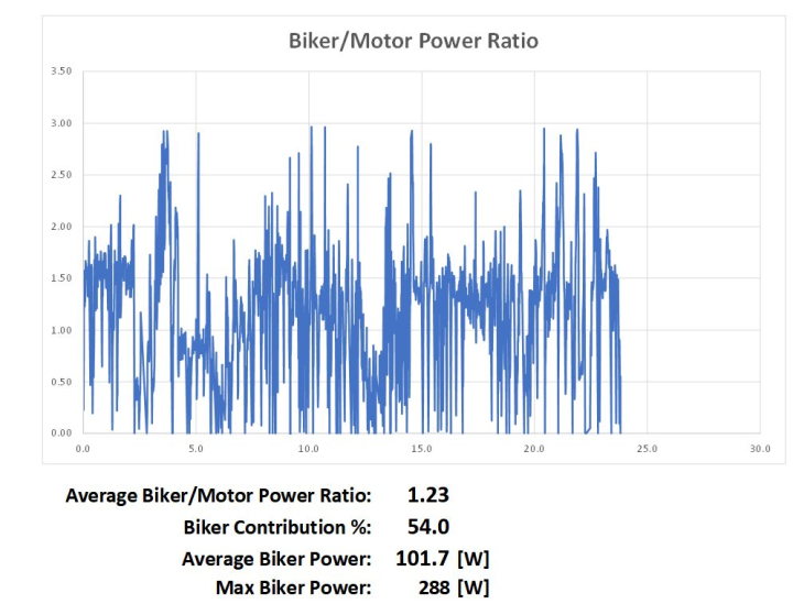

I'm curious, that graph of the motor and biker power. Is that from BLevo software?
Indeed! You record your ride in BLEvo, and post-ride you can display more details and eventually "share" a CSV file (I send it to myself by Gmail). As CSV is an Excel file, I do a post-ride analysis in Excel. For instance, the "average biker power" reported by BLEvo is a true average including coasting. I'm not interested in such an "average". I'm interested in my average leg power when I'm pedalling. Or, "average cadence". My pedalling cadence is decidedly higher than 60! (Because again, the overall average involves coasting).
