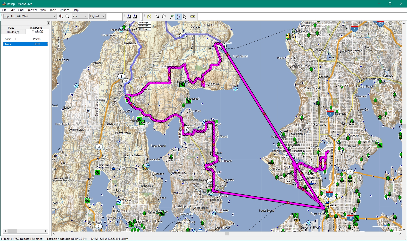

I did some of YOUR hills about two weeks ago on my Aluminum Creo. I would have really liked a kick-ash button - give me another spurt of power in a few places. Almost 53 miles and 2800 feet of gain. Gunderson was no fun as a long uphill trafficky grade. Then the shoulder ends before the top. The "bumps" on Bainbridge Island nearing the end were tiresome.
I used the Range Extender battery and had about 6% or so left on each. I turned the power to Zero where I knew if was flat or downhill. I'm old and overweight.
We pedaled to downtown Seattle, took the Kingston passenger ferry, Indianola, Poulsbo for lunch, Agate Pass Bridge (always, ahem, fun) and Winslow ferry back to downtown and then pedaled home near Greenlake. More power would have been really nice. But then the bike gets much heavier. That was my tradeoff.
You were VERY close to my house. Yeah, Gunderson is ridiculous - - no shoulder and cars whizzing by at 50mph. That bit of the Port Gamble Rd is scary, too, since it has no shoulder and no sight distance because of hilly curves.
We thought that the next time, we'd do Port Gamble and Big Valley. The last time I did the loop above, it was on a regular, non-ebike but I'm older and one hip has been replaced twice. But I really did not want a very heavy e-bike. So the tradeoff is I have to PUSH those pedals more on some of the hills. This past weekend, went over to Eastern Washington. My friend dropped me at Washington Pass and I pretty much coasted the first 15 miles losing 3,500 feet. Then it got hot and flat to modest uphills into Winthrop and I used power.
