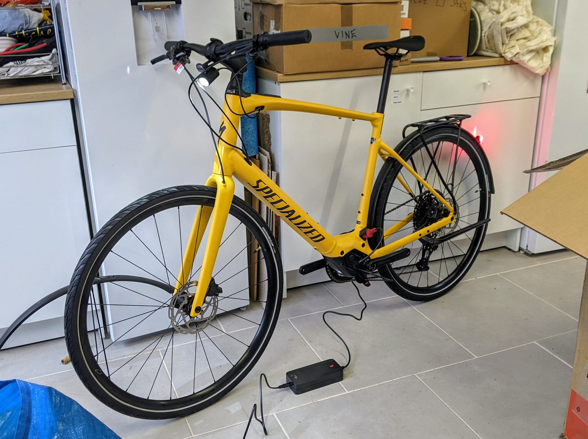

I finally took delivery of my '22 Vado SL 5.0 EQ today in the ever-so-subtle yellow finish.
These are few and far between in the UK, but one appeared in XL. I've only used it to ride down and back up the 25% unmetalled track to our house which it coped with admirably (and wasn't something I could do without rupturing something when on my non-eBike Cannondale), so first impressions are very positive. Longer trip planned for the end of the week.
Does anyone have experience of bags (not panniers) for the rack? Something big enough for a camera, jacket, lunch etc.
Spec appears as currently listed on the Specialized website as far as I can tell. It's got the top bar-mounted display for mode/settings/distance/altitude which I have yet to find mention of in the manual. The current iteration of the software appears to list ECO-TRAIL-TURBO modes rather than SPORT.

What a gorgeous colour! (I wish I owned one). Sincere congratulations!
I can understand you have got the Mastermind TCU. Interesting! You seem to be the first EBR member to have got it!
If you really need a bag, find something Racktime compatible -- with SnapIt 2.0 adapter (I do not use Racktime gear so I cannot be of any help). Have look at "System Bags" here:
P.S. Was the regular TCD display the part of the deal?
If "the regular TCD" is the unit that clips to the stem then it's not included. Or, if it was, I have yet to find it! There is a mount on the stem that looks like it would take the Garmin Edge 25 or similar ... a 90° turn to lock. There's a bag of all sort of extra bits, but they look like springs for the headset unit, odd little spanners and plastic covers for goodness knows what.
My exploration of the Mastermind TCU has been limited (I didn't actually know what it was called), but it appears you can customise what is displayed. I'll have a play over the next few days, though I'm really more interested in riding than seeing my heart rate stats or whatever. I've set up the App to sync with Strava and tend to look - if ever - at the information after the trip, not during it.
Thanks for the rack info. I'll see what's available.
PS And yes, the colour is lovely :)
That is for TCD if you buy it. The TCD is practical as I do not think it is easy to peek between your legs at the TCU Mastermind :) However, Vado SL also connects to Garmin Edge and Wahoo ELEMNT (just saying).
There are many things you can achieve by F1 and F2 buttons as well as by + and - combinations. I think operating the Mastermind TCU from the handlebar remote works the same way as operating Mastermind TCD-w does.

Nice looking machine. Too bad that the red charging plug's red clashes so terribly with that yellow color/colour! ;)
Enjoy it immensely.
"oi tam oi tam" :D (A Polish slang to express you are picking on something without a good reason) :) /written: ojtamojtam/
I'm colourblind ... I can see red/green but can't necessarily tell them apart. I didn't know what colour the charging plug was.
Now I know it clashes I'll obviously be selling the bike ;)
