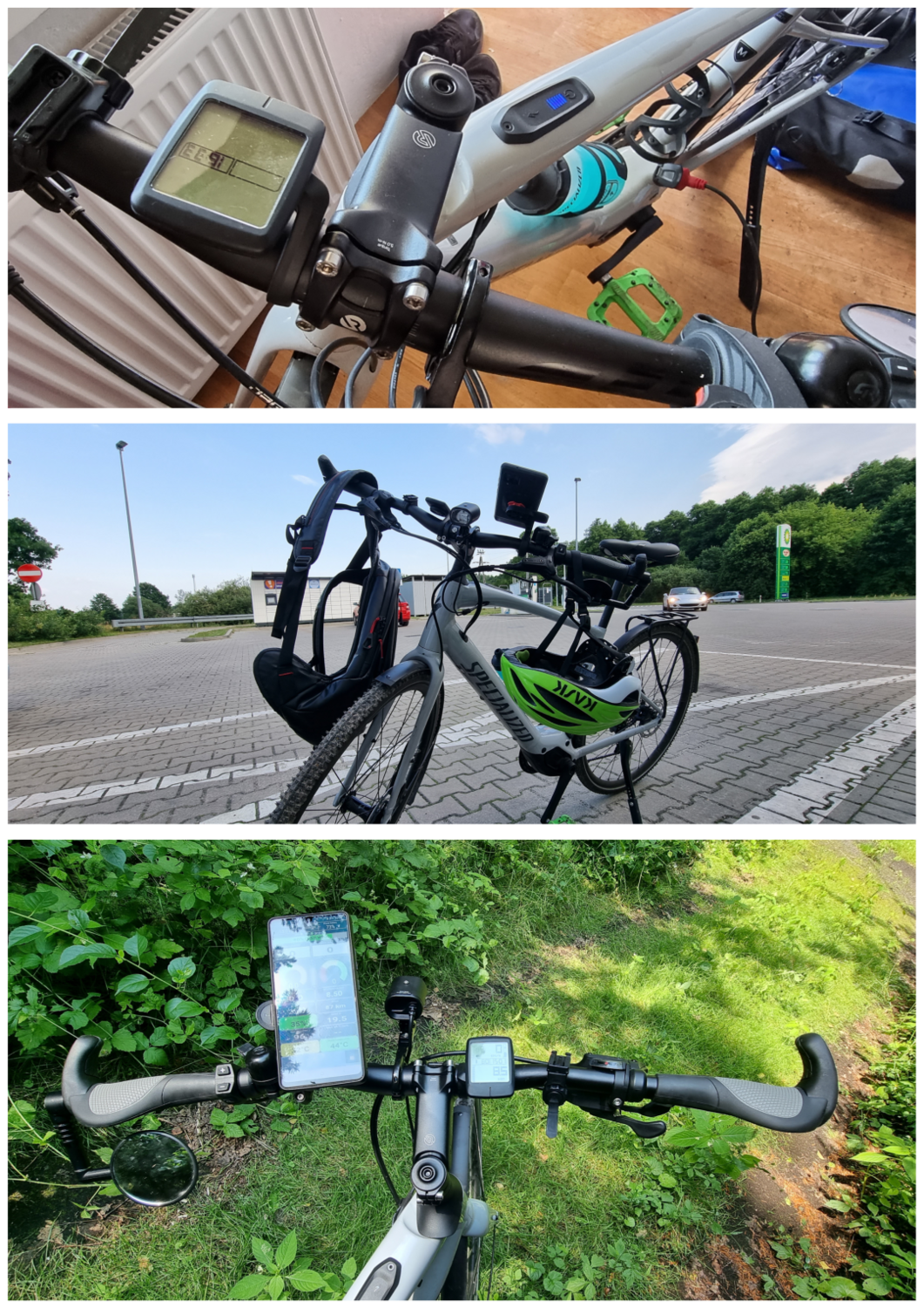

Redshift ShockStop Stem is incredibly good, trust me! Now, you need to relocate the headlight and it is done with a GoPro mount, not a Garmin one.
If you would like to do something interesting, you might try complementing your handlebars with installing SQlab Innerbarends. Now, it is a little bit confusing:
  • SQlab Innerbarends 411 can be used with any handlebar grips, even with the very good Specialized stock ones, or
  • SQlab Innerbarends 410/402 can be used with either SQlab 710 or 702 grips.
The Innerbarends are installed on the inside of the handlebar grips. They perform similarly to road e-bike handlebar hoods, only are spread more apart. The Innerbarends allow very easy control of brakes and of the shifter. I am convert now! The only deficiency is the Innerbarends feel hard in touch and riding in gloves is recommended.

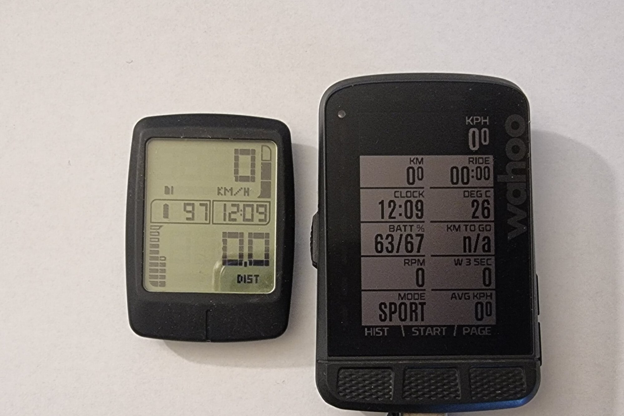

I’m thinking about getting a TCD for my Vado SL 4 EQ So I don’t have to mount my expensive iPhone on my handlebars. But, I still want to be able to use Strava or Ride with GPS on the phone in my pocket.
I would use the TCD to monitor speed, battery and so forth while riding. The iPhone apps would be used for recording health data, turn by turn directions and so forth. Will both work simultaneously? It’s not clear from the docs.
Hi BEC,
Everything will work seamlessly just as you think. I only give you a thought for a consideration: an e-bike GPS computer such as Wahoo ELEMNT Bolt v2. Or a Garmin Edge (starting from model 530). Any of these computers would replace your phone for:
  • Recording your rides with export to Strava (and possibly twenty other services)
  • Reporting the full status of your Vado SL (anything that you can find on the TCD screen) as these bike computers connect to your Vado SL perfectly
  • GPS navigation
  • Connection to a heart rate monitor
The greatest benefit of a bike GPS computer is there is no chance for the battery go flat during your ride. These computers are durable, and capable of standing very low temperatures.
I have found the only functionality of the TCD that is getting dusty in my drawer is a quick check of the battery level in case I don't want to wait for Wahoo to start :D
In case you choose a Garmin Edge (530, 830, 1030+), it mounts directly into the TCD mount. If you select a Wahoo, you need a Quarter Turn Wahoo-Garmin adapter. I personally recommend the Wahoo (and specifically ELEMNT Bolt v2). I use Wahoo ELEMNT Roam, which is more expensive but Bolt v2 is more modern and actually superior to Roam, and it is less expensive. (A great benefit of Wahoo over Garmin is the former is easily configured from a smartphone, while the latter requires configuring on the device).
A Wahoo ELEMNT Roam on my Vado SL 4.0 EQ. I have used another mount.

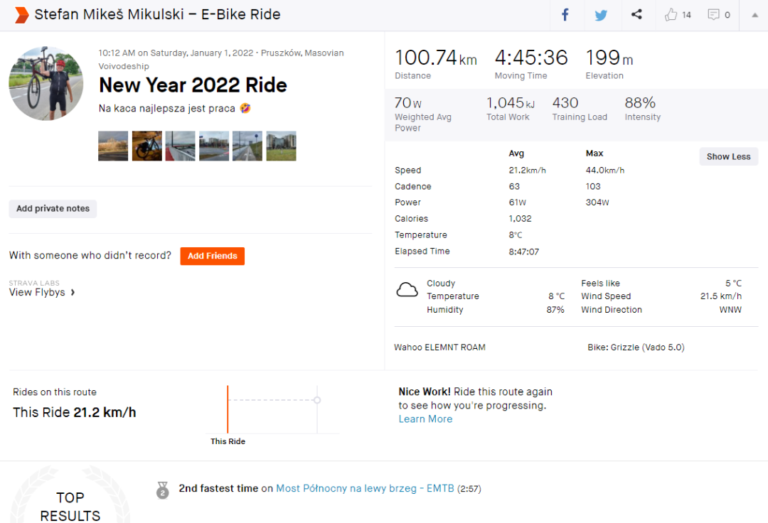

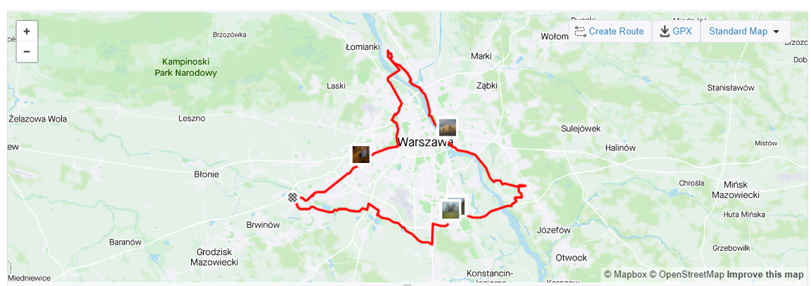

This is how a Wahoo ELEMNT cooperates with Strava. (I didn't connect my HR monitor for the ride).
As I had no route plan predefined, I used the Wahoo function "Take me to..." thrice for that ride.

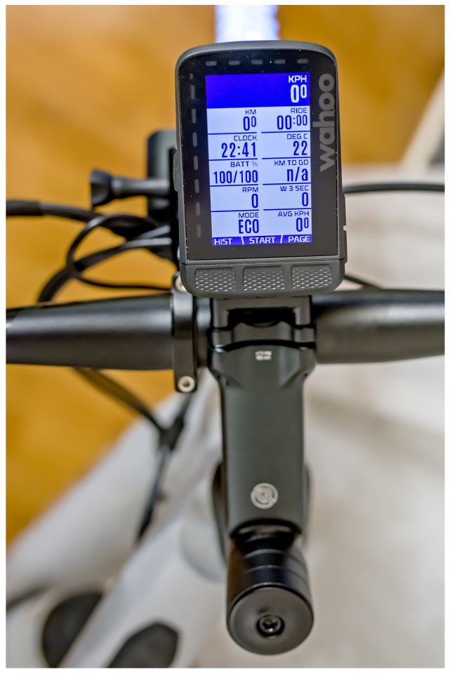

Yes it does. My route was more complicated, as I replaced the stem of my Vado SL 4.0 EQ with Redshift ShockStop, and later bought the Redshift Computer Mount (Wahoo). The original Wahoo mount is on my big Vado now.
When I ride my Vado SL, I keep my smartphone in the back pocket of my jersey (Wahoo loves to be nearby to a smartphone at times). When I ride the big Vado, my phone stays on the bars just as a backup.
