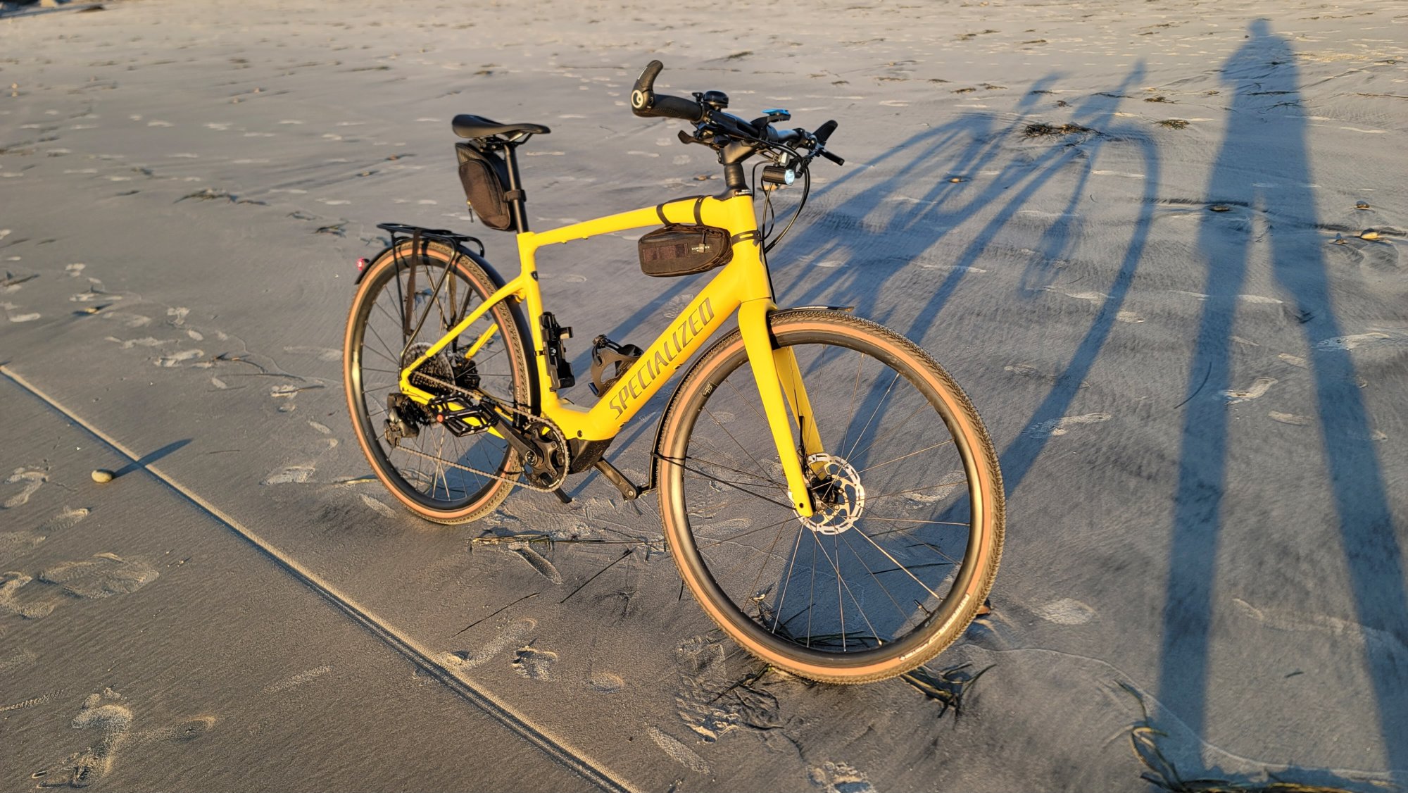

My SL has been running 38 mm tubeless Pathfinder Pros for almost 3,000 mi of road, hard pack, gravel, low-tide beach sand, and some easy single-track now and then. A lot of the off-road surfaces have been far from luxury.
Point is, the 38s have been more than adequate on all of that. So if you can't find 42s, the 38s are a good fallback.
