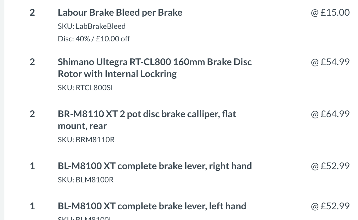

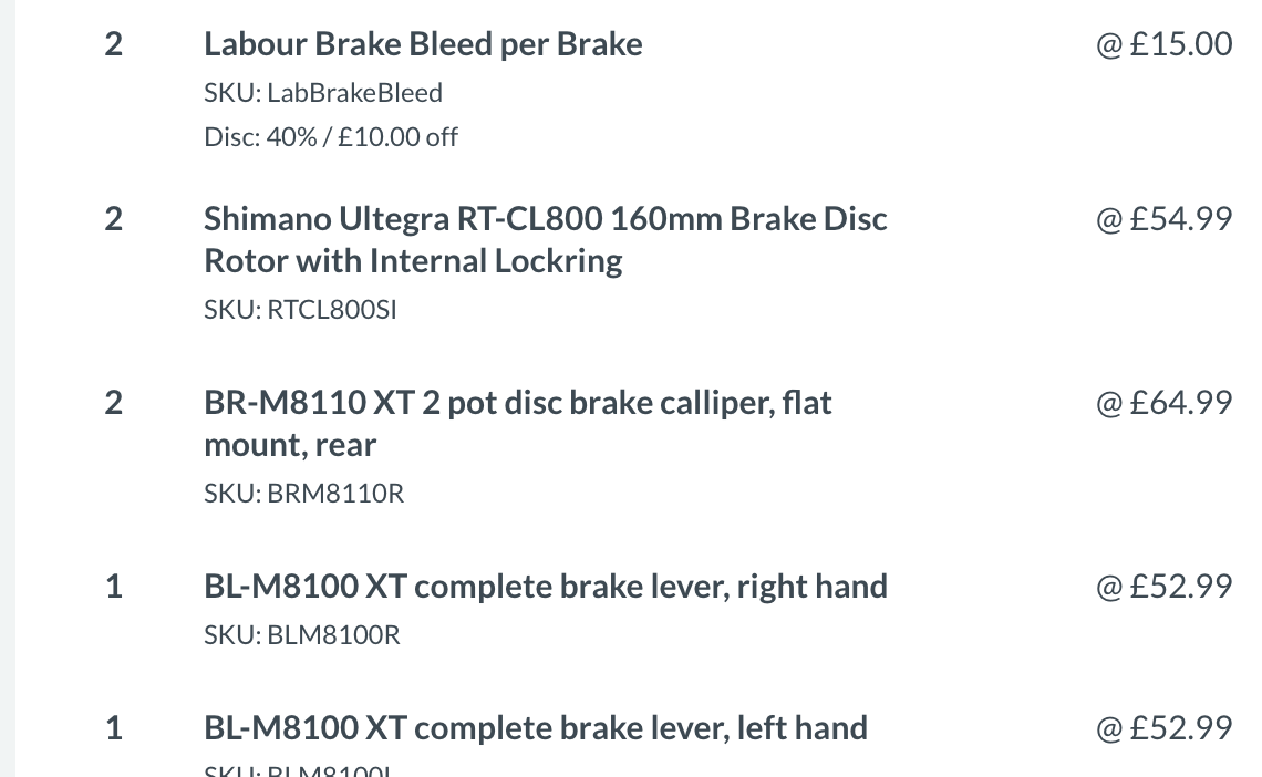

I remain super impressed with my Shimano XT brake upgrade.
One finger operation, lovely feel, they were better than I expected and give me a warm fuzzy feeling every time I need to use them ☺️
More about that upgrade, please! Total cost parts and labor?
Based on my mechanic's less than glowing assessment of the SL 1's stock brakes, that could well be my long-term solution.
