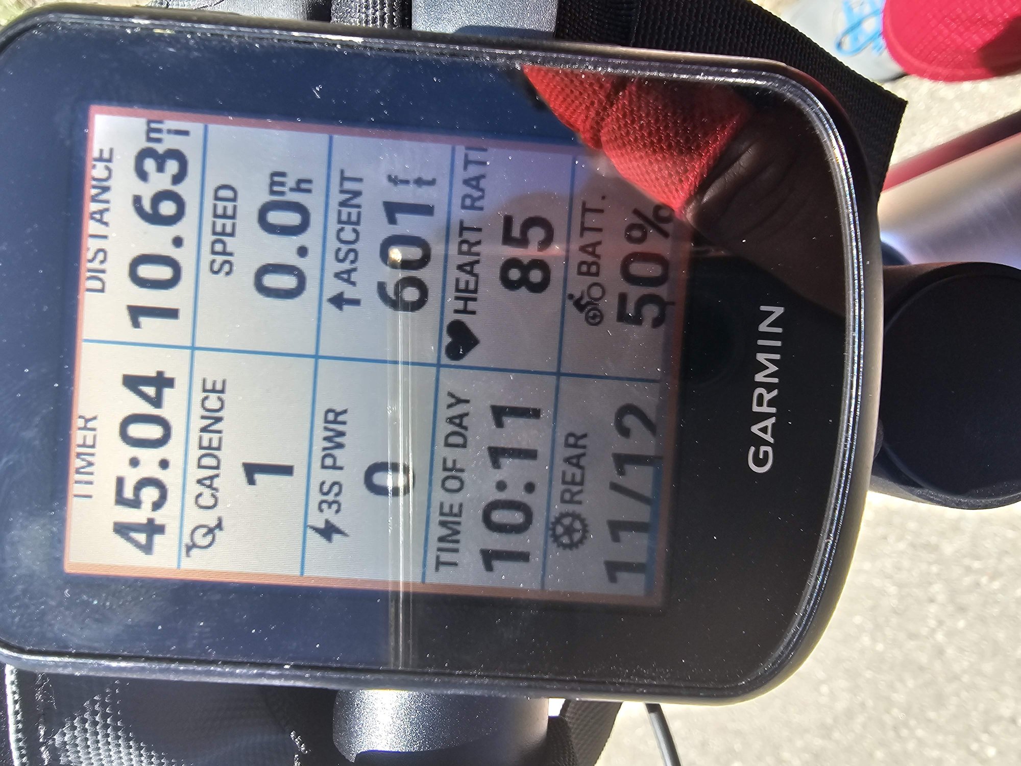

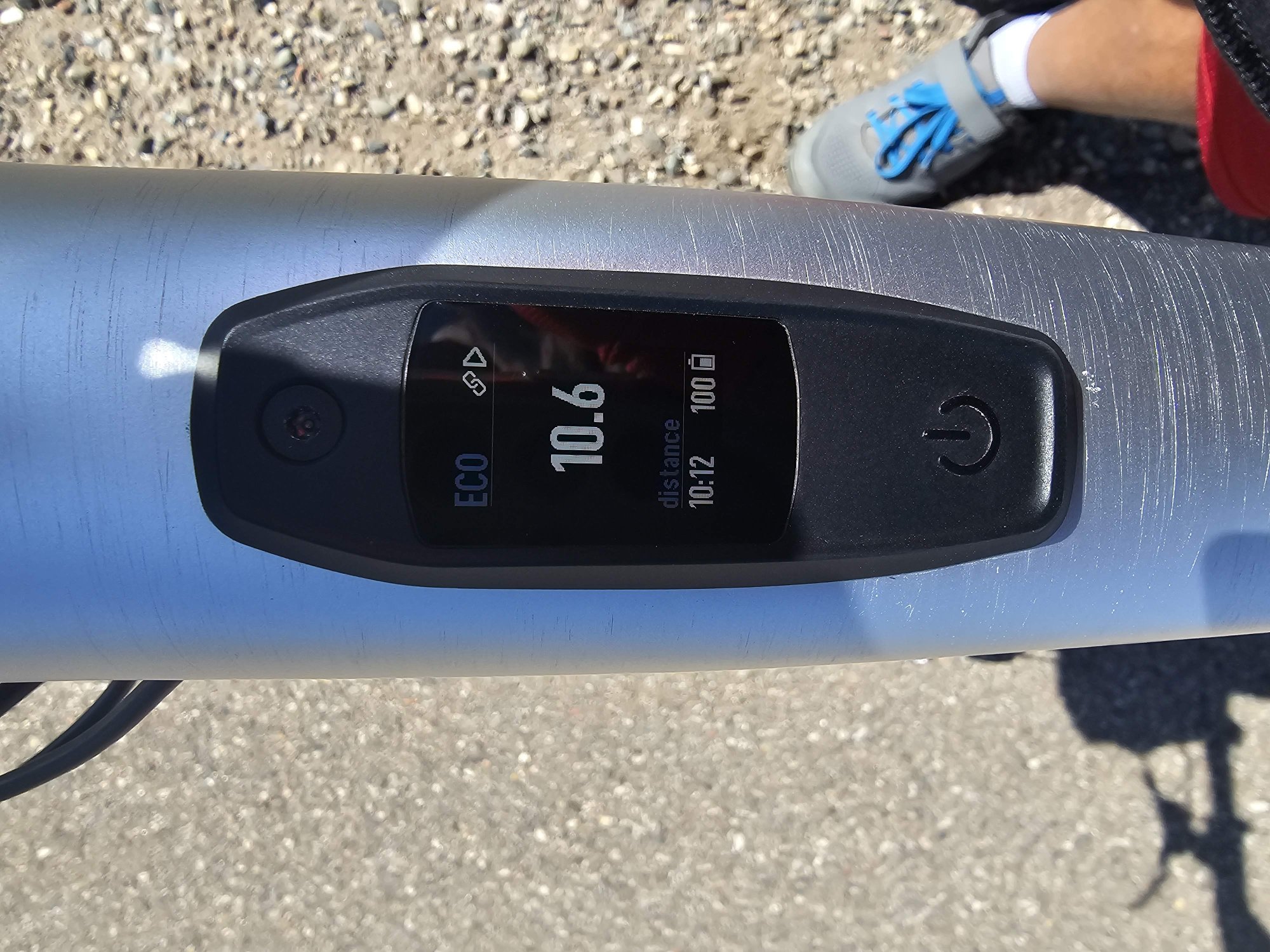

Ok... So I hate to admit this, but Stefan is right in this instance. My Garmin 840 only displays the main battery level. I was misled, because I always ride with them draining together and thought the Garmin was displaying a combined %. It is close because when you start with them both at 100% they do drain similarly, but not exactly.
Started out at 100% with just the main battery. Went down to 50% with the main. Then attached the Range Extender so the total on the Specialized display showed 100%. The main and % on my Garmin stayed around 50 until the Main+RE went to about 80%. Then the main started to go down.
Interesting things I noticed. I rode in Turbo the entire way so I could drain quicker.
  • If you attach the RE while the bike is turned on, the bike shuts down and you need to start it back up again.
  • If you disconnect the RE while the bike is turned on, it seems to adjust ok.
  • If you attach a full RE to a half-full main, the RE drains first for a while. Then when it gets closer to the Main level, they both drain together but not exactly the same %.
  • I hate riding full-time Turbo mode. I feel like the bike is very jerky. Also, when switching gears, sometimes it almost feels like the bike motor is slowing me down until I pedal faster. It's not a smooth experience like it is at 60-65% or lower.
So, Wahoo does have their API reading main battery/RE. Garmin does not. That doesn't mean I like Wahoo better. The way I use my bike it doesn't really matter to me that much. I still prefer the display, touchscreen, routing/map functionality on my Garmin.

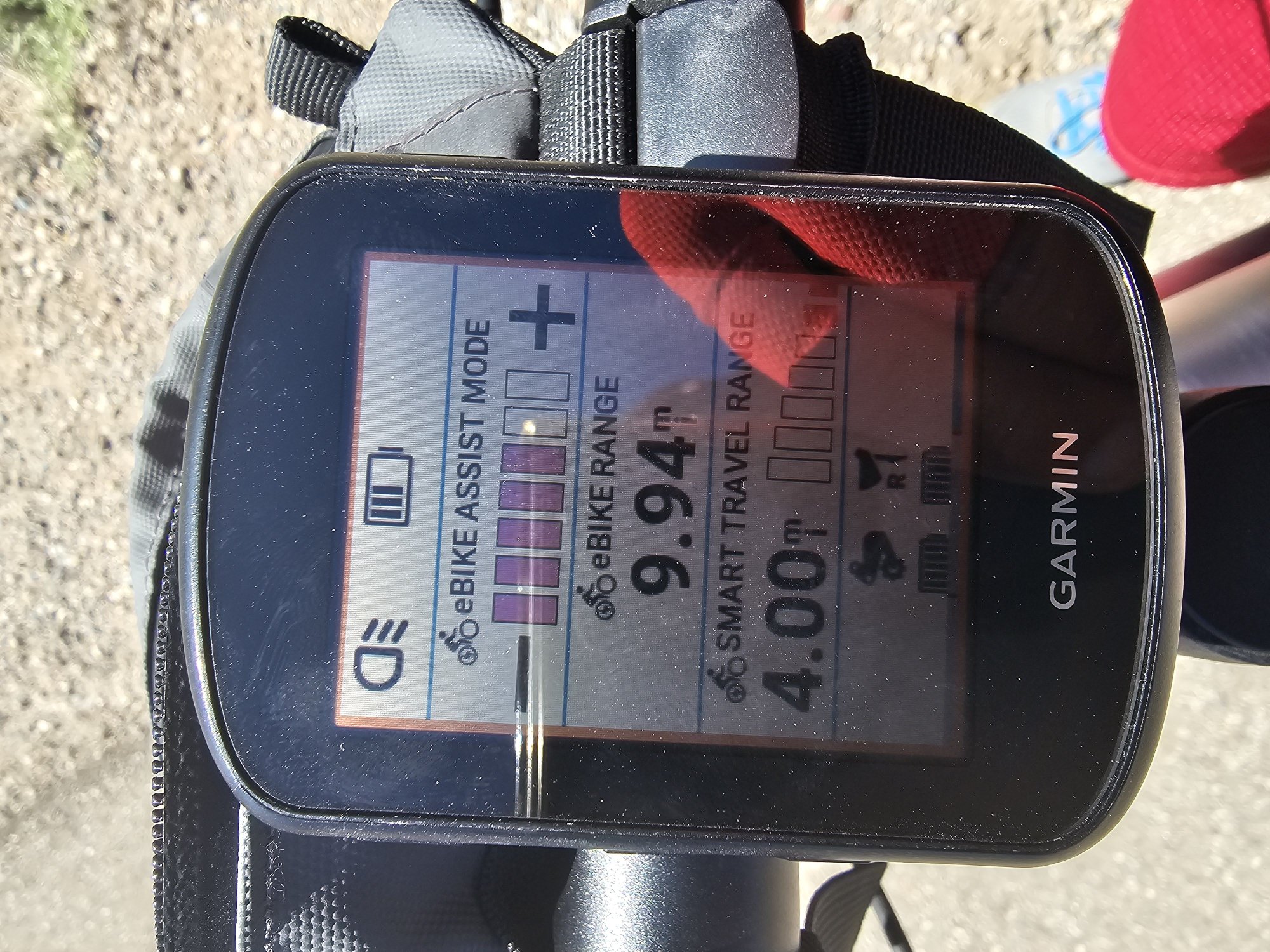

Ok. So rode about 32 miles today. I have a Turbo Vado SL 5.0 with a Garmin Edge 840 latest firmware. I also was using a range extender. So started out with 150% battery on specialized (100% on Garmin). I was riding almost 100% at 60/100 assist.
On my Garmin, shift advice wasn't working. Maybe it isn't compatible with the Vado. Travel Range on the Garmin is the same number that is being reported by Specialized as Estimated Range. Smart Range is something different.
When I started, Estimated Range was 52 miles. Smart Range was around 10 miles.
Garmin smart Range would change as soon as I moved from sport, eco, turbo. Estimated range changed intermittently. Not sure why or when. I tried seeing if it was mileage or time related or battery related, but none of those were consistent.
Smart Range seemed useless to me. Not sure where Garmin is pulling this number from or if it's configurable.
Estimated Range ended up at 17 when I finished my ride at 32 miles. This was with about 40% battery left. For the last 15 miles of my ride, it was pretty much keeping me at 49 miles total range. Not sure if that total range number was correct, but at least it was consistent.
I'm going to msg Garmin to find out what is going with Smart Range.
Ok...so there are two issues going on here.
#1: Garmin isn't using the Range Extender in it's calculation (good catch Stefan). So Specialized estimates a much longer ranch with the RE.
#2: Even with just a main battery, Garmin Smart Travel Range is about 50% of what Specialized is calculating. I created a case with Garmin engineering and they are looking into it. I wouldn't expect their calculation to be the same, but it should be closer.
