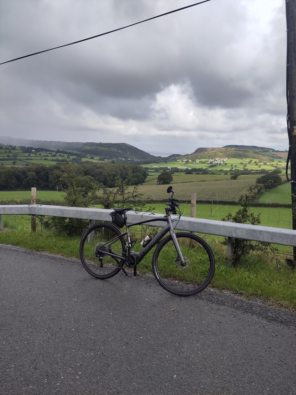

One more thing to note; when you change the chainring you lose the chain guard as only the specific one has the facility to attach it. No biggy for me.(see photo from today's ride)
Well...the plus side is that it 'looks cooler' that way.....the negative is that you could get your laces or pants leg caught up in it.
I see that you still have your rear 'dork disc' installed. Now that you have solved this chain slip issue it is time for you to remove that dork disc so that you may run with the 'cool kids'.
