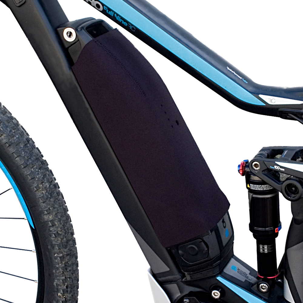

A cover to install on bike without battery would be nice.
Would be handy for transporting the bike, to cover the battery cavity from dust and rain.
Such covers exist, for example this one:
or
(I use that one on my Giant but it fits Specialized e-bikes, too).
or
It doesn't need to be a Fahrer-Berlin product. Any large neoprene mat with Velcro can be used to cover the battery cavity.
Since my Giant's larger battery is missing the skid-plate (because of the supply-chain issues of Giant), I regularly use the neoprene cover on the Trance's frame. You wouldn't believe Marcela how much dirt could be accumulated on the cover... (it is washable, though).
