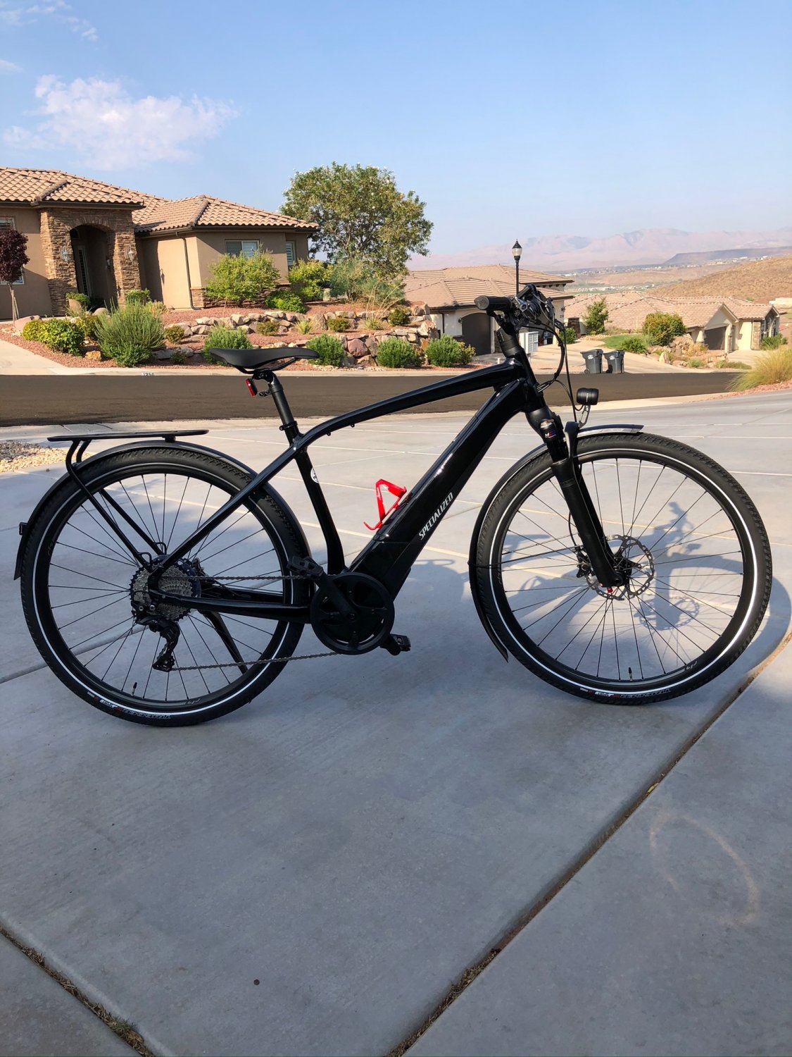

Just a quick question if anyone knows. I FINALLY got my Vado 5 delivered today. They say it’s a 2020.
My question is my headlight is attached to the fender, but I see most Vado 5s seem to be on the handlebars. Does anybody know why it’s one or the other?

Finally at home! Not even 1 mile yet. Have to wait until tomorrow morning to ride (already 90 degrees at 9:30). When they delivered it clock was set correctly and latest firmware was downloaded. They gave me a card suggesting 40lbs In the trigger tires. I’m 200lbs so I already put 60lbs in them. Sound reasonable?
