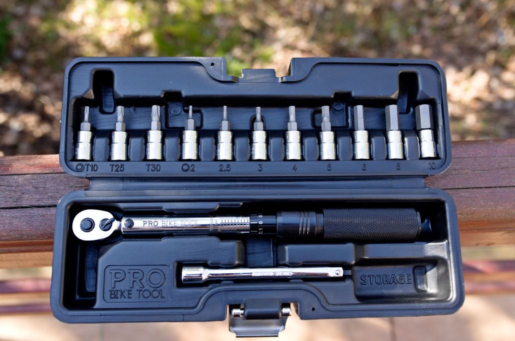

Thanks. I have ordered the tool set and as soon as I get it I will attempt to replace the tires.
...I ordered the same tool set... If good for Stefan then good for me.
I thought the same thing! :D
Then I remembered that I had a small torque wrench from Brownell's, used for gunsmithing jobs. Seems like it will fit the bill, and I don't have to pay for another one.
But now I will have to convert everything from newton-meters to inch-pounds. :(

I learned to love the torque wrench during the handlebars' swap. The stem and the brake/shifter levers required 6 Nm and other levers needed the 2 Nm torque. (The grips just need an Allen key and are fastened by feeling, same with the mirrors). The motor remote needs a T8 Torx wrench (I have got one in a form of a screwdriver). Incidentally, I was able to destroy the Knog Oi bell that requires minimum torque when fastening.... Arrrgh!
@Stefan Mikes I received the Pro Bike Tool yesterday. Seems like a quality product. I have checked the torque on various areas where I had just used my carry tool to tighten including the axles. All now meet the recommended Nm. Hope I am doing it correctly.
I have add d this tool set to the collection of bike STUFF that I have because I just like to have them and might not need them...haha
Thanks again for recommendation.
btw my son mentioned he has now ruined two carbon seat posts not using torque wrench. He wanted to adjust his carbon handlebar but was afraid to use the regular wrench based on his previous experience. The tool might come handy for him soon. 😄😄
My sons had the same experience in their early MTB racing 'careers'. Saved up their $ and added a torque wrench to the tool set I had gotten them.
BTW - torque settings are most accurate if the fastener threads have minimum friction when assembled. An anti-sieze lube or quality grease is fine for some (pedals,...). Blue threadlock works for others (brake rotors,...). Assembling dry fasteners is at the mercy of the thread friction. You won't know the real torque at the mechanical joint.
