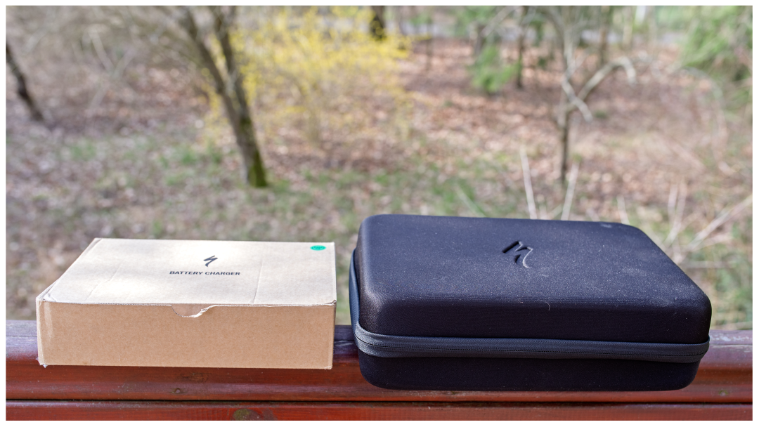

One company, one product, two different packaging :D
The cardboard box for the 4 A charger delivered with the Vado (left). The same product is delivered in an elegant nylon case when purchased separately.
If you order an extra charger, as I have, it comes in a box. The zip up case was a running change added to bikes part way through the year. It was intended to help riders keep paperwork, charger, etc organized in one place. The owners manuals are very basic. And really not much to the fork on a Vado in the way of adjustments. You can increase or decrease spring preload according to your weight and preferences. But really, on this bike and ones similar to it from other manufacturers...it's really a comfort item. It is definitely not high end suspension😂 Add a Thudbuster to your Vado or Como and you get cruising comfort.

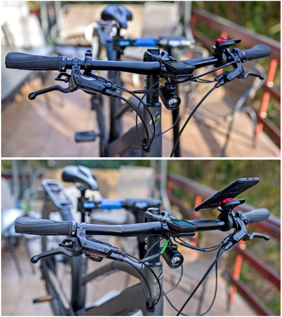

Today, I mounted the Baramind BAM Trek suspension handlebars on my Vado. After long 9 days of waiting, I got the shipment from France. Baramind BAM handlebars have composite inserts, making the handlebars reduce vibrations. It is very important to me as my Vado is equipped with a rigid fork.
The Vado already sports the PNW Coast Suspension Dropper Seatpost. That is another unique solution making my rides comfortable.
My other bike will soon get the Body Float Kinekt 2.1 suspension seatpost. Long way for the shipment from Bellingham WA 😊
Thank you @Alaskan for inspiration and advice regarding all these three items!

Looks great. I am sure it will also feel great.
you will also like tour Kinekt suspension seat post. I like mine a lot.

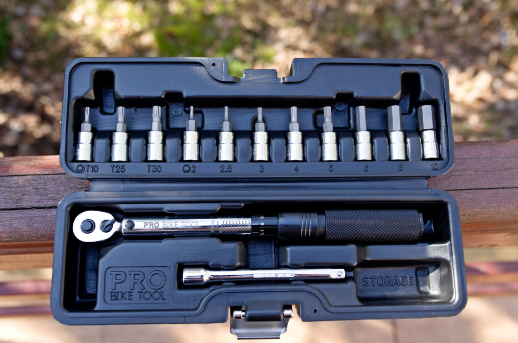

I learned to love the torque wrench during the handlebars' swap. The stem and the brake/shifter levers required 6 Nm and other levers needed the 2 Nm torque. (The grips just need an Allen key and are fastened by feeling, same with the mirrors). The motor remote needs a T8 Torx wrench (I have got one in a form of a screwdriver). Incidentally, I was able to destroy the Knog Oi bell that requires minimum torque when fastening.... Arrrgh!
Thanks @Stefan Mikes
I ordered the same tool set... If good for Stefan then good for me.
I found the torque measures in the manual.
