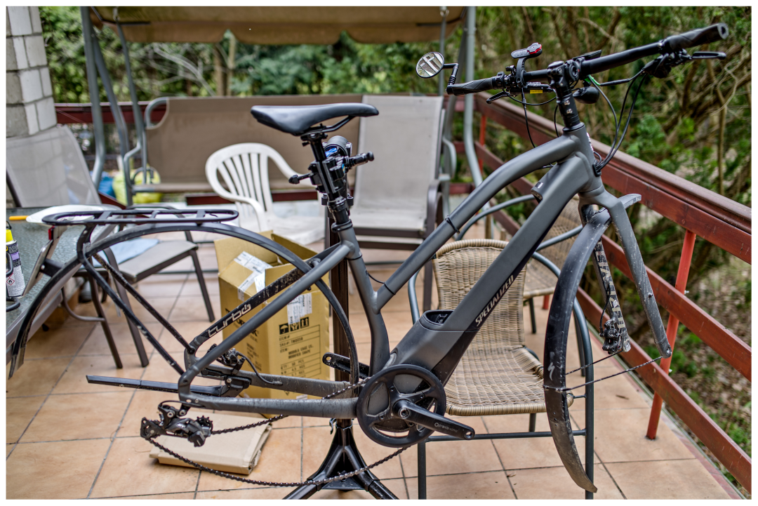

Post-Winter washing, lubing and replacing the inner tubes with Michelin Protek Max.
Specialized Electrak 2.0 Armadillo with Gripton component, when washed. The tyre is almost slick but the surface is soft and ensures fantastic road grip, even in the winter, even on wet surfaces and in wet dirt.
