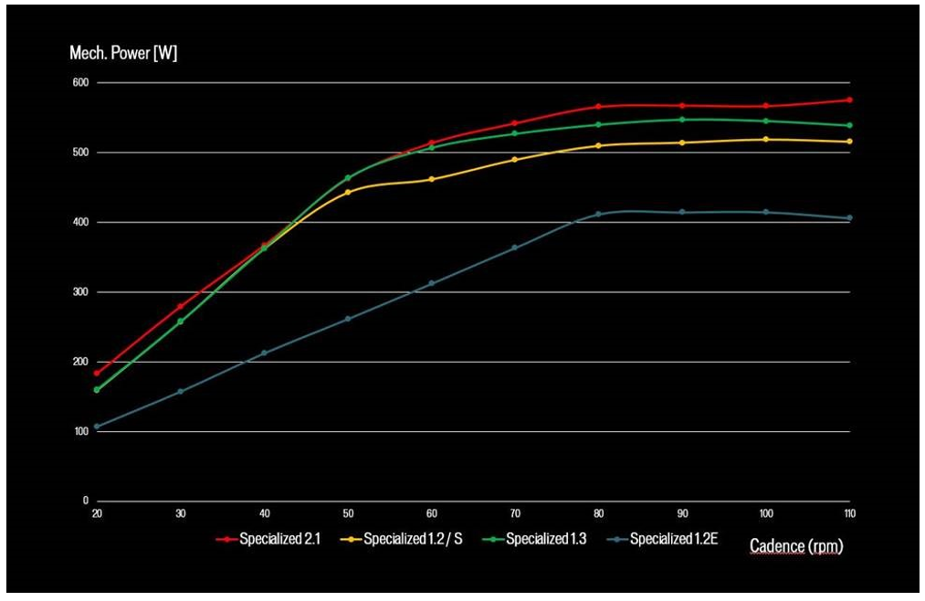

The motors are also different; the 3s have the 1.2e motor vs the 1.2 for the 4s. The 1.2e is said to be designed for more electrical efficiency, i.e. less watts per mile. This graph helps illustrate the differnce;
The 1.2e motor will use less power, but it also provides less power to the rider; 400+W peak vs 500+W, a big difference on a hill. The peak power for both motors is developed at a candence ~80rpm but the 1.2 motor starts out higher and ramps up its output more quickly passing the 1.2e peak output by the time the candence hits ~45rpm.
