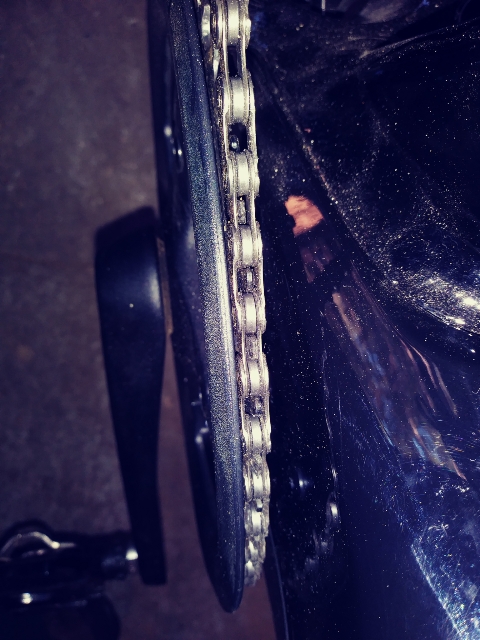

Ok @Sierratim you are the GOD of bikes. I removed the teeth so wide tooth is in wide slot. It seemed the problem and the sound went away. Went for a test ride. Now the chain drops when I change gear to the lowest. (Biggest cog).
Do you think the chain is too big?
I am a bit confused now after watching some pictures. Don’t know which is wide and which is narrow. I thought it refers to the tooth top but looks like there is wider and narrower base of the tooth. See picture with green ring. If that is correct then LBS has correctly installed.
From my experience, the wide tooth is centered, it goes in the narrow link, the narrow tooth is offset, it goes in the wide link.
When taking my chain off for cleaning when purchased new, if you get it wrong the chain will ride too high on the crank gear, don't force it on. My first experience with narrow/wide gear.

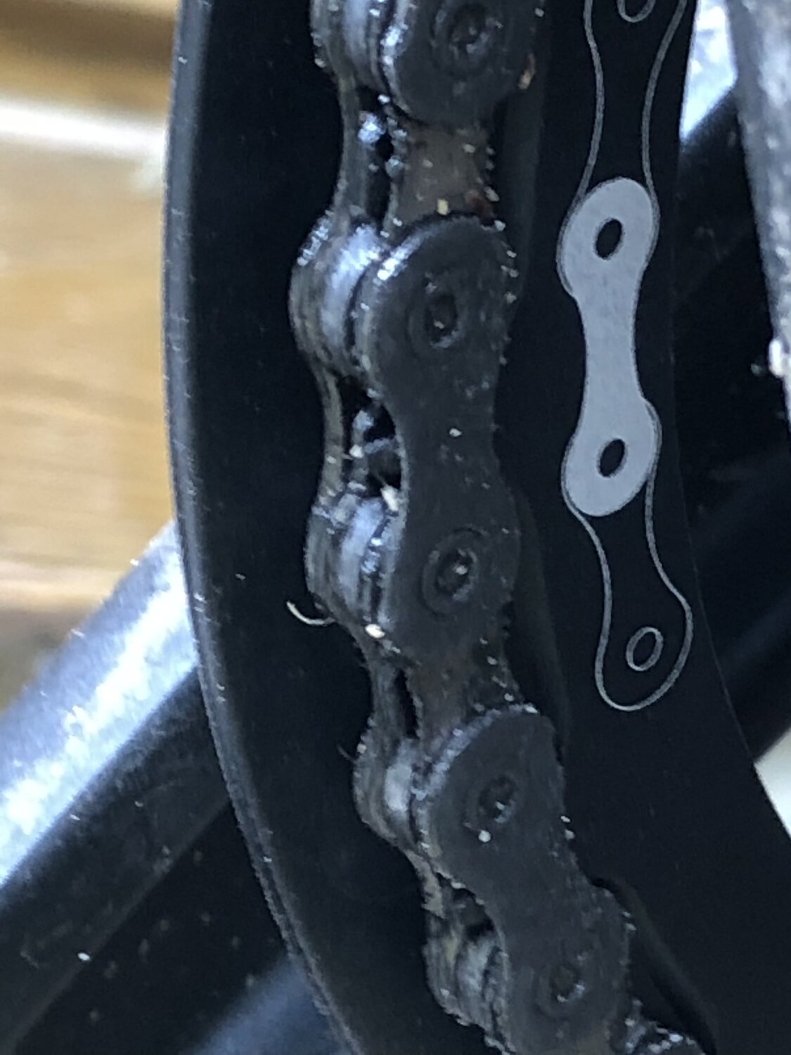

My Vado chain is still original. It was installed with the wide chain ring teeth in the wide chain slot, etc. The pic isn't the best, but I think you can make this out;
Is your chain matched to your drive train, i.e. an 11-spd chain on a 11-spd drive train?
That's funny. I was going to take a pic of mine also and it looks like yours, all the little dirt particles show up though to the naked eye it looks clean.
Mine is exactly as yours. Your wide tooth is in the narrow slot, the narrow tooth is in the wide slot. See how the narrow link is filled with the tooth, look at the wide link, there is a gap with the tooth to one side. You can see it in a couple links.
Loosen your rear derailleur and try to move the chain one tooth on the front gear, it won't ride correctly, that is going to be the ultimate test of whether it is mounted correctly.

Anybody in doubt still could take a look at the drawing that's on the inner side of the chainring and looks like this:
Just mount your chain exactly that way and you're done.

My pis is pretty fuzzy so just to be sure I just went out and looked at both our Vados. You are absolutely correct. The wide tooth is in the narrow slot, etc. My apologies.

Another feature I didn't know existed! Checked my bike, again. The installation matches this label with the narrow tooth in the wide chain slot.

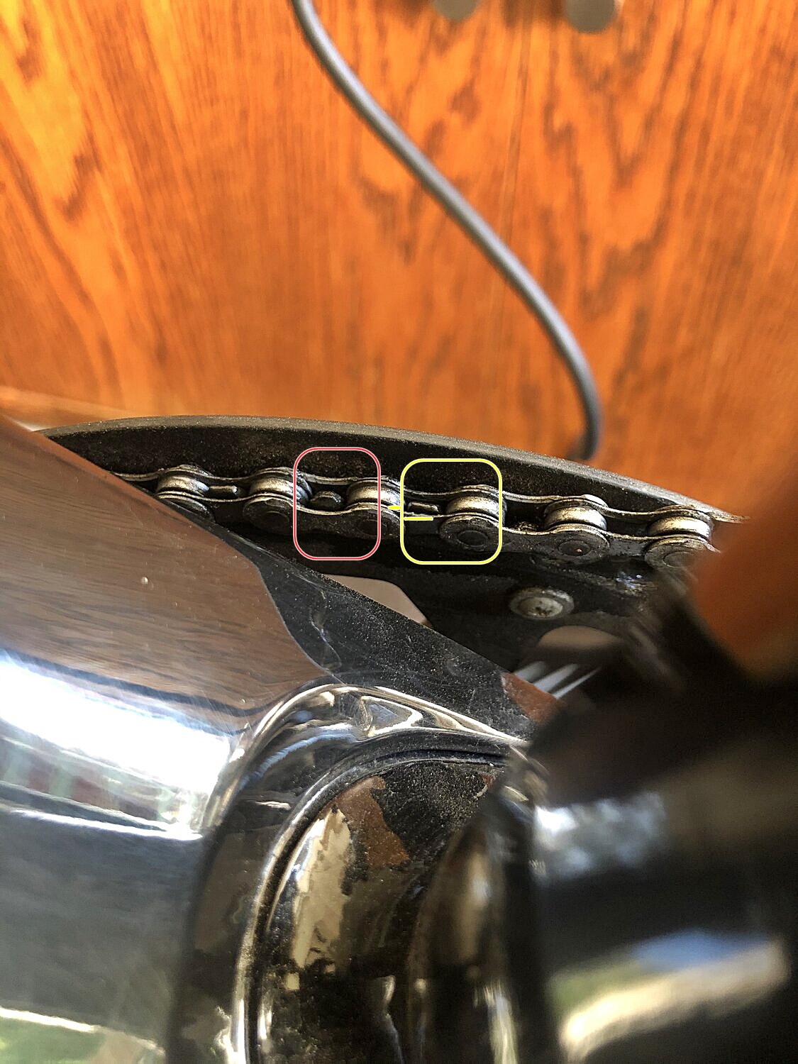

Narrow slot is on the wide tooth. Please see the pic.
Your pic shows exactly the opposite: your wide slot is on the wide tooth, and that is the correct mounting.
Please notice: "wide" or "narrow" tooth is to be seen from side to side and not in the chain line (as the chain runs)!
I have marked your narrow tooth with a yellow frame, and your wide tooth with a red frame:
So is this OK? I am confused?
If mounting is OK then I do have problem with the chain ring wearing out. Hence the sound.

I suggest using the graphic on the reverse of the chainring. This should eliminate the terminology confusion that seems to have crept into this thread.
Just did and it is mounted correctly.
I must have chain ring issue then.
here is a pic.
how does the chain ring look to you?
i get it now. Saw the graphic on the back of chain ring. Mounted correctly. Thanks to all for help.
