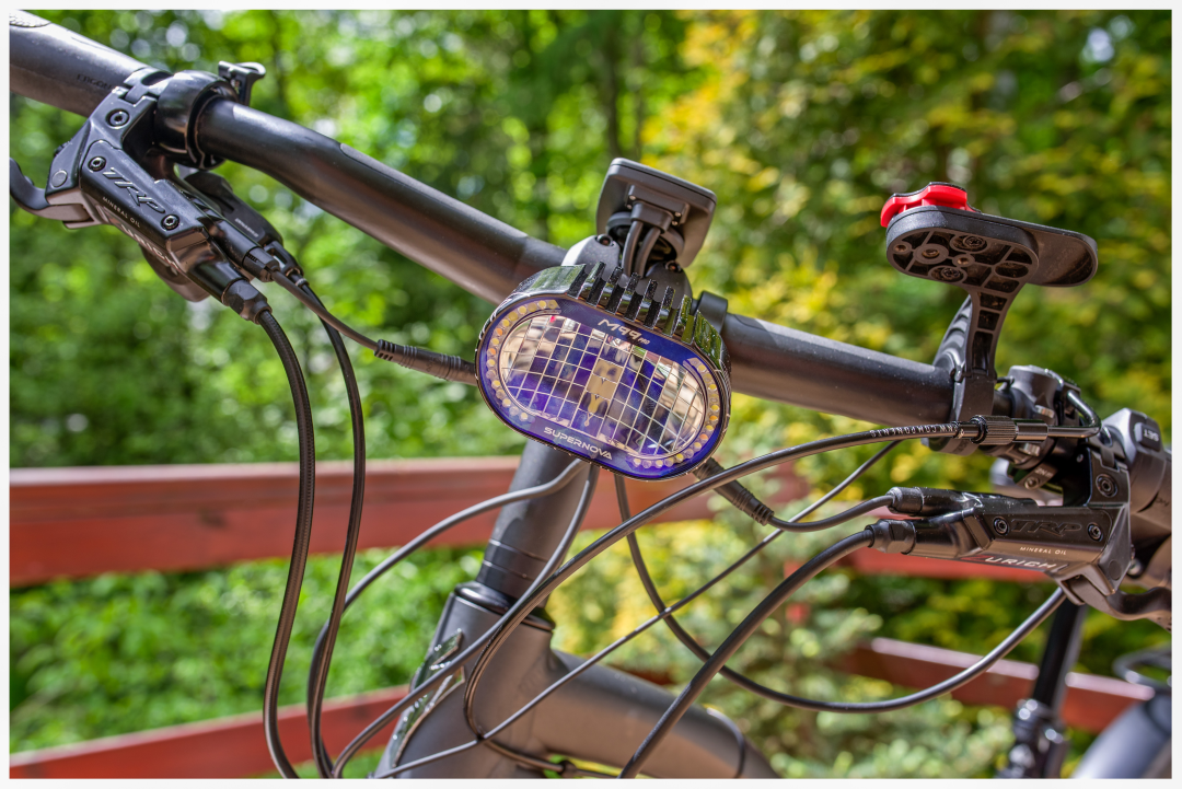

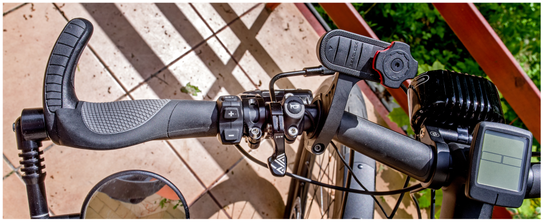

New remote, new horn button, new display. The long inwards lever is for my suspension dropper post. I had to cut the Ergon GP3 Small left grip a little to fit the smartphone mount on the shock-absorbing BAM Trek handlebar.
The automotive-grade Supernova M99 Pro headlight. Thank you, Specialized!

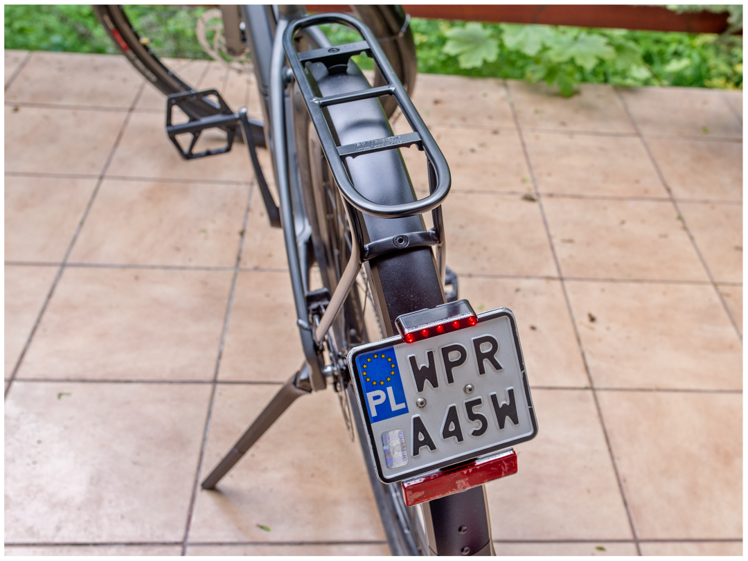

The registration plate/taillight/plate-illuminating LED/brake light/rear reflector combo is mounted on the mudguard now. As a consequence, Specialized replaced the rack, too.

With all the controls on the left side of the handle bar, does the bike tend to tilt left?...😉
Stefan, how well does your mirror work out in that position? The first time I saw it I thought maybe I'd change mine from it's more usual outboard-and-up position, but checking out the details it looked like it would be partially blocked by my body but definitely blocked by my hand or wrist and I'd have to always move them to take a look. Is this true for you? I prefer mine where I can check it often at a quick glance.
I tested a right hand Hafney mirror mounted on the left under the bar. I had a clear view of the mirror but found it took my eyes off the road to even glance at the mirror. It feels safer to glance at the mirror mounted above the bar.
You can have both options with a motorbike type end bar mirror. You simply reverse mount it. It's what Haibike did on some models 45km/h models. There's 1 screw to remove and you swivel it. Surprised more companies don't jump on the bandwagon. It's a really easy please-everyone solution. You can even swivel the mirror outwards if you want.
Some cycling grips, like Ergon, wouldn't be compatible with a bar end mirror, esp if you install their popular bar end extensions. Probably why cycling mirrors are often made with an arched L/R mounts to allow mounting at the inside edge of the grip rather than at the bar end.
Nice horn button, but where did they hide the horn?
The horn is in the motor chamber and the honk goes through the ventilation grille. I don't like the sound so I keep a bell too.
Not the best, works for me.
