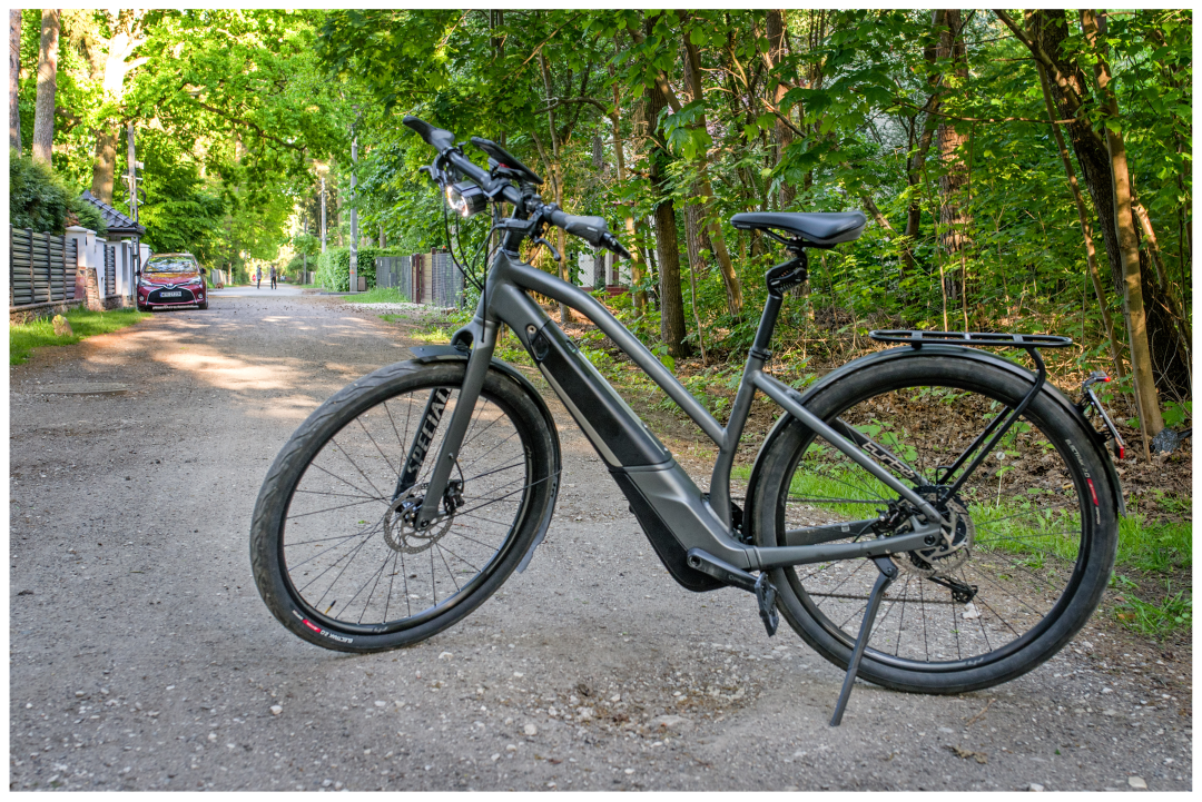

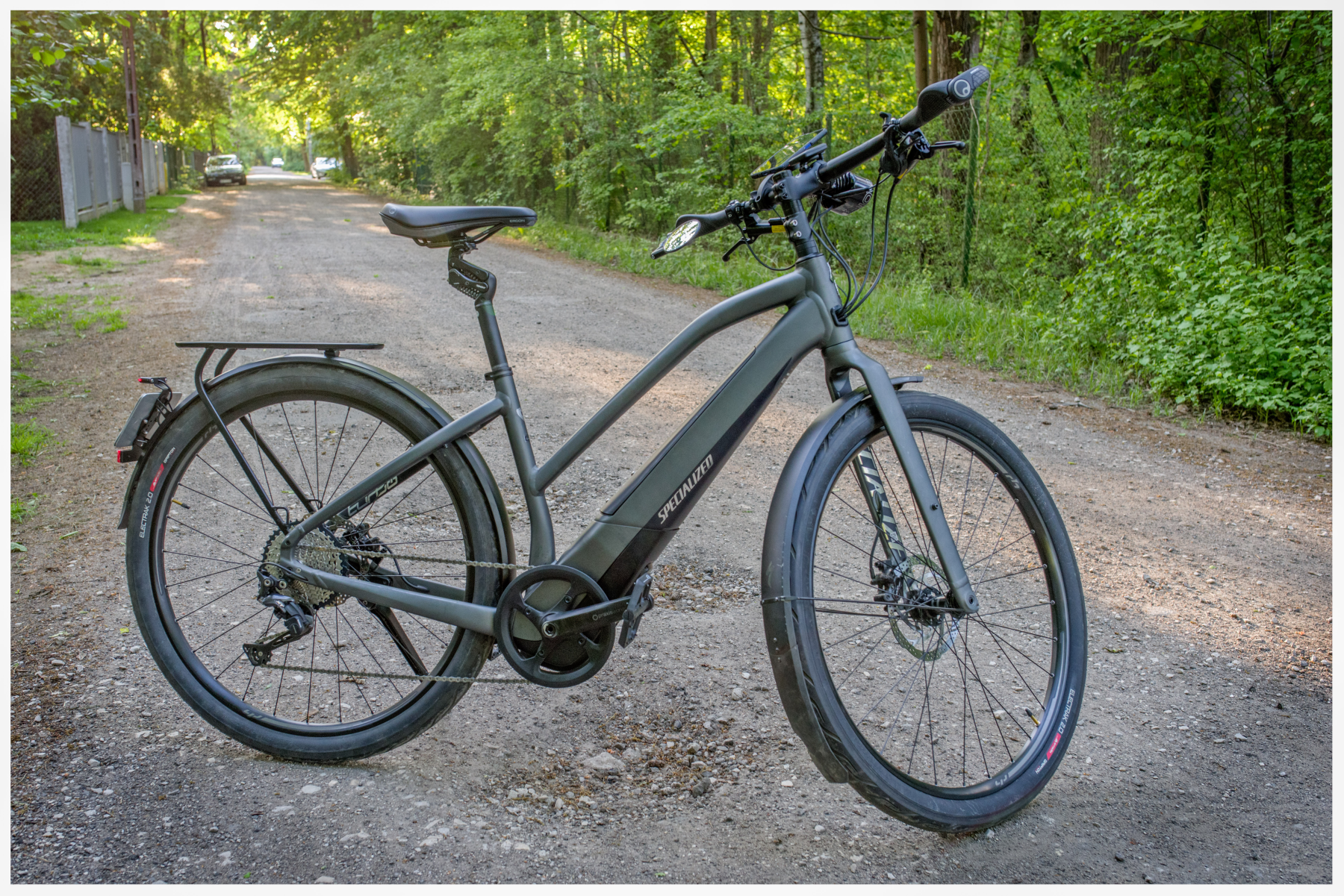

I woke up in the middle of the night (it happens to me) so I can write something of interest to you, fellow riders of the Vado.
Sometimes, my Vado produces strange noise on the ride. As the bike has been completely silent so far, I took a closer look at the bike post-ride. It turned out the long front mudflap has deflected during the transport in the car, caught the front tyre and started rubbing it. Part of the flap was already "eaten" by friction, oh, the poor tyre... I have straightened the flap out with my hand but that might happen again... Ouch.
