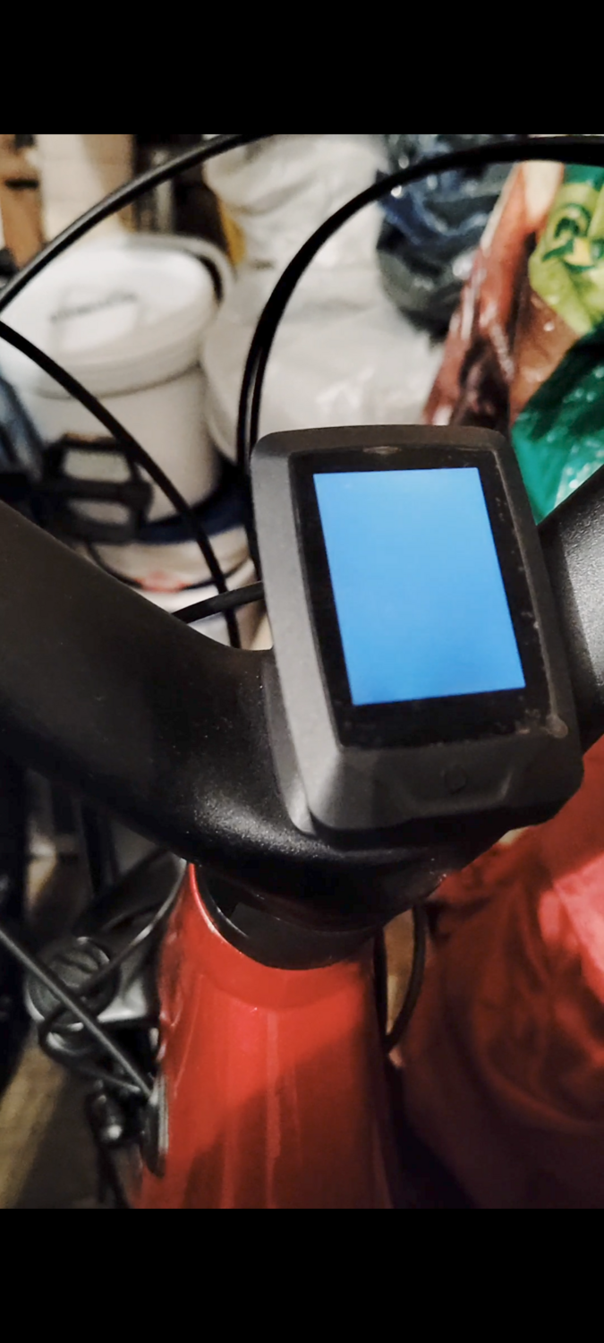

Hi guys. I found a problem similar to my Como 4.0 igh. is the second time that I use it already no longer turns on. I uploaded the battery into the home and after i installed to the bike, this is not turns on from the mastermind. zero all dead. And yes, I transported the bike on my car saturday. If anyone can help me please. Thanks and sorry for my poor English.
I tried ! The battery is full. Nothing! This is the result:

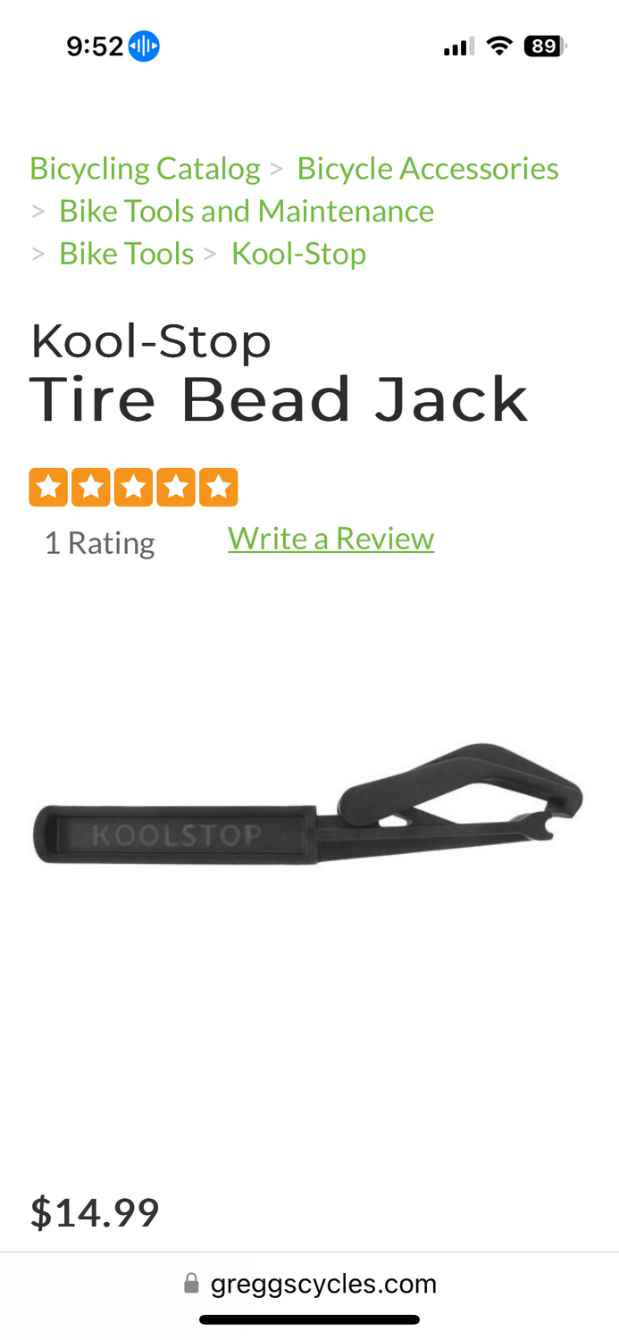

The rear wheel on my Vado 6.0 got a flat with no apparent reason (the e-bike not ridden when that happened). I spent almost two hours to replace the inner tube and the tyre! Cannot comprehend how come it has been 139 years since inventing the bicycle and yet no-one invented a simple way and appropriate tools to remove the tyre from the rim and then pulling the bead back onto the rim!
Good inner tubes have a removable valve core. When my wheel was ready, I removed the valve core and poured a good amount of sealant into the inner tube. Let us see how it works!
A morning of frustration.
This makes installation a lot easier! On my last install I did have to pinch the tire with a small C clamp ahead of the tire jack to keep it from coming out of the channel.
