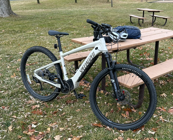

Replaced the fork on my Tero 3.0. The Suntour fork had a straight steerer to taper crown race adapter on it, so I just needed an FSA crown race not a whole headset. I got a Fox 34 float AWL, which is similar to the Marzocchi Bomber Z2 but with ebike fender mounts and such. Fox seems to be clearancing it as I got mine 35% off, but now I see it's 40% off.
The 100mm fork has similar length as the 110mm Suntour. It is for a boost front axle though, so 15x110 instead of 15x100. That can either be solved by an adapter kit for the centerlock rotor with some spacers... or buying a new wheel. I was able to find a new wheel so I went that route.
I think the reason this Fork was on clearance is because of the 51mm offset. Apparently 51mm was common say 3-4 years ago, but the industry is moving towards shorter offsets closer to 42mm. The oem fork was 46mm which was in the middle. I watched a variety of videos and read articles trying to understand if it would matter. In the end I actually think I like the 51mm as it makes the bike a bit more nimble and easier to turn.
I also really considered just going with the Recon, as it's available for the 15x100 axle, and I think the 120mm travel would have had about the right length. That would have been a cheaper option as I wouldn't be messing with a new wheel. That's what came on the Tero 5.0. Although to get the fender mounts you need the boost version. So back where we started, which is why I went this route.
