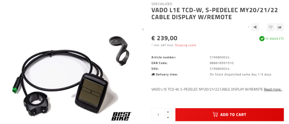

The base of my Vado 6.0 display got damaged a long time ago. As my Vado 5.0/6.0 (a 45 km/h Euro S-Pedelec) had the Garmin display mount integrated with the original stem, a makeshift solution involving silicone glue was found and it lasted until I bravely got rid of the original stem in favour of a 120 mm Specialized Comp Multi Stem. Now, I had to install the display onto an external Garmin out-front handlebar mount... not really doable because of the damaged display base! (Temporarily attached with a lot of strong adhesive tape).
The things did not look good for the future. In fact, the Vado 6.0 display is a dongle, enabling the Vado 6.0 system (no display, no e-bike) because the Euro S-Pedelec must be equipped with an operable speedometer! So I wrote Specialized Warsaw...
'Please send me the WSBC serial number of your Vado', which I did to get that answer, 'Unfortunately, the part S176800007 is not produced anymore'.
I had other things to do. After a couple of days, I googled the S176800007... It was the old BLOKS display, really discontinued! I could not understand the situation! Specialized Warsaw have been totally competent until now! I started the research myself to find...
The part number was S196800024!
I wrote an angry e-mail to the LBS. In five minutes my phone rang...
'Good afternoon Mr Stefan, it's Kamil of Specialized Warsaw. I apologize for the confusion. The e-mails are handled by my colleague, and I looked into our e-mail incidentally. Of course, my colleague was wrong! The part is indeed available, and the list price is EUR239. Shall I order it for you?' That's the spirit! The salesman knows me and he is aware I am a loyal paying customer; he is competent and helpful. I should have given him a phone call in the first place! I expect a customary discount, which I will use to pay for the labour of replacing the display.
All went well. It only proves you can find incompetent/lazy people anywhere but there are still people you can trust! :)

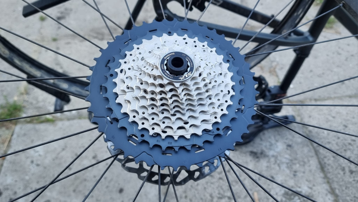

Ooh-oh. As I lost the track of the chain maintenance on my Vado 6.0 during its transition from 45 km/h Vado 5.0, it has turned out the five smallest sprockets on the cassette got worn. I decided to replace the entire 11-46T, 11-speed cassette.
The replacement has been successful, and now the shifting has become crisp, and my rides butter smooth :) I had some doubt about the status of the 42T Garbaruk chainring (7500 km ridden on it). No worries, it is a premium component! However, I decided I could be better off with replacing that ring with a 44T one (also Garbaruk). That would shift the chain towards the larger sprockets, causing less wear on the cassette. I hope I would not need to replace the chain, as there has to be some tolerance in the derailleur (the bigger chainring would technically need two more chain links). The range on the cassette is as huge as I do not actually utilise the biggest cassette sprockets on my rides!
Once replaced, the existing 42T chainring will serve as a spare for my Vado SL.
What a beautiful cassette, isn't it.

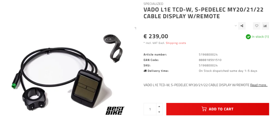

The L1E TCD-w Replacement Dilemma

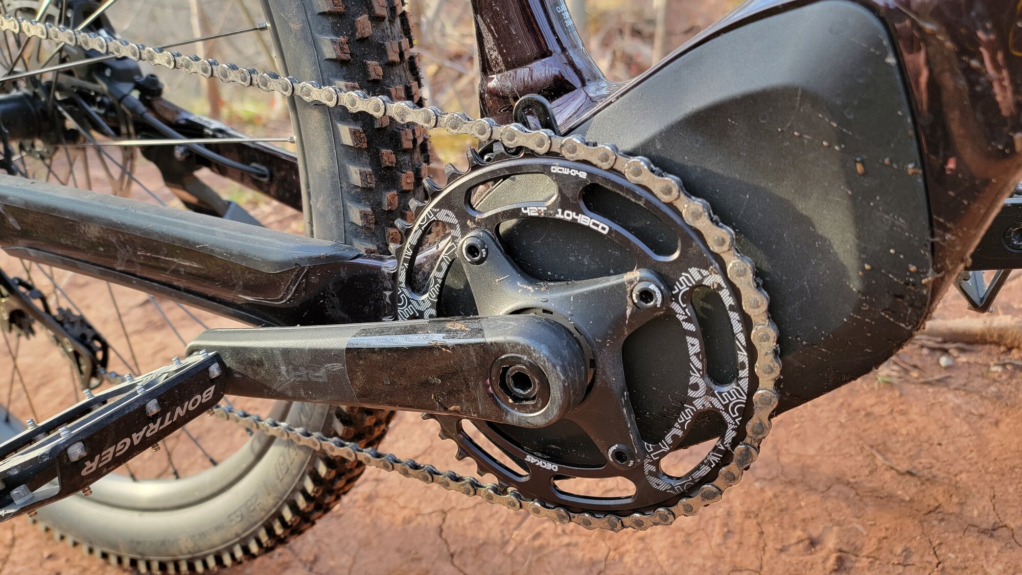

Replacing The Chainring
The beauty of Praxis chainrings is these are fastened to the spider by screws (not bolts), and they allow a matching chainguard. However, I prefer the freedom of choice for selecting chainrings, and as Praxis rings are very hard to buy, I standardized on Garbaruk chainrings, which are readily available here (it is an Ukrainian product made in Poland anyway!)
I checked the 42T 104 BCD Garbaruk chainring after 7500 km ridden: no noticeable wear! I, however, decided to go with a new 44T ring now. There are two schools related to chainrings:
  • Use a smaller one, do not replace the chain often, and then occasionally replace 4 or 5 worn smallest cassette sprockets together with the chain, or
  • Use a bigger chainring, replace the chain as soon it has exceeded the 0.5% stretch mark, and enjoy your cassette for a longer time
Now, I'm going with the larger chainring, as the process of looking for small replacement cogs is a mission nowadays!
Going to alternative to Praxis requires you to resign from using the chainguard, and using standard 8 mm MTB chainring bolts. What is difficult with mid-drive motors is the fact they leave almost no clearance between the chainring and the motor! I had to remove the motor cover (it has been my third voluntary chainring replacement: to 38T, to 42T, and to 44T), and find the way to keep the bolt nut in place while tightening.
I have found these MTB chainring bolts in steel the best in the market. Even if they theoretically require the Park Tool CNW-2 wrench for keeping the nut in place during the fastening, the RocRide steel bolts have the property that actually does not need any wrench for the bolt tightening! (I also used Loctite Blue for thread-locking). The fastening torque is 5 Nm but the steel bolts are very tolerant! (Aluminium ones are delicate, compared).

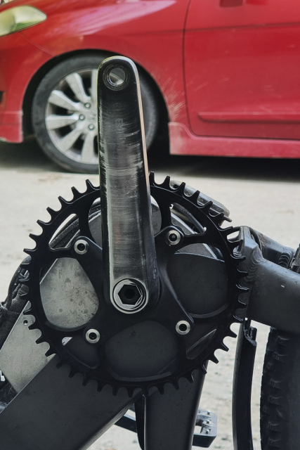

When I changed the chain ring to a 42, I went with a Deckas. They are on Amazon for $25. It comes with new bolts. They have a lot of good reviews.
It was a very simple swap... maybe 15 minutes. I did not need to lengthen my chain. I did need to remove the chain guide, but never had an issue of the chain coming off thanks to the narrow-wide teeth on the new chain ring (make sure to slot your chain links on the correct narrow or wide teeth).
