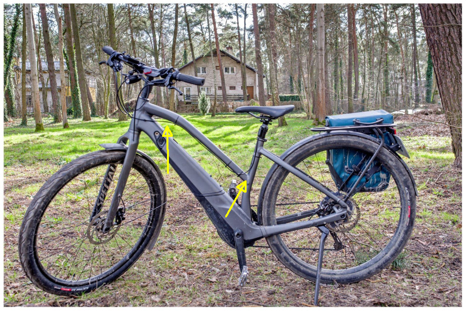

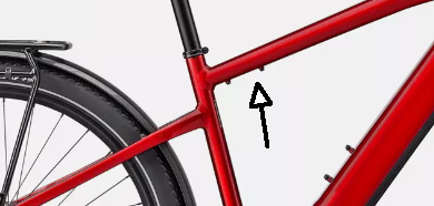

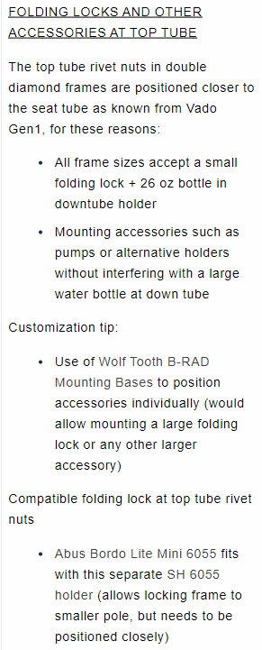

It's probably for a water bottle cage. (There a lot of different Turbo Vado years and models so don't forget to add the details.)This feels like a dumb question, but what are the screws on the underside of the Turbo Vado top tube for?
Well? (The current model).It's probably for a water bottle cage.
When I got that pump and looked at the mount I thought there was something familiar about the spacing and size of the mounting holes.Thank you Rich for the idea! I though those bosses were perhaps for mounting a small triangle frame bag
My experienced riding buddy says the small pump is the only item fitting that place as the frame bag located there would chafe the rider's thighs.When I got that pump and looked at the mount I thought there was something familiar about the spacing and size of the mounting holes.

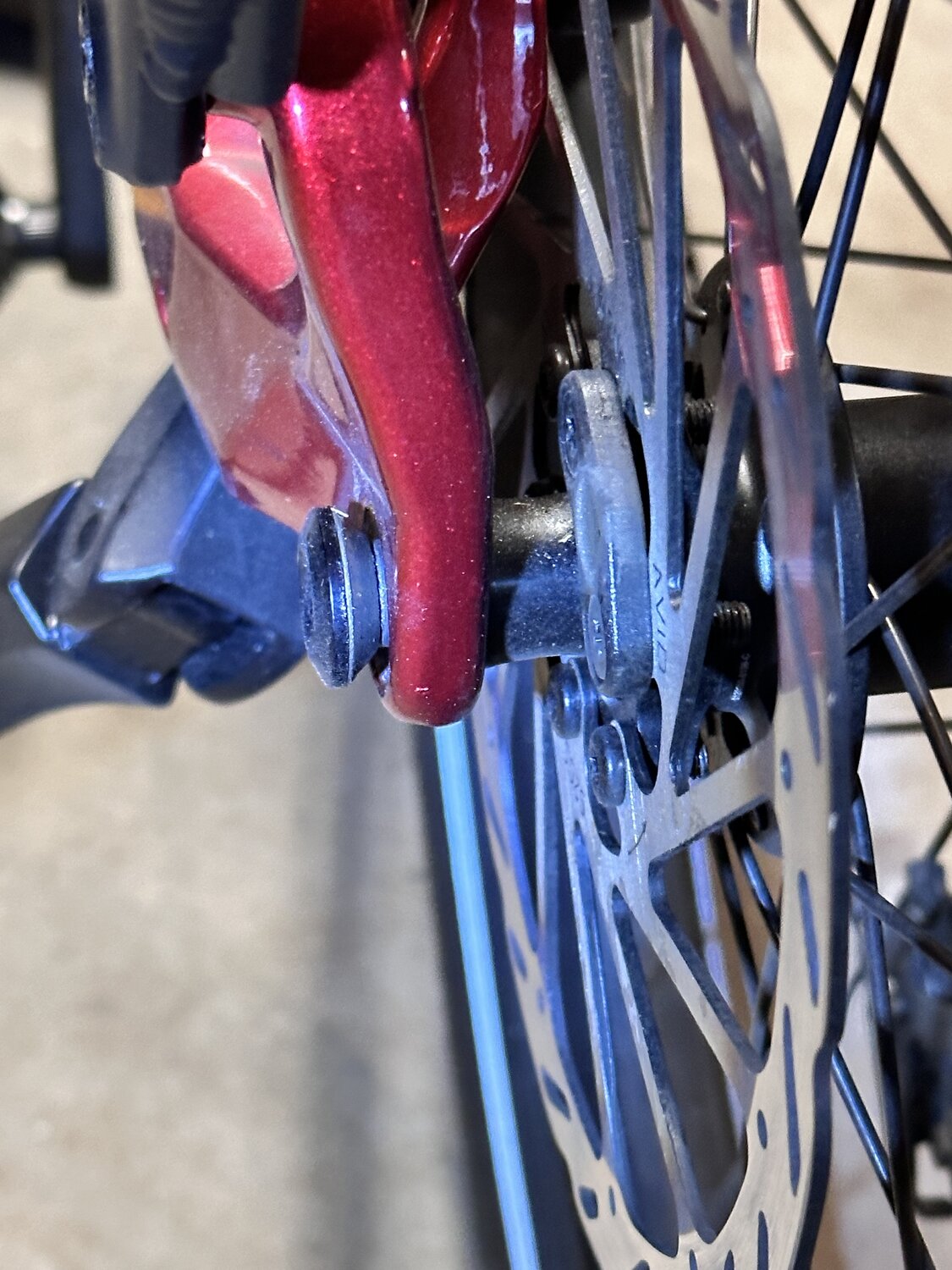

It only happened to me once, after I forgot to re-torque the axle after the wheel removal the night before.Watch those thru-axles…
