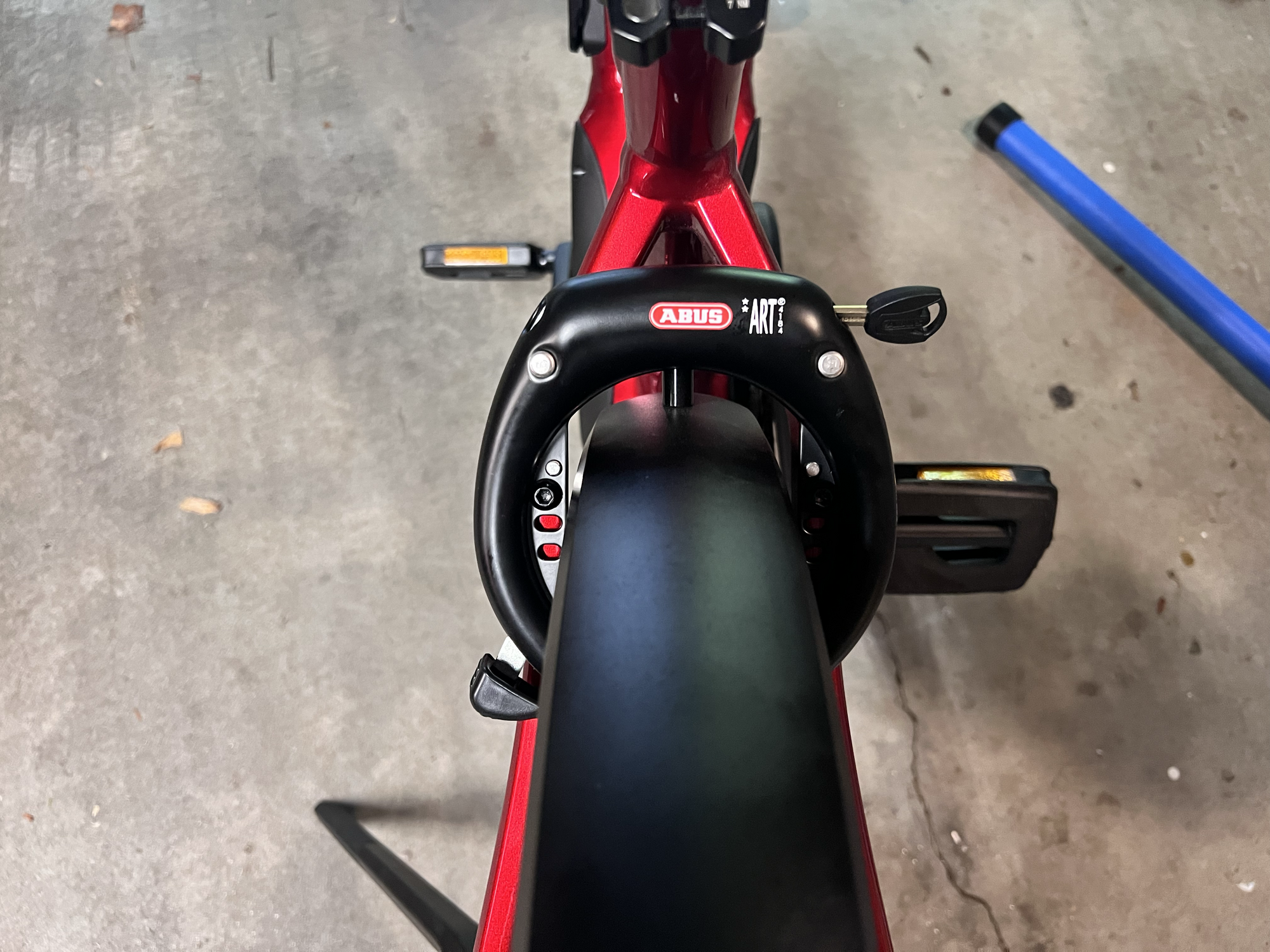

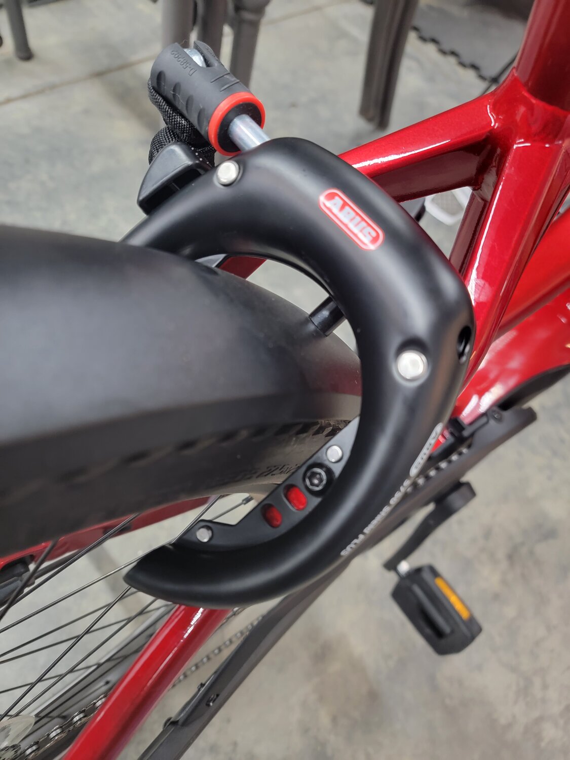

Abus 5755L key-retaining. Essentially the 5750 mentioned by Specialized but in the XPlus key vs the Plus key.

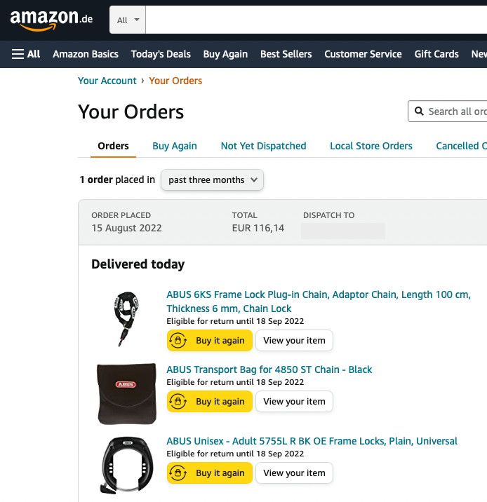

Ended up ordering from Amazon.de and received it in the US in under a week.
This *just* fits, there's approx 1mm clearance to the inside of the rim. Had to drop the rear wheel to install it, but didn't need to remove the fender.

Are you using both bolt holes without modification? I ordered a 5750L because that was all I could find, but it won't line up with both holes. I do love the 100mm chain with it, it just barely fits my 22' 4.0. I can fit one of the holes, but I love the cafe lock concept. Thanks!
It was close, but my 5755L fit my size M 2022 Vado 4.0 mounts with no modifications. I ordered from Amazon.de for delivery to US via DHL because I wanted the key retaining version.
I gave it a whirl tonight. I can confirm the 5750L also fits the 22 Vado 4.0 perfectly with no modifications needed to the lock. I was thinking the screw head might have been too wide, but it was just right.

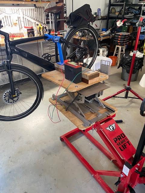

Here's what I did. Ordered the park tools bench mount bike repair stand, then decided that only solved part of the problem. The chair lift came out of a handicap van and had it on craigslist for $100 just to get rid of it and no bites so thought hey, part of the problem solved right there. It rotates, forward/reverse, and lifts. But it wasn't quite enough, then decided on the atv lift which was cost the most but it can have multiple purposes. The whole thing is kind of an investment in the future. The como step thru is the hardest to mount in a stand because the seatpost has to be used and with all the attachments has a bit of weight. I think this will solve that problem somewhat.

The park tool had the female threads on the jaw cross threaded, like not centered then another set of threads over the top of them, made the mating of the two pieces kind of trial and error. I notified them and like the great company they are they are sending a replacement.
