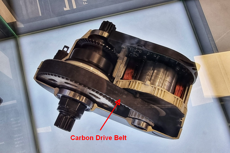

Firstly, it turned out the carbon drive belt inside the Specialized 1.2s motor broke (the e-bike was out-of-warranty). Next, the Spec people discovered a frame crack around the motor area (a known design flaw for that e-bike series). The frame was on a lifetime warranty as I:
