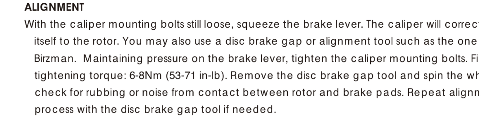

Some hydraulic disk brakes can be centered by loosening the caliper bolt, squeezing the brake lever and re-tightening the bolt. High end brakes such as TRP Zurich are totally fixed. As the matching wheel must come on a thru-axle, the central position of the rotor between the pads is guaranteed.
Why reinvent the wheel? Bikes are not cars.

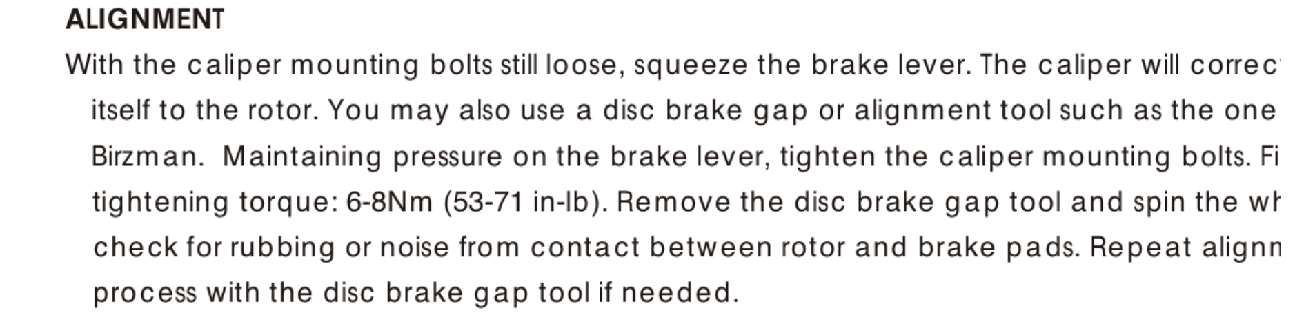

not exactly guaranteed…. different cassette and freehub configurations along with different amounts of torque on the through axle can absolutely move the rotor. rotor thickness and alignment also varies slightly brand to brand and of course, over time. if you have two wheelsets on a disk brake bike, you’ll see each time you change them that the alignment is slightly different. loosening the caliper fixing bolts, braking, and then tightening the bolts while braking as you note usually does the trick. the tolerances on these brakes are tiny, very different from cars.
all my brakes, from cheap no name on the vanmoof to mt200 on the sirrus, shimano GRX on the creo and the latest shimano dura-ace on the aethos have occasionally required this adjustment. then again, we have HILLS here!

what do you mean by not adjustable? they look like they have the same two enlarged holes that any other caliper does, and their manuals reference the exact same procedure that you mentioned above.

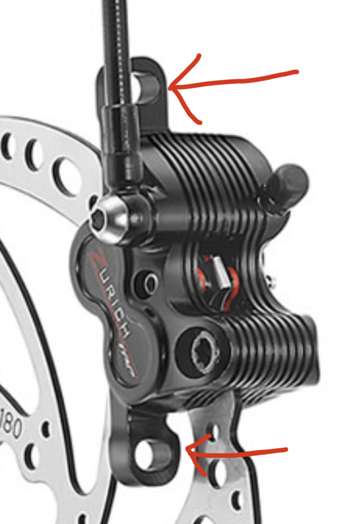

The TRP Zurich brake is mounted to the frame by two bolts, making it effectively fixed. I can take a picture in the morning my time.
I could never find any bolt to loosen there, and I never needed adjusting the calipers in 2 1/2 years even if I replaced the pads for several times.
Please show me where these "two big holes" are. I simply don't get it!
TRP Zurich are one of very few bike brakes Type Approved for Euro S-Pedelec, a moped.

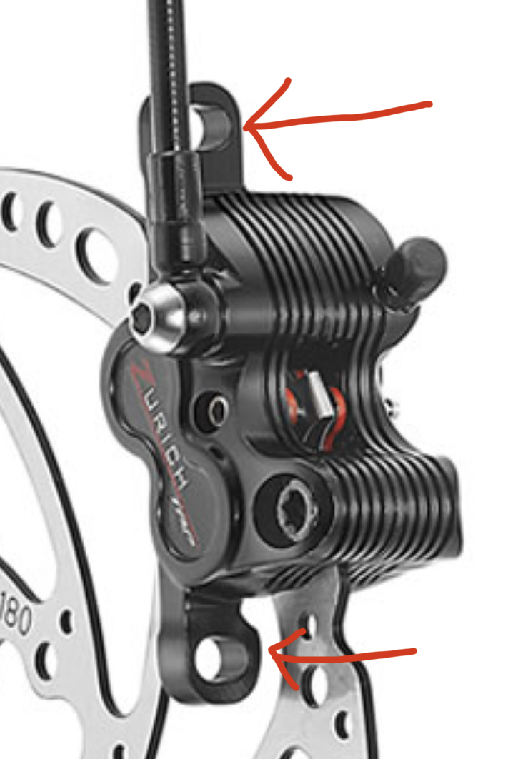

strange, the manuals i saw show two unthreaded holes just the same as a shimano or sram caliper. the holes are larger than the bolt by a few MM. but i’m sure they make many types of brakes. maybe they have a much larger throw than typical bike brakes, which would allow the pads to be further apart when not braking? the latest shimano brakes have slightly larger clearance to reduce rubbing when not perfectly aligned.
these holes are larger than the bolts, the same as most calipers i’ve mounted/adjusted:
Mark,
These holes hold two stout bolts that are firmly screwed to the frame. That makes these callipers totally rigid. As the wheel with the rotor is mounted by a thru-axle, the rotor is always perfectly centred between the callipers. That's why I have never needed to adjust them...

yes - of course when in use the bolts are rigid! but the caliper is adjusted by loosening them and moving it a bit. all my bikes are through axle and it’s definitely not exactly in the same position, even just through replacing an old rotor with a new one, for example.
maybe we’re talking about different things. i’m not
referring to an automotive style floating caliper, only the normal amount of adjustment in the caliper position.
Do you mean the holes in the calliper are so big loosening the bolts would make the caliper move? If yes, thank you very much for the education, Mark!
right, the hole is perhaps 2mm larger than the shaft of the bolt. this is why loosening it and then braking centers it on the rotor, because it has freedom to move when you do so. then you tighten the bolts and it stays in that position, hopefully still centered on the rotor 😂

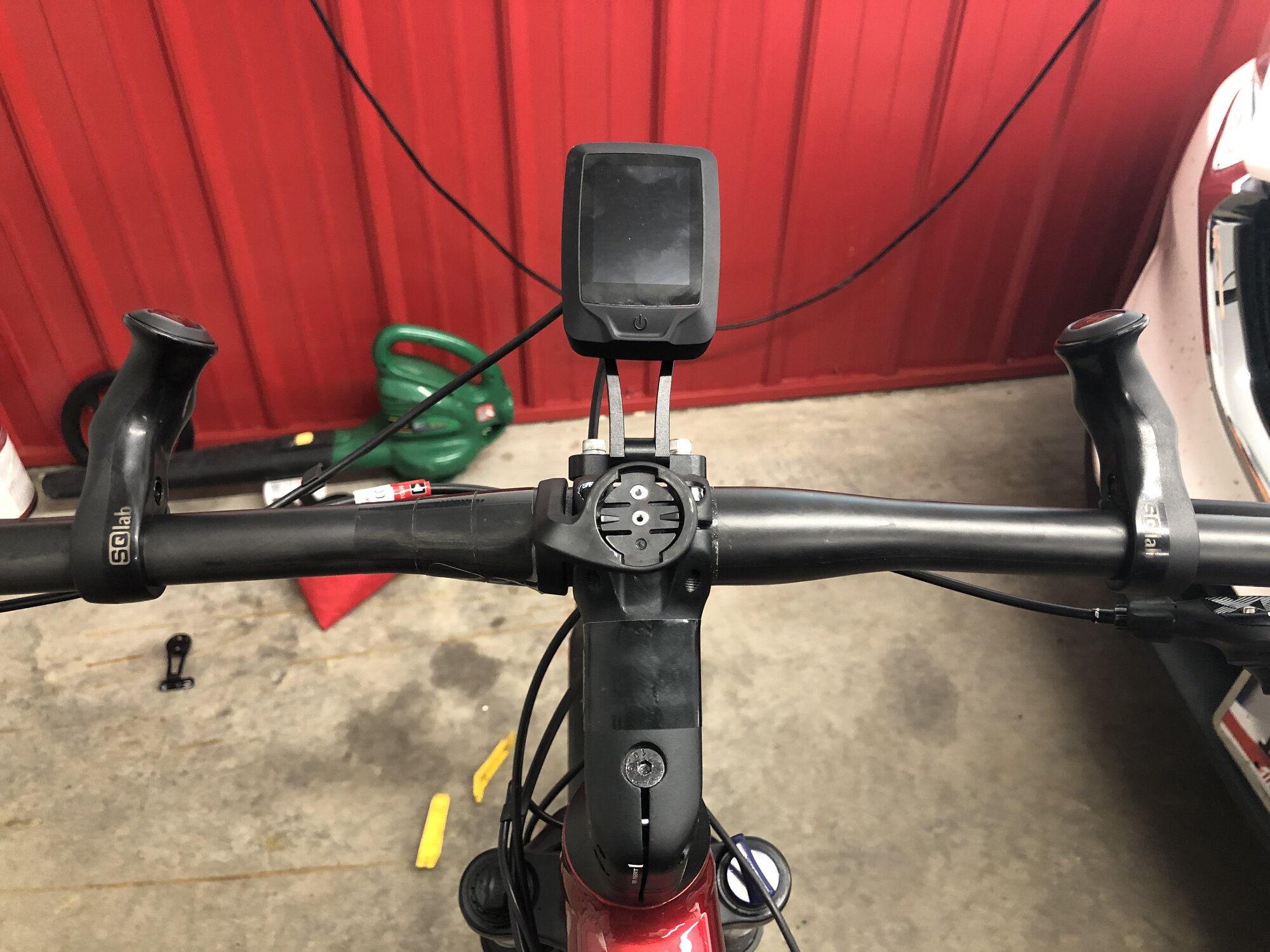

Continuing the fine-tuning of my Vado’s cockpit….
Installed a set of SQlab 411 inner barends.
Next project I think will be installing a RockShox Reba air fork to get away from the SunTour Mobile A32- someone’s cruel joke to simulate ‘suspension’. 😂
Honestly, I’d even consider a rigid carbon fork and use a Redshift suspension stem, as I’ve enjoyed the results of that stem on other analog bikes, but I can’t find a carbon fork with a similar axle-to-crown height…the Reba in 80 or 100mm is pretty close so that’s my reasoning there.
It’d be so boring without the accessorizing process, no? 🙂

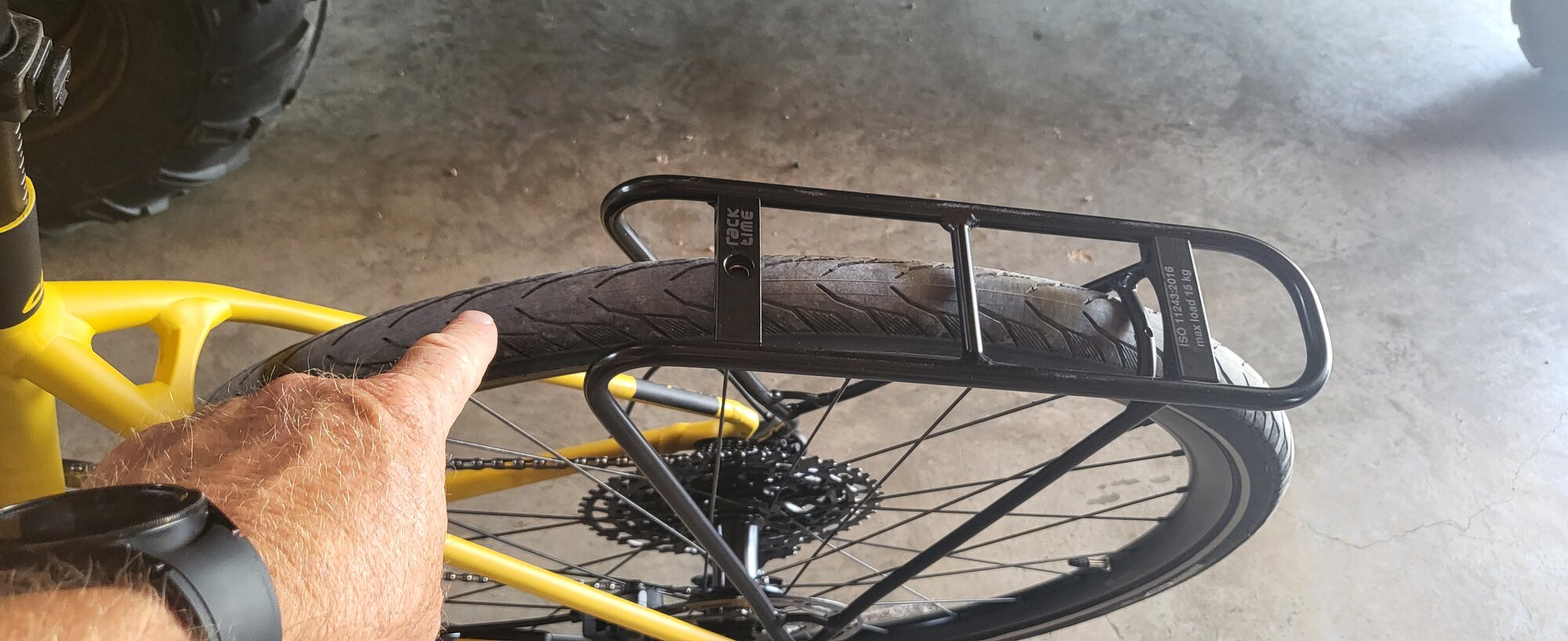

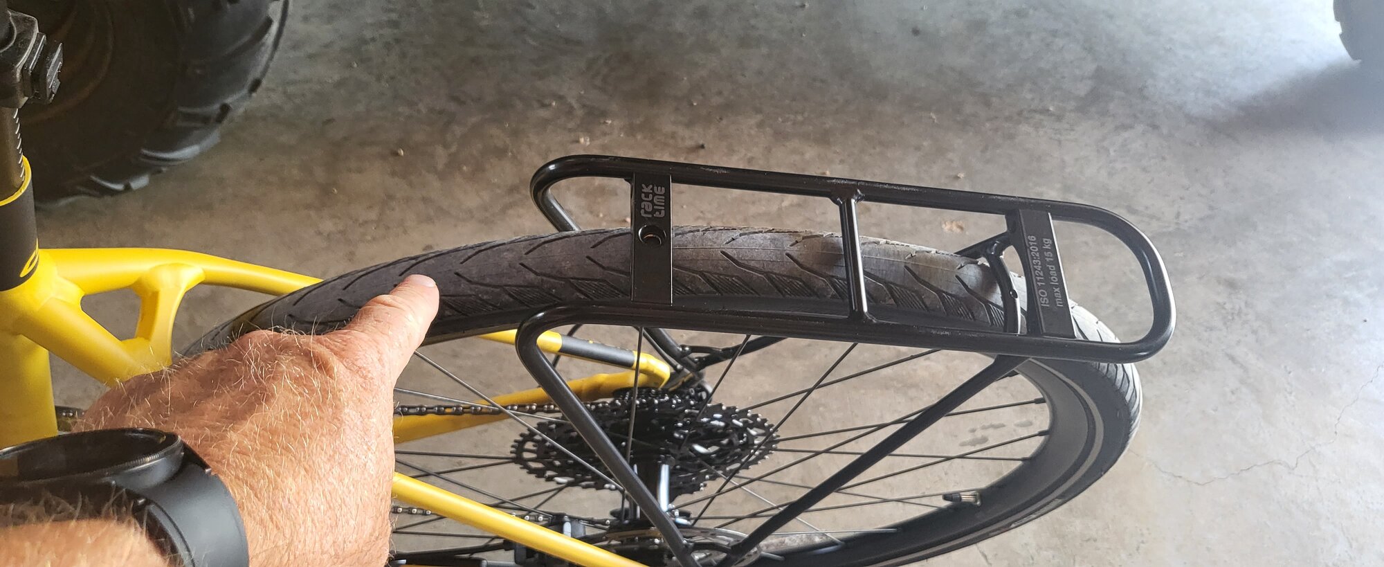

I removed my rear fender off my Vado SL EQ which supports the rear rack. Does anyone know where I can get a support that will hold the front of the rack to the frame area behind the seat post?
Is there a bolt screw hole on the bottom of the seat stay bridge? My Creo has one there where my rack is attached.
