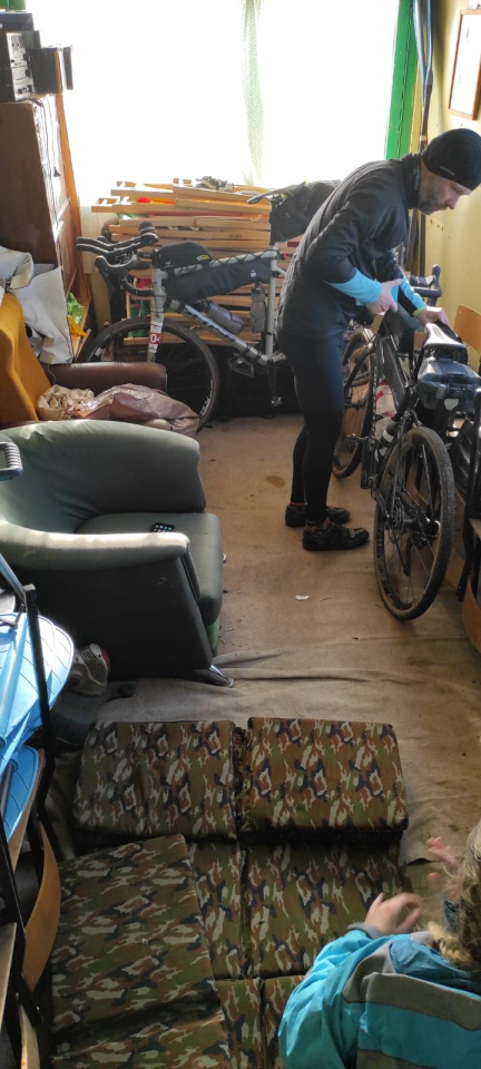

A photo from a short overnight stay, a 553 km gravel ultramarathon in Poland. A couple of riders were allowed to occupy a shed by River Vistula. They slept for two hours, 4 to 6 a.m, then they continued riding...
The guy by a Specialized Diverge is my friend Staszek.
