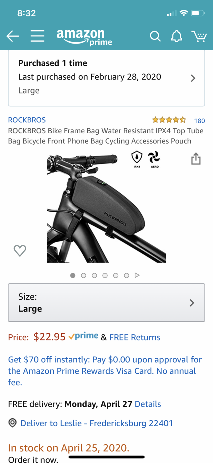

what bag is on your top tube? Very compact. Send more pics please.

Thanks trying to remember the bag On the top tube. Amazon I think.
I considered a top tube bag much like this one but felt it was going to be too long, i.e. there wouldn't be enough room for me when I slid off the saddle. I went with more of a pouch by Dakine, their Hot Lap Gripper Frame Bag. It measurers ~4.5 inches long with plenty of room for a large inner tube, tire levers, CO2, etc.
