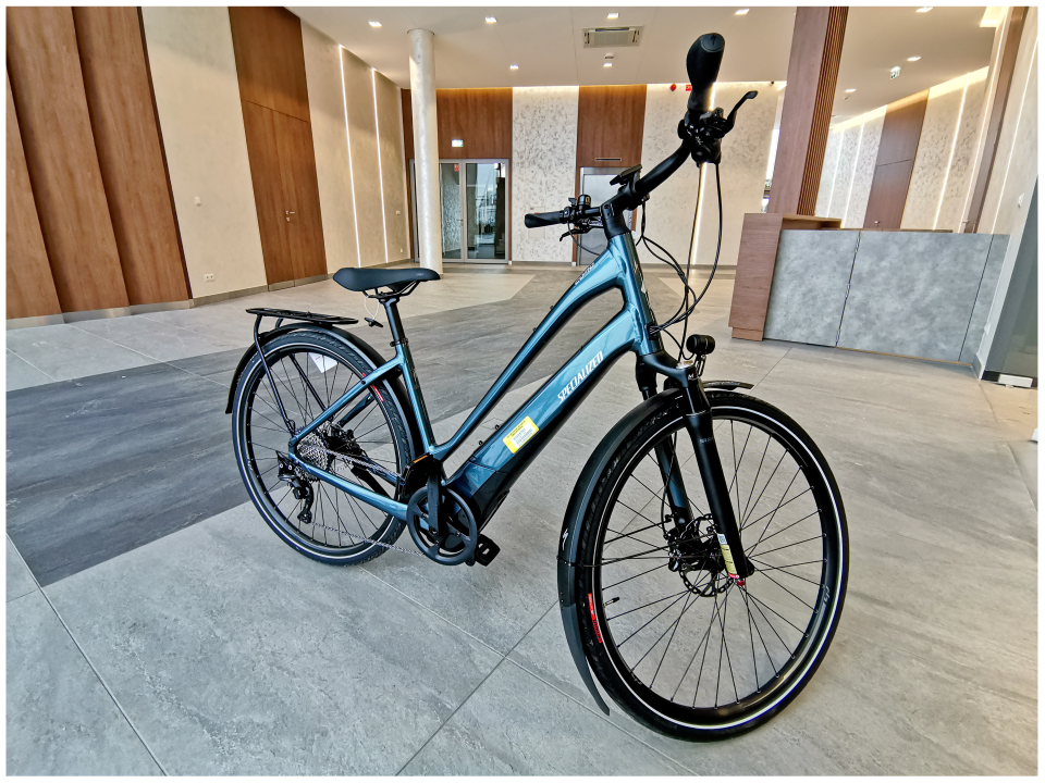

My friend Anita has just bought Turbo Como 5.0 at Specialized Warsaw :) A brand new e-bike, never ridden before! US$5050 discounted price after tax.
The EU version with 700C wheels and suspension fork. I'm so happy! When the Spring comes, we would be riding together!
I tried a Vado SL 4.0 EQ inside. A marvel e-bike! WANT!!!
Holy cow $5500 US??? Wow They were $4300 here . Or is this different somehow ?
Nice looking bike. Only thing I don't like about my step thru is when you are standing up and usually with a cross bar you can hold the bike between the legs, without the cross bar it wants to fall over. But that only happens a few times:). It's a great bike!
