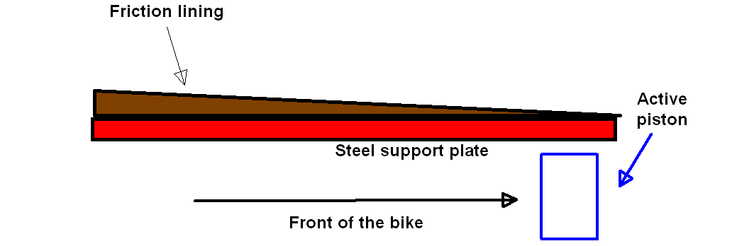

Jacek Has Found (To Our Shock) the Reason For Skewed Wear Profile of the Vado TRP Zurich Brake Pads...
He determined only one in four pistons in each of my Vado brakes worked! The reason was contamination of the outer piston surfaces with deposit from rainwater etc. So he:
  • Activated each piston by blocking all other with a flat tool and depressing the brake lever many times;
  • Cleaned the outer surface of each piston;
  • Reset the pistons;
  • Replaced the brake pads;
  • Centered the brake calipers;
  • Bled the hydraulic lines for both brakes.
Now, the brakes have immense stopping power, and the brake levers feel firm.

Might be, Marcela, but Jacek has demonstrated the reason to me very clearly. After he took the front wheel off, he depressed the brake lever. Only one piston in four moved! Jacek took his time to make all four pistons move and be working.
Wear profile. I have to add the opposing brake pad was not worn at all (because pistons at that side didn't work), and that pad could be re-used.
The point is, the identical but not as dramatic thing occurred to the rear brake pad (as the rear brake never works so strongly as the front one). All in all, one new brake set from N & T (Noah & Theo in UK) was used, while two non-worn pads went for the rear brake. Now, I have ordered as many as 4 spare original TRP Q20.11 brake pad sets just for my stock; from Bike Components in Germany.
