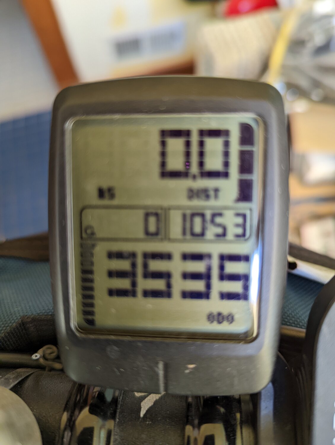

Just happened to check the ODO on my year and a half old Creo.

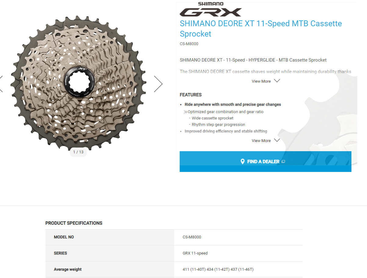

Looking to improve shifting at the rear Derailleur on my 2021 Creo SL Comp. 11-42 in the rear - Sunrace. Would this be a direct replacement? (has to be lighter for sure).
Yes, the XT 11x is a good choice, lighter and still a reasonable price.
i swapped mine out too, but for a much lighter SRAM 10-42 (XG-1195) version, which required changing the driver too. also LOTS of weight savings in the driver too. a nice option if you want to reduce weight and also get 10% taller top gear. or you can shrink your chainring and keep the top end the same but get more low end.
Highest gear of 10 is great and together with the weight saving worth the money for the new driver. But price for XG-1195 is terrible, more than three times the price of the Shimano XT cassette. An alternative/a compromise could be XG-1175.
Aren’t the SRAM cassettes 12 speed? You might look at Garbaruk cassette, they get good reviews and have models that fit the Shimano hub.
With Shimano cassette, the driver has the smallest limit at 11 teeth. The SRAM drive is narrower, so can take 10 teeth rear, or 9 in the case of E13 cassettes for example. Weight wise, the Sunrace is terrible at around 500g for example. I use the SRAM XXO at 268g for 10-42. I also reduced my front chain ring for 46 to 42. The 10 tooth rear gives same top speed, but the front chain ring again is half the weight. Less weight = further battery range in my book, does make them hill easier to !!!
