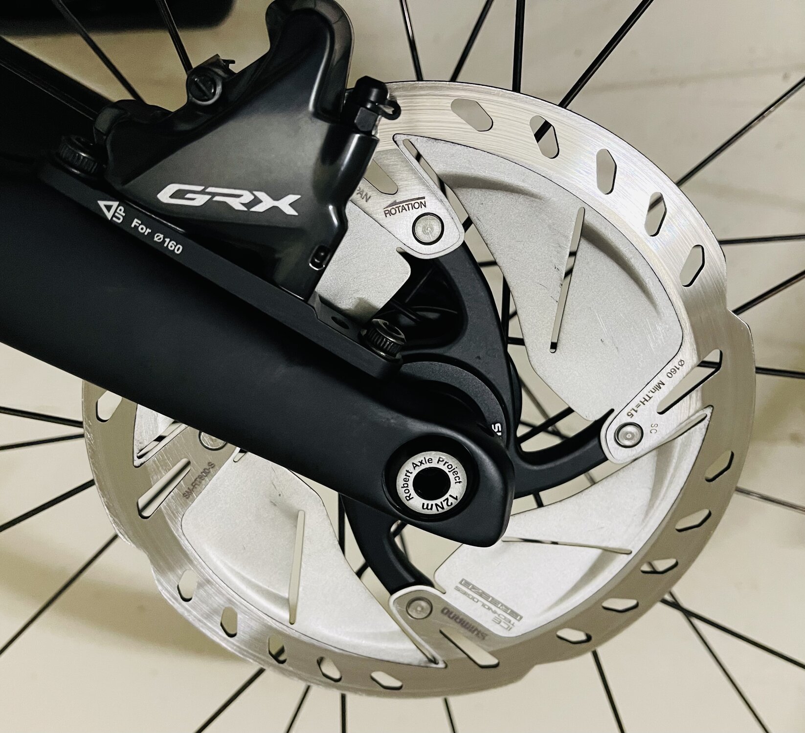

replaced my quick release axles with standard ones, these robert axle parts are an exact match except for not having the lever. nice fit, cleaner look, and i never take the wheels off except for maintenance. also saved 59 grams. 😂😂
no - that wasn’t my primary motivation!
Love Robert Axle Project. They are THE go to guys to get you set up for an axle attached trailer hitch as well. 👍
