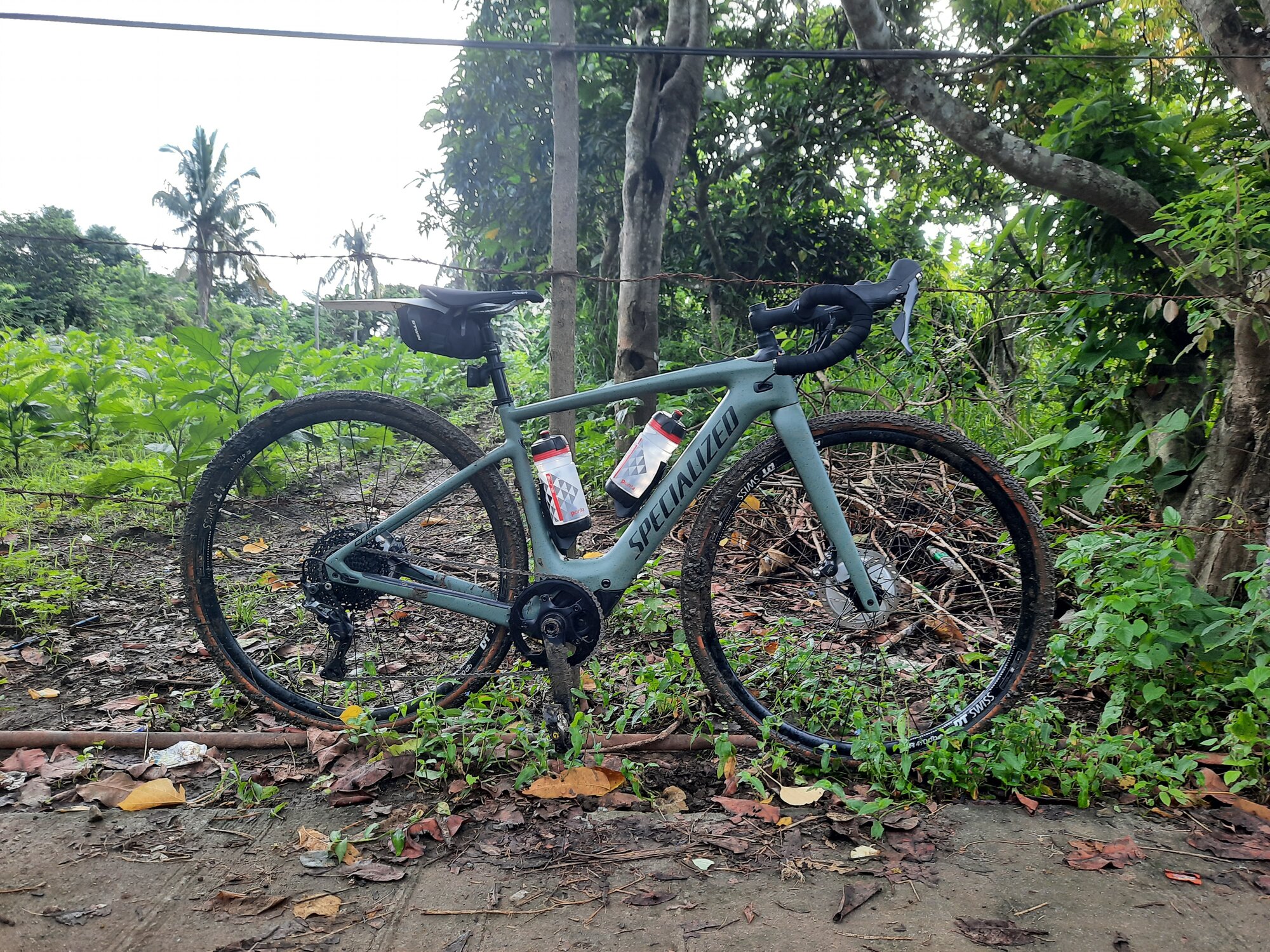

Who else is using the Creo for Gravel?
What's the widest tire you were able to fit in? Specialized says 42mm, but I would like some real life experiences. I now have 40-622 G-One Allround on a rim width 23mm inner width and would like more grip and width. It seems, 42mm is possible in the rear but noch much more, in the front is a little bit more space.
I’ve put a few miles in on WTB Riddlers 700x45c. I Would advise to use only for super dry conditions as you have zero mud clearance. But they fit.

I've been using a set of SKS Raceblade Pro XLs on one of my other bikes but it doesn't extend down far enough to shield the forward drivetrain. The fenders get strapped on in a pinch if I know I'm going to be riding in wet terrain. I used the Raceblades on the Creo the day after it snowed last week and they perform well enough for clip-on mudguards. It's nice to know that they can be swapped between geometries with just a few adjustments to the hex bolts. I hope to take the Creo out a few more rides until the snow becomes a permanent sight on the roads here.
I was also thinking of WTB Riddlers in 700-45, but decided for Panaracer Gravelking SK 700-43. (I love the tire, the grip is great, but it's still ok an tarmac.)
Even with this 43mm tire (really 43mm) the clearance in the rear is already limited, I wouldn't use a wider one there. And I'm not sure yet if my SKS speed rocker guards will fit.
Another good gravel option would be the Specialized Pathfinder Pro 2Bliss tire. It has a solid rubber center strip that I would hopefully make this tire still fairly quick, for a gravel tire, on pavement.
Come is a 700 x 38 and a 700 x 42. I just bought a set of 650b x 47 Pathfinders for my Cannondale Topstone Neo Lefty 3.
Since I hate changing tires on the side of the road, usually I put in tire liners right away after getting a new bike but I let this Creo SL slide for a bit. Wanted to see what local eKOMs I could break before potentially slowing down the rolling resistance with tire liners. Did another ride, and got another eKOM but on the way home finally got a rear flat riding through road debris after almost 4 weeks and 205 miles. Just put in tire liners in both the front and back, still using the stock tires. Usually I do Mr. Tuffy but decided to give Rhinodillos a try this time.

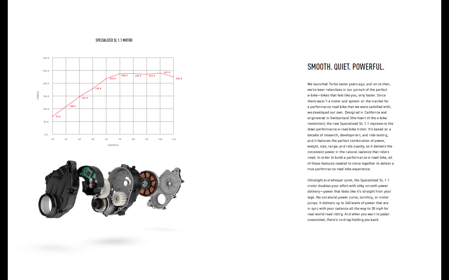

WHAT WERE THE MAIN GOALS WHEN DEVELOPING THE SPECIALIZED SL1.1 MOTOR AND BATTERY SYSTEM?
The new Specialized SL 1.1 motor represents the ideal performance e-road bike motor, based on a decade of research, development, and ride testing. It features the perfect combination of power, weight, size, range, and ride quality. In order to build a performance e-road bike, all of these features needed to come together to deliver a true performance road bike experience.
HOW MUCH DOES THE MOTOR WEIGH?
At just 1.95kg, the SL 1.1 Motor is essentially half the weight of other crank-based motors. To help achieve this light overall weight, the motor casing is made of magnesium.
HOW MUCH POWER DOES THE NEW MOTOR OUTPUT?
Our SL1.1 motor amplifies rider power up to 240 watts and 35Nm of both peak and sustained power. We tuned our motor to deliver constant, strong support across a wide cadence range for a very natural feel while pedaling.

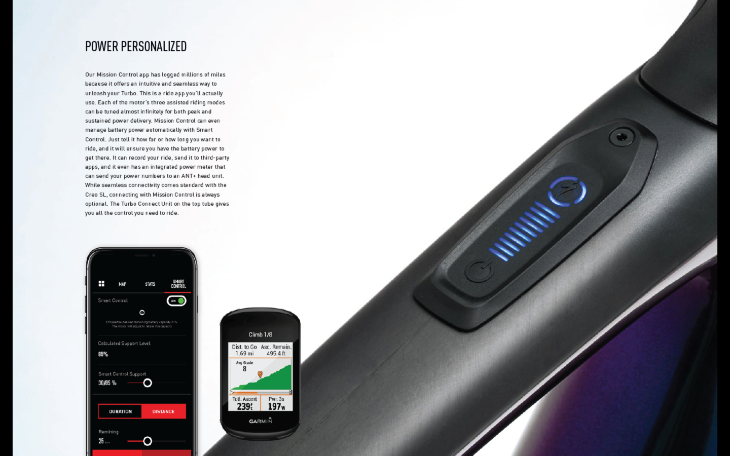

HOW MUCH MOTOR TUNING ABILITY DOES THE MISSION CONTROL APP HAVE?
With the Mission Control App, you can tune the level of assist almost infinitely (both peak power and sustained assistance) for each of the three ride assist levels: ECO, SPORT, and TURBO. Our Mission Control App allows you to fully customize your Turbo Creo SL motor to your personal needs and riding preferences. Of course, we only allow the rider to tune the motor and its behavior within the given speed limits in their respective country. We do not allow riders to tune the motor beyond the legally allowed speed setting.
HOW DOES SMART CONTROL WORK?
Using the Smart Control feature of our Mission Control App enables you to enter how far, or how long, you want to ride, as well as how much battery you would like to have left at the end of your ride. Smart Control then takes care of all battery management to reach those targets. It does this with a smart algorithm that checks the bike’s status every 10 seconds. Keep in mind, with Smart Control initiated on the app, assistance modes cannot be altered via the TCU on the bike’s top tube. Riding with no assistance means you’re not getting any motor support, but that the system is still on and recording/sharing data to display on apps or ANT+ enabled devices.
HOW DOES THE TURBO CONTROL UNIT ON THE BIKE’S TOP TUBE WORK?
The Turbo Control Unit has two buttons and a battery level display. The bottom button is used to turn the bike on, while the top button is used to select one of the three assistance levels—or to ride with no assistance. Quickly push the button to cycle through different modes—1/3 blue circle is ECO, 2/3 blue circle is SPORT, and full blue circle is TURBO. Press and hold the button until all blue lights turn off to ride with no assistance.
