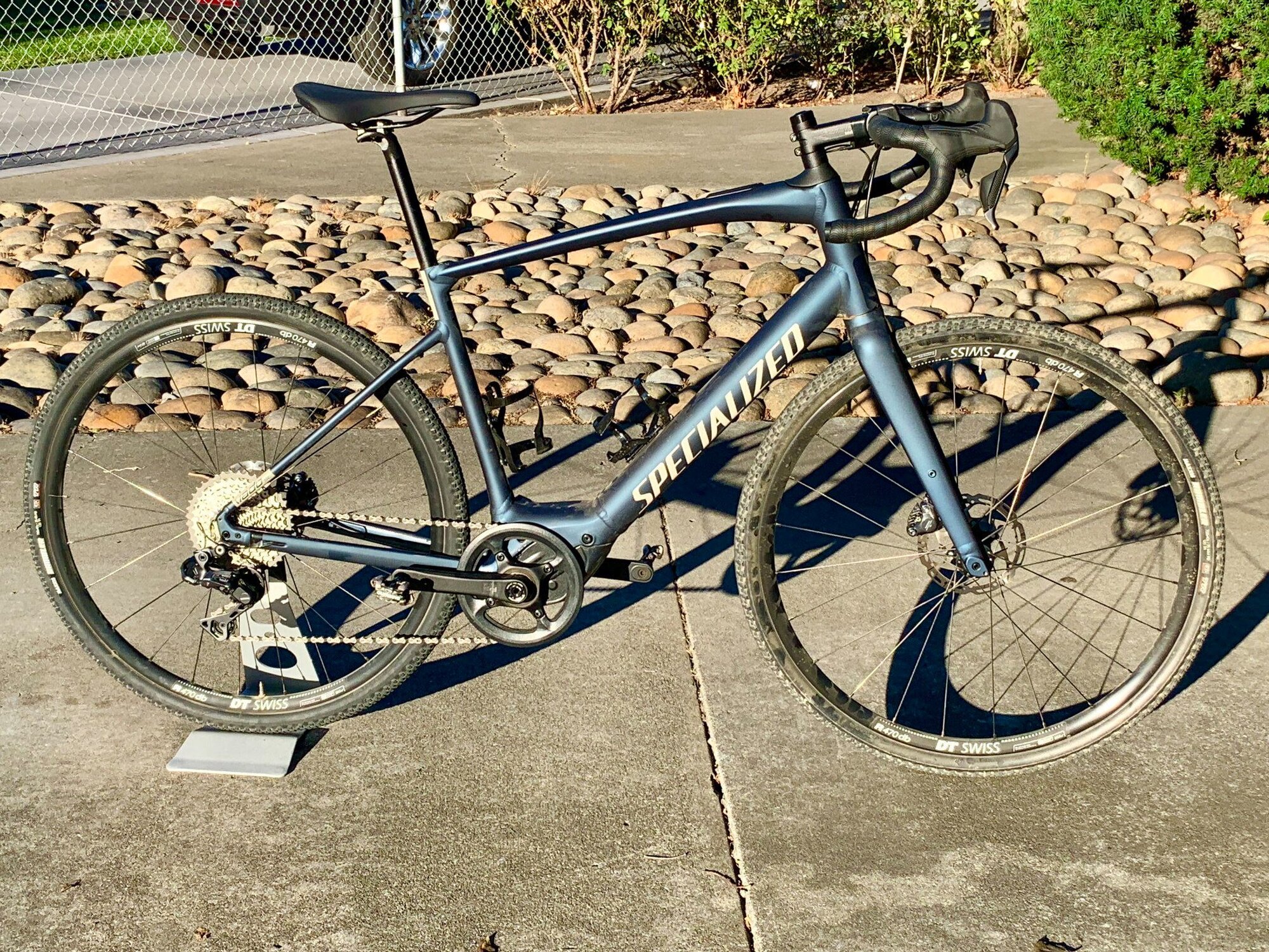

Specialized Turbo Creo 28mph Electric Road Bike
yesterday i rode my bike and was in 46-11 and cadence was 85 with turbo mode on - I could still reach 26mph on a pretty much flat road. does that look ok?
I think cadence have to higher than 85-90 to get to higher speed?
Correct... you are almost there! ;)
Keep practicing to increase your cadence to the 85 -95 range.
