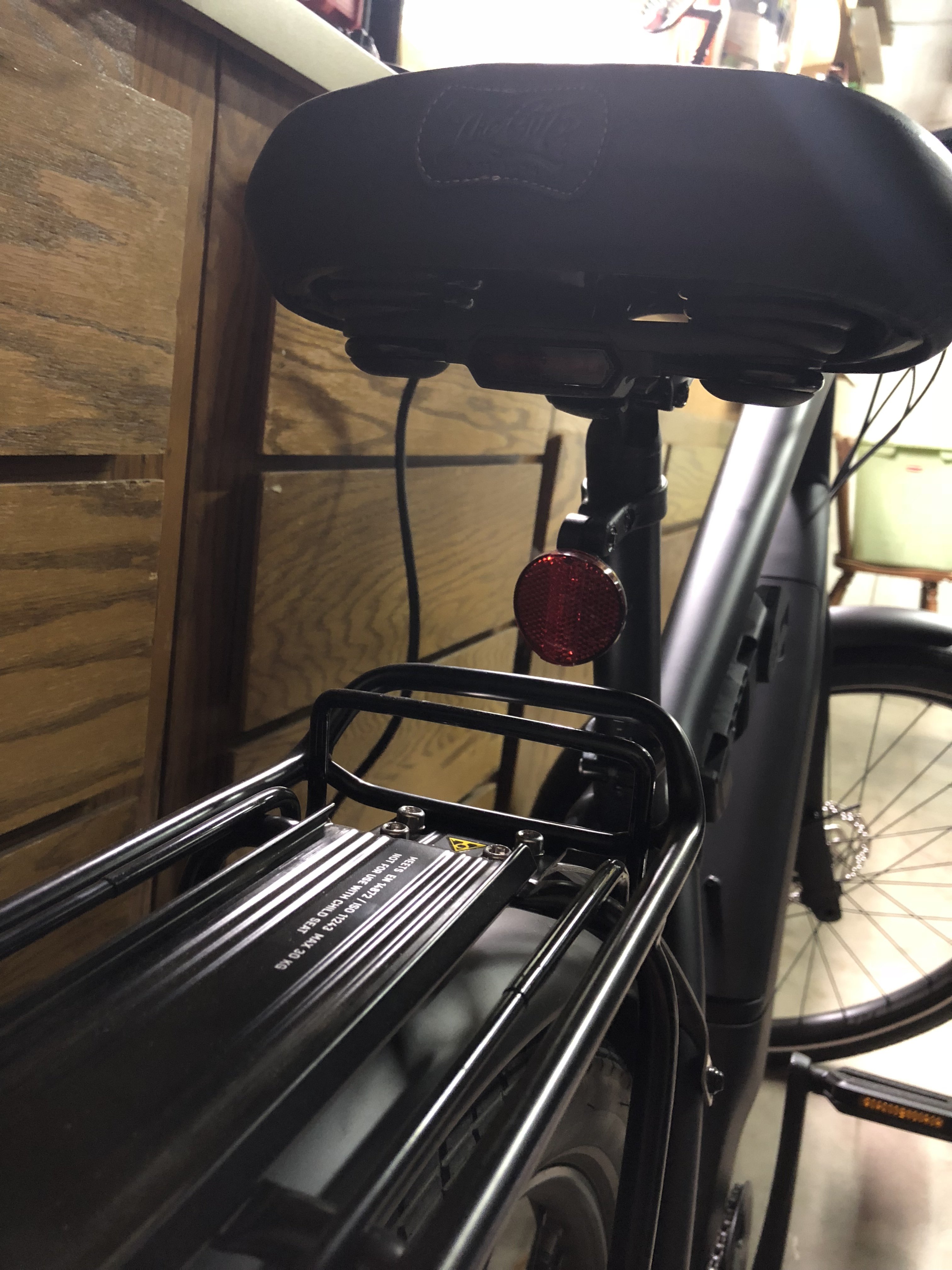

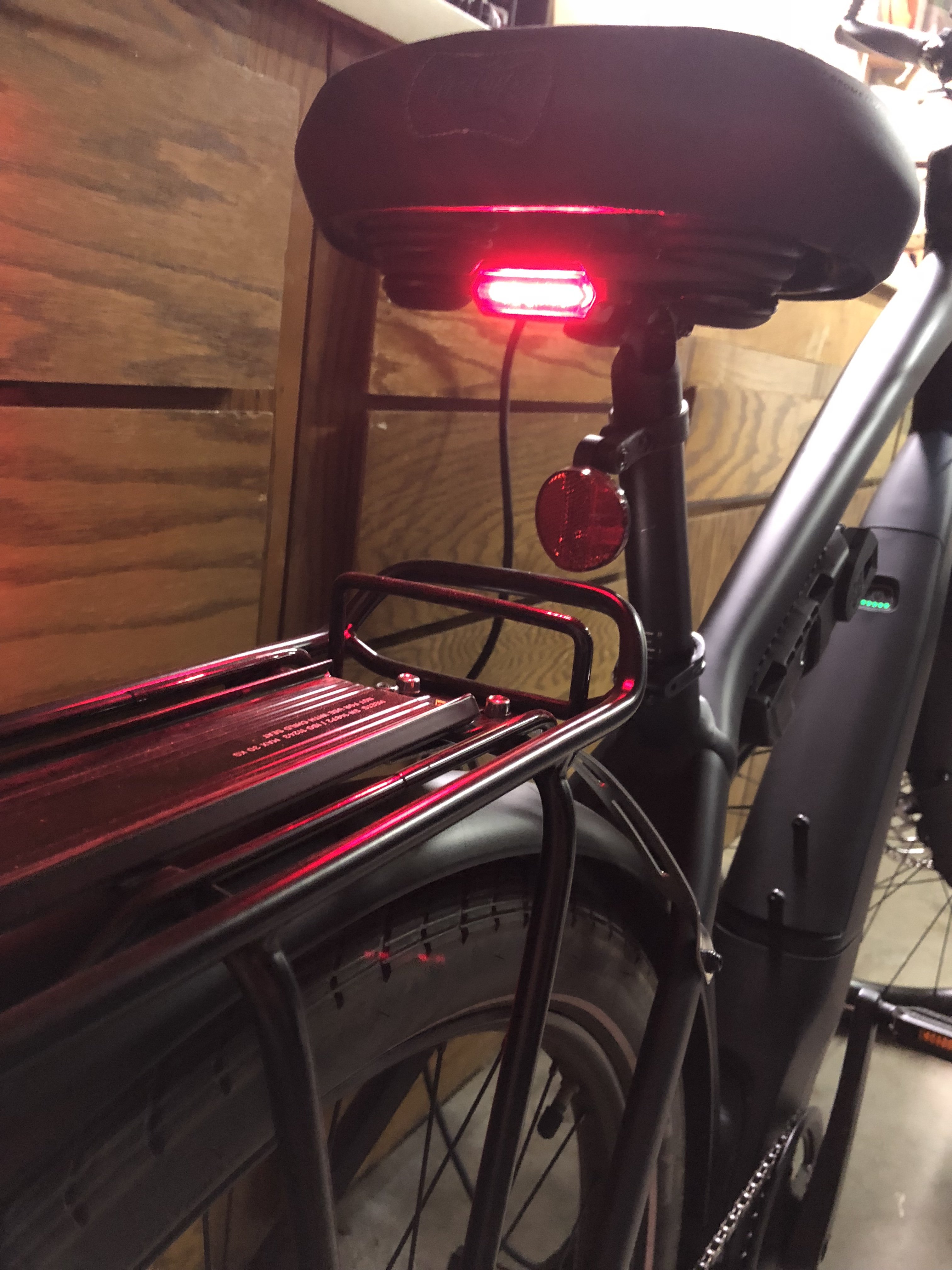

I'm very happy with my new bike. At around 200 miles so far, it has been perfect.

I just got the Como 3.0. There is really any pictures or reviews of the bike online. My LBS had the Come 2.0 so they had to order the 3.0. I like your rack. How did you get your rear light off the seat and on to the rack?

The rear light; to move it, I unscrewed the light from its bracket and zip tied it to the new location. This Brooks seat is so much softer than the original. I cut the wire and spliced another piece in to make it longer. I just bought a suspension seatpost, a Kinect, not here yet, and I don't think there will be an outlet for the wire from this new seatpost. I noticed the wire for the Vado (very similiar bike) comes out of the bottom of the motor and back up it's fender from the bottom.

Thanks for the reply. I was wanting to also get a suspension seat post. I didn't even think about how the wire could complicate things.

It appears that the Kinect/bodyfloat, for seatpost, latest version, is the marginally supreme choice for smoothness and visual appearance, at the premium price of course! If you don't feel comfortable rewiring the rear light, I'm sure your bike shop will do it. It's such a convenience to have lights and not bother with separately recharging them, and that back light is quite bright.
