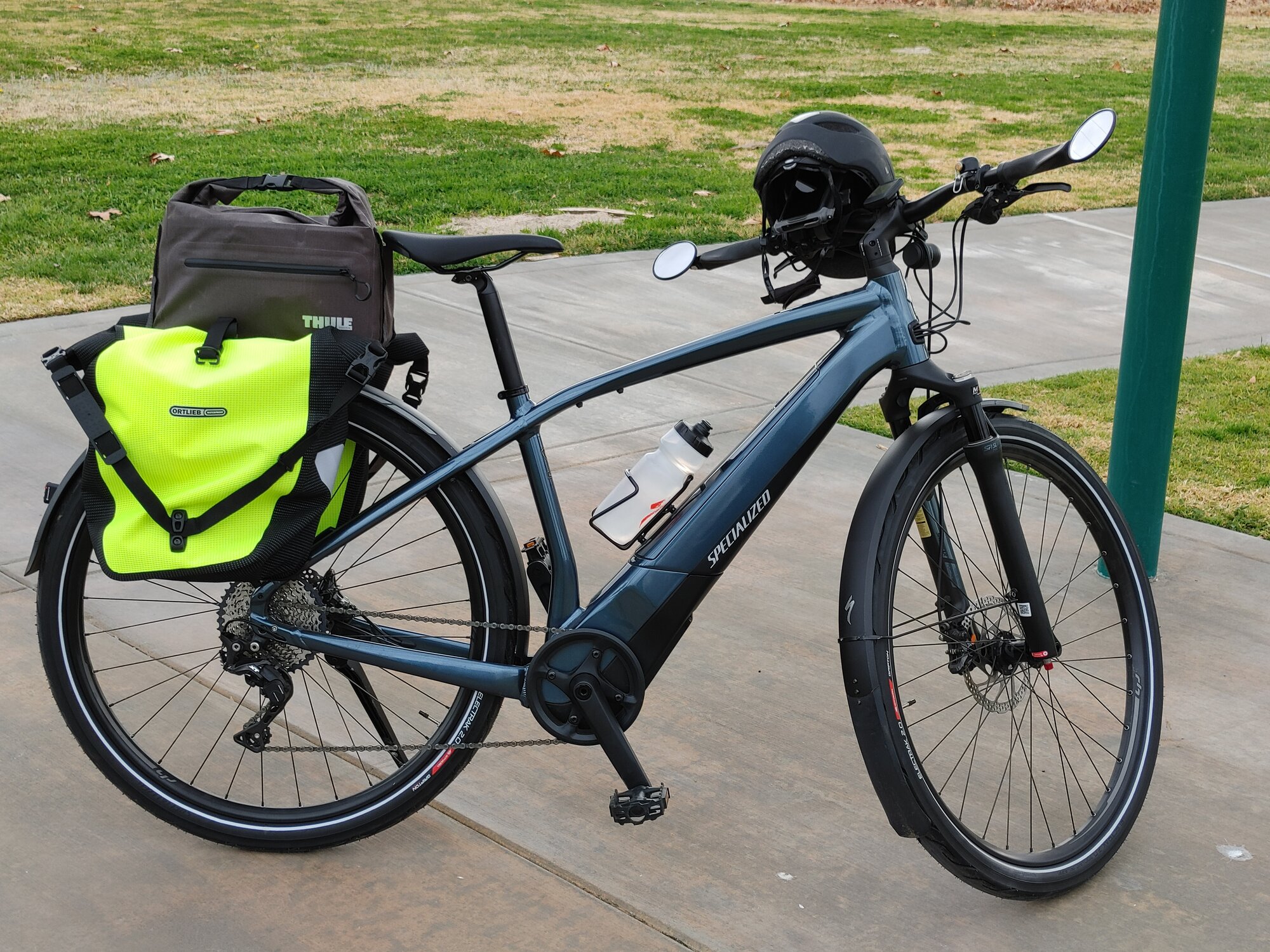

This is how I'm rollin.😍 New Ortliebs Q 2.1 Back Rollers. Diggin these bags and the new tires. Expensive bags but worth every penny. Feb. 10 it will be my 1 year anniversary with this bike. I know it's crazy to love things that can't love you back. It goes without saying.

I'm so happy Kam I feel as if I were you 😊 Bear in mind the Ortliebs require occasional maintenance. Tighten the screws in the panniers occasionally. Don't overload the bags. If already don't own it, fill the panniers with Ortlieb Commuter Inserts 😊

Wow I have those bags but looking at yours I forgot how clean mine used to be. I feel shame ....so I guess I should get out the scrub brush.
