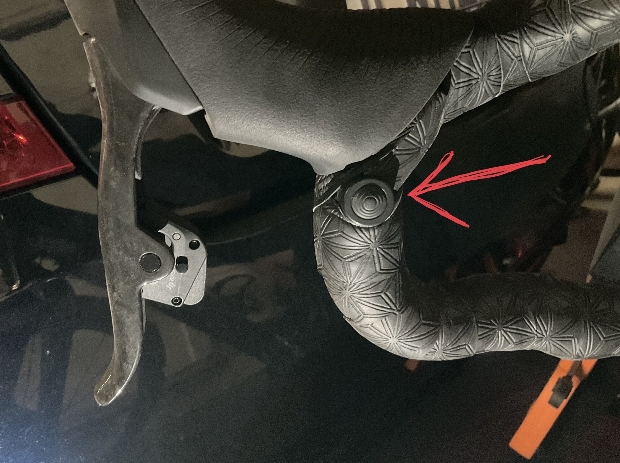

Has anybody installed and used them? How do they attach to the TPU - the power on and power select unit on the top tube. I presume that the wires don't just enter under the tight fittings of the display. Zip ties or similar to attach the wires to the handlebars?

They install under the handlebar tape, on the INSIDE of the shifters, accessed by your thumbs. Do not let the bike shop install them on top. When installed as pictured, you can use them from the hoods or the drops. Thumbs for power, fingers for shifting and braking.
Electrician’s tape to attach them to the handlebars, then handlebar tape over the top. You don’t want bulky zip ties under the handlebar tape. The wire from the TPU routes through a cable port.

I had them installed during the initial build up of the bike. I test drove a few variants of the Creo that didn't have the remotes & didn't want to have a Creo without them. Mine are in the same place too & work well there for me.

I may be too tired from my early morning hike but are they are the outside of the drops just below the hoods? Oh, I guess I had not thought of removing the tape, placing the wires and reinstalling tape. (turnaround time at the shop is four days)

Inside of the drops. Accessed by your thumbs. Thumbs inside for power. Fingers outside for shifting and brakes.
There seems to be a standard from Specialized. You shift on the left to a lower gear, making it easier to pedal. So they put the more-power button (easier to pedal) on the left. The right shifter makes it harder to pedal, so the less-power button goes on the right.

See pages 9-11 of the manual for how to get the cables inside the bike and routed to the Turbo control unit. I think the remote kit includes a new cover for the frame opening.
Rincon is correct about the “standard convention” for the up and down power buttons but you can connect them anyway that suits you. For me it made more sense to make the right button is power up and the left button is power down.

It's super easy to install, wrapping bar tape is the hardest part. I put the buttons below the hoods on the inside of the bar, as shown above. More specifically, I put them as high up as they would go, they are on the bar but butted up against the brifter clamp. Then I actually wrapped the tape over the button as if it wasn't there. It's almost invisible, barely noticeable, but it works and I can feel it fine through the tape. Works with hands on both the hoods and the drops.

More specifically, I put them as high up as they would go, they are on the bar but butted up against the brifter clamp. ... Works with hands on both the hoods and the drops.
Yes, this is great advice. If they’re not placed up high enough, then you can’t easily reach them from the hoods. I electrician-taped them in place, then tested hand positions, then moved them higher.
