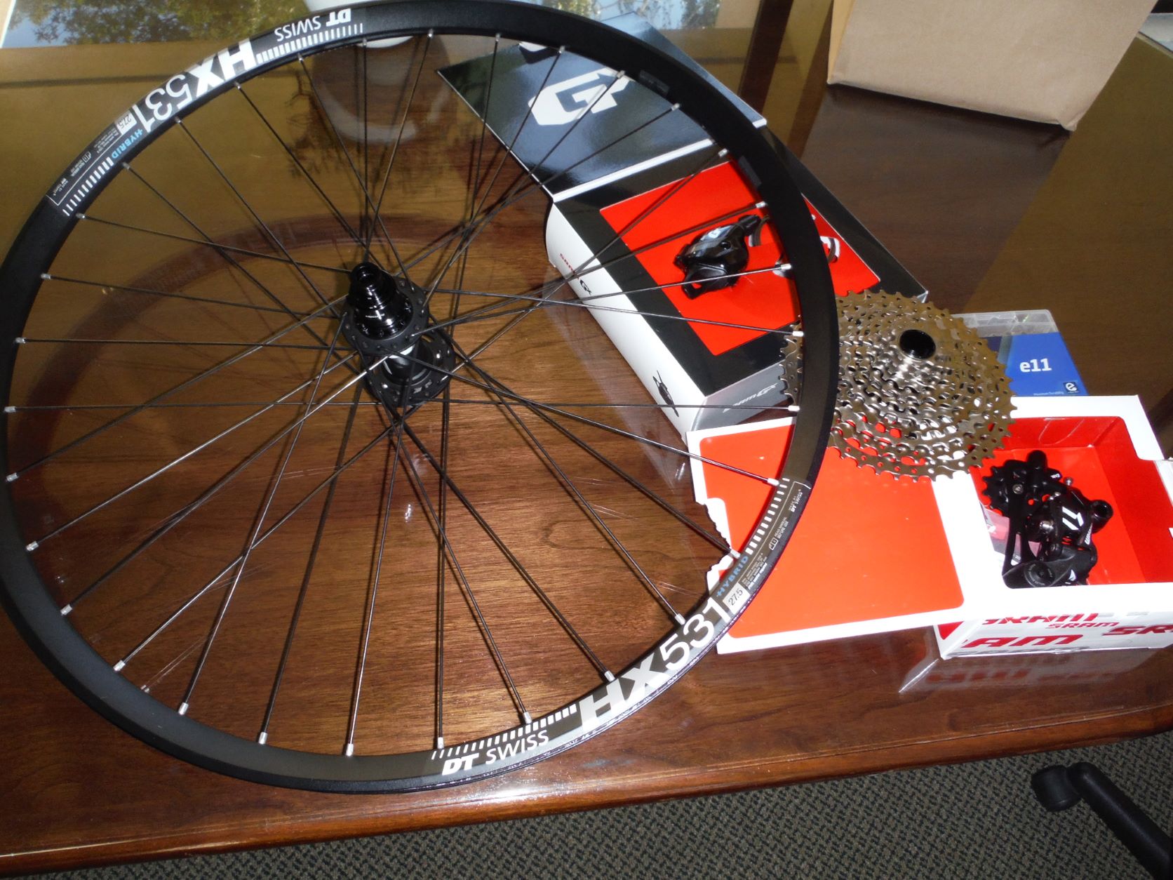

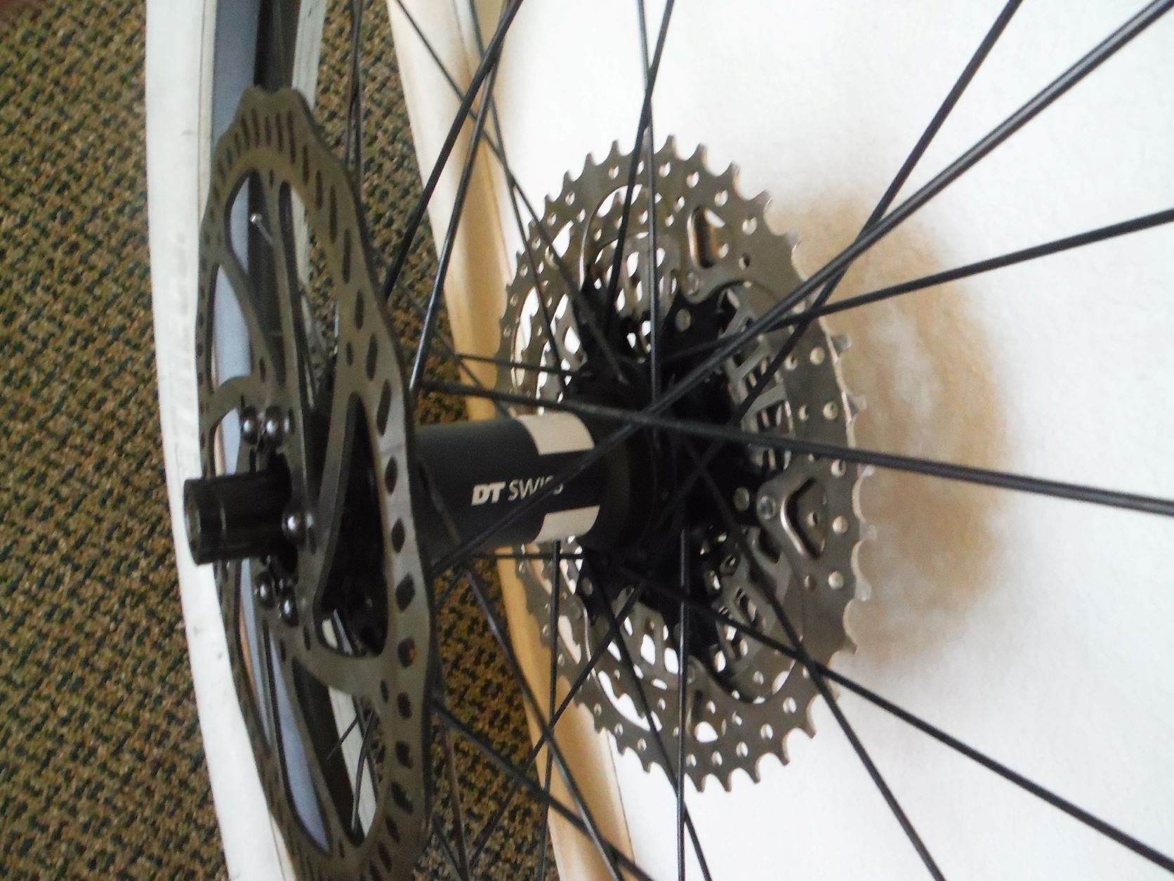

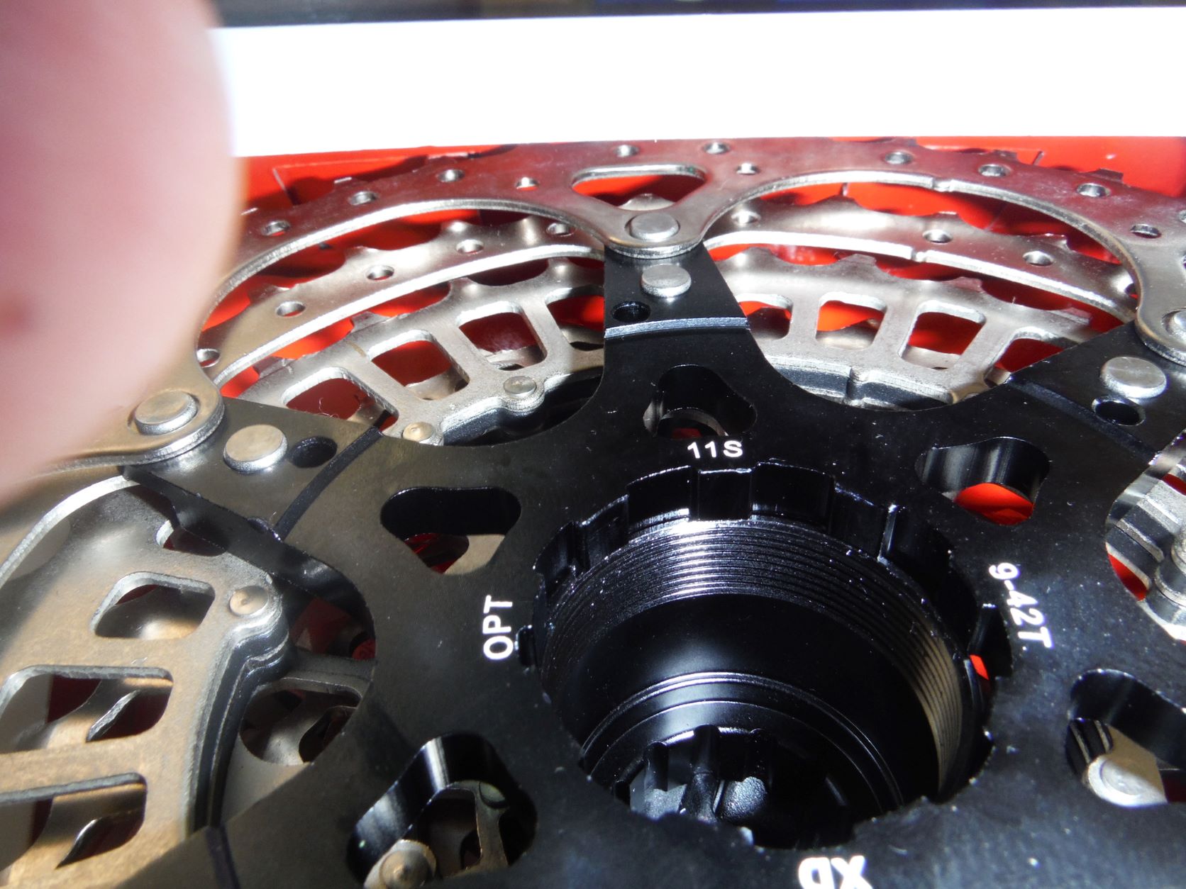

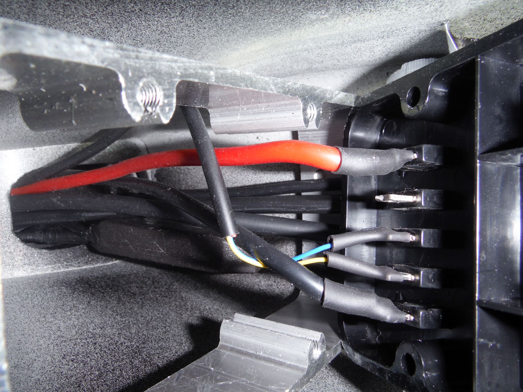

There have been reports of problems with the rear hubs of Sondors Cruisers. Can anyone else confirm this? What solutions did you come up with? I went with a DT-Swiss rim, XD hub, Alpine spokes, and GX shifter, cassette and derailleur. And a real 12mm boost through axle. The cassette is 9-42 tooth. XD allows for a 9-tooth cog but I would not recommend using it much with this powerful motor because only 4 teeth are in contact with the chain. That is a lot of concentrated force! Feeding the shift cable through the gear sensor only takes special tools and half-a-day in the bottom the Pit of Despair under the battery. The GX cassette is both splined and screws in.
I would not have done the XD cassette body. As you say you can never use the 9T cog, which to my mind is the only reason to switch to SRAM bodies. I do have two bikes with SRAM 11s and they are both stellar, but for both I used steel Sunrace CSMS7 clusters, along with a DT350 hub upgraded to steel cassette body and the Hybrid cassette ratchet. I see you used the HX531 rim. I assume cuz you bought the wheel pre-built? I have settled on the FR 560 which is DT's strongest (downhill) rim. I have them in 29er size and 26". I literally just took delivery of a FR560 wheel for a project that will keep me busy for the rest of this year. Sapim Strong spokes, brass nipples. DT 350 142x12, 24T ratchet, I'll add the steel Shimano cassette body from my stockpile. Its getting a Microshift Advent 11-46T 9s cassette. I could have gone with AdventX and done a 11-46T steelie, but then I couldn't use the 9s Box 2 XWide with its 50T capacity - I love that uber cage to let me wrap lots of chain.

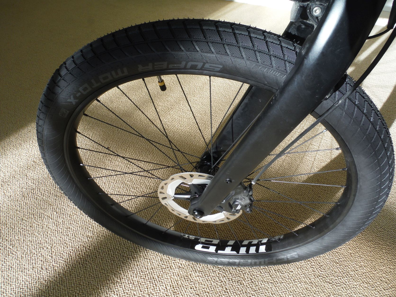

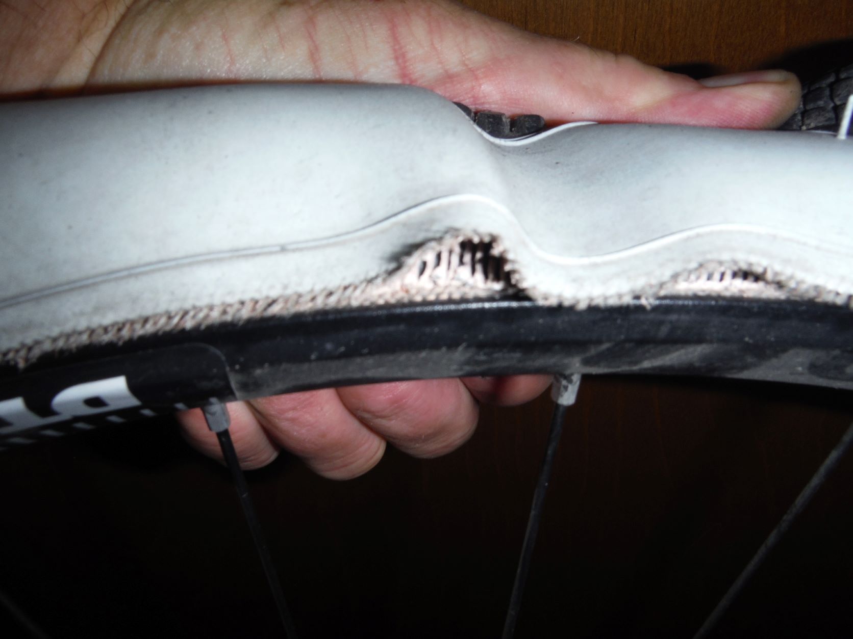

The front wheel warped due to fatigue at the valve hole. It was going to break and taco at speed. I installed a nice WTB wheel (made in Michigan with DT Swiss spokes) with a Shimano center lock 180 disc. The rear tire was de-laminating. So, I installed Schwalbe Super Moto X tires with Stan's tubeless sealant inside the tubes. The black wall tires look so much better than the original white walls.
