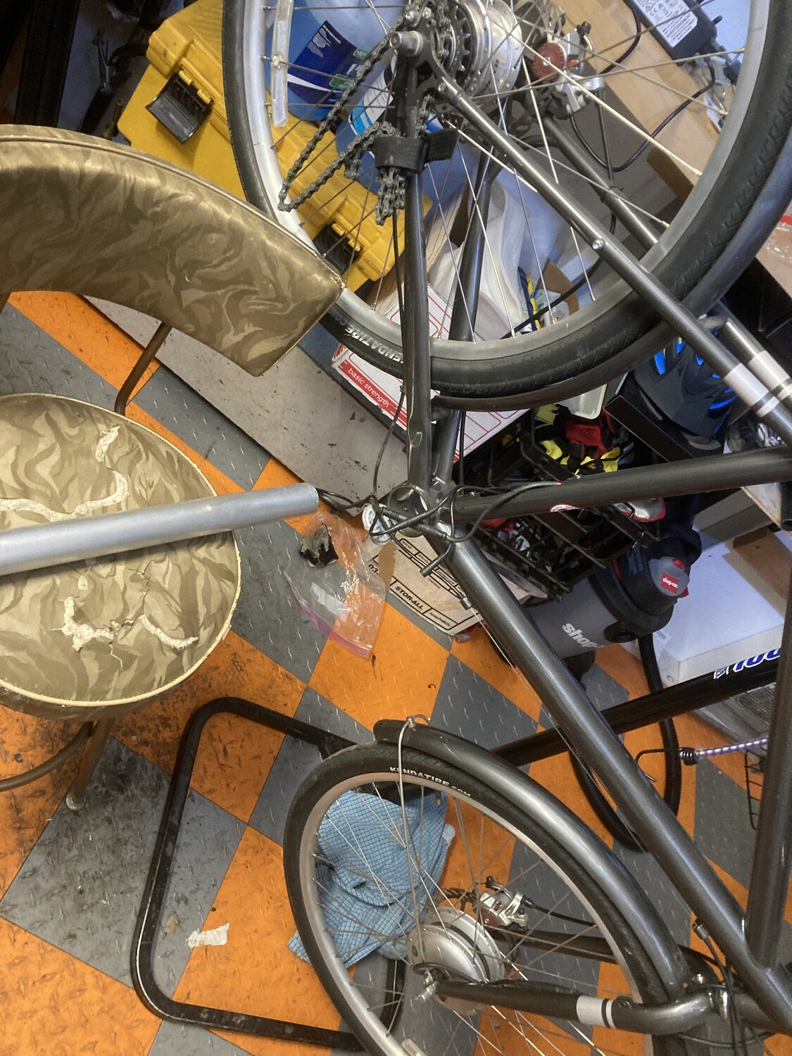

1. plug in charger, blue light is on but headlight turns on
2. press bluelight button, light goes off after 3 seconds and charge cycle starts (looping red LEDs)
3. after 30-60 seconds,looping red lights go to solid indicating charge complete
4. no charge appears to be held - removing charger stops all activity
I have bike torn down:
1. how to check if the battery is bad?
2. how to check if the controller is bad?
Plans:
I'd like
1. to have it working, but yes cheap
2. keep batteries in the downtube/keep it tidy
3. open-source/standardize as much as possible to keep it maintainable long term

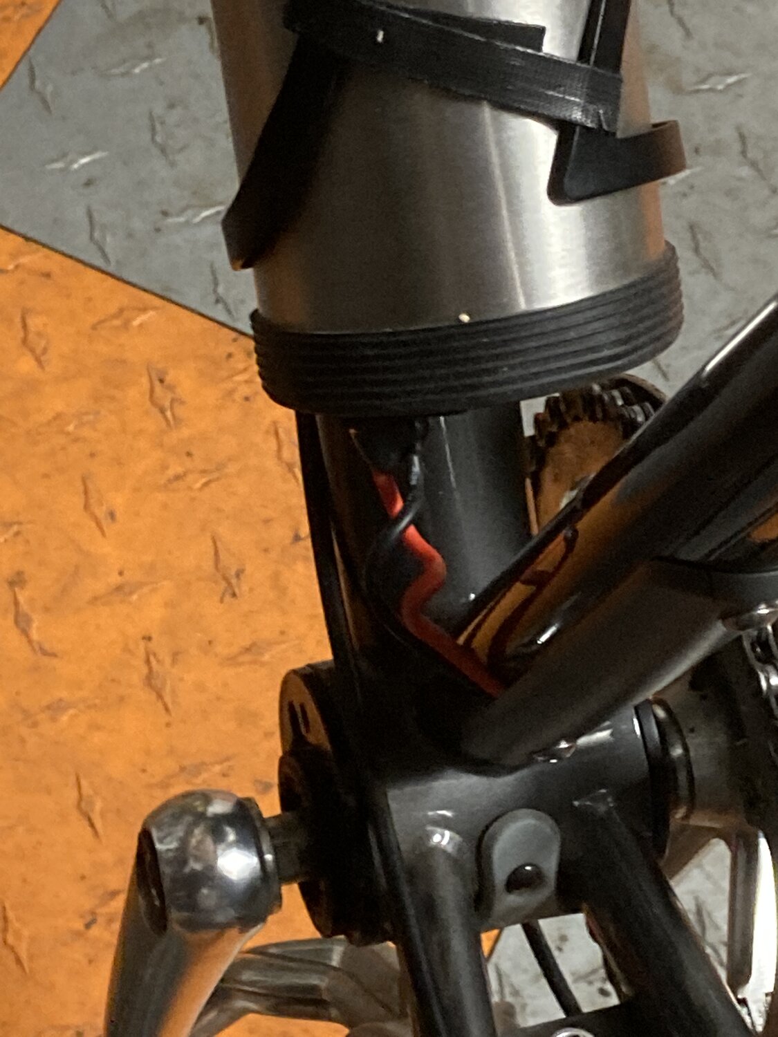

Y, 3 conductor wire and the a small 4 conductor plug (bms?). Seems dead, not sure if there are any electronics in the pack that need to be actuated to arm yhe battery….

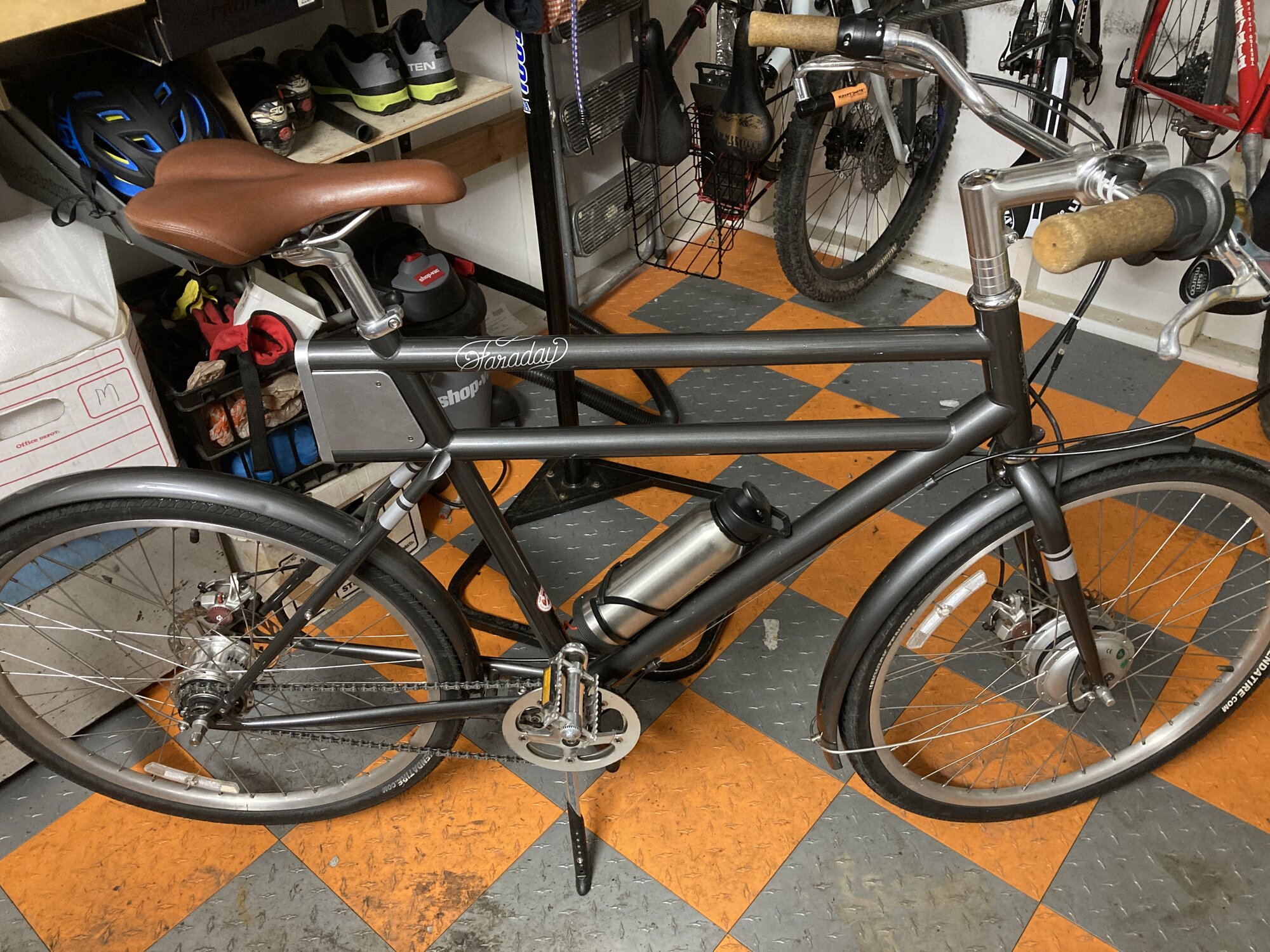

So I rode if 7.5 miles, but it seemed a little anemic - battery reading > 50volts after the run so the pack seems good.
Please review here!
If its 250 watts it would still assist well, watching the video it seemed to be sluggish, perhaps the motor needs to be split and serviced and its possible it might free up a bit after some usage.otherwise an intruguing bike and nice build.
Nicely done. Although anemic, for what it is and was originally designed for as an urban commuter type bike, it is a handsome design and good on you for bringing it back to life.
