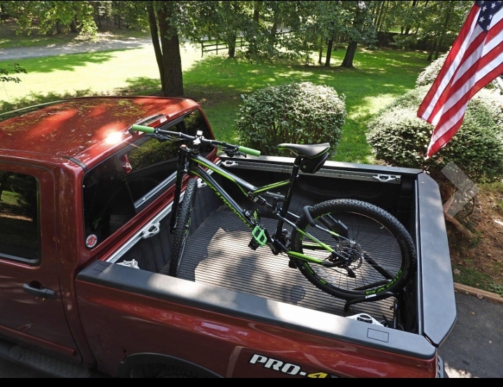

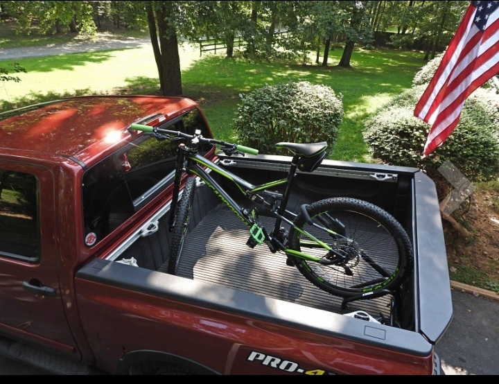

I own two Thule Insta-gator racks and I like them very much. Years and many thousands of miles. I've used them with BH and Haibikes, 29'er and 27.5. 50 lb +/-.
Thule Insta-Gater Truck Bed Bike Rack https://www.amazon.com/dp/B000GT2VYI/ref=cm_sw_r_cp_apa_i_B7LmEbR5PKF2V
I have a 6-1/2 foot bed, so it's a little easier to use for me. There is a review on Amazon where the guy uses one with a short bed. This is what that looks like in a short bed.
44734
What about those rubber blankets that go over the tailgate so the front wheel is out of the bed and then chain it down to something in the bed or hitch?
This may be a dumb question, but does driving with the fork in that angled position do any damage to it? I have a Fox rhythym fork.

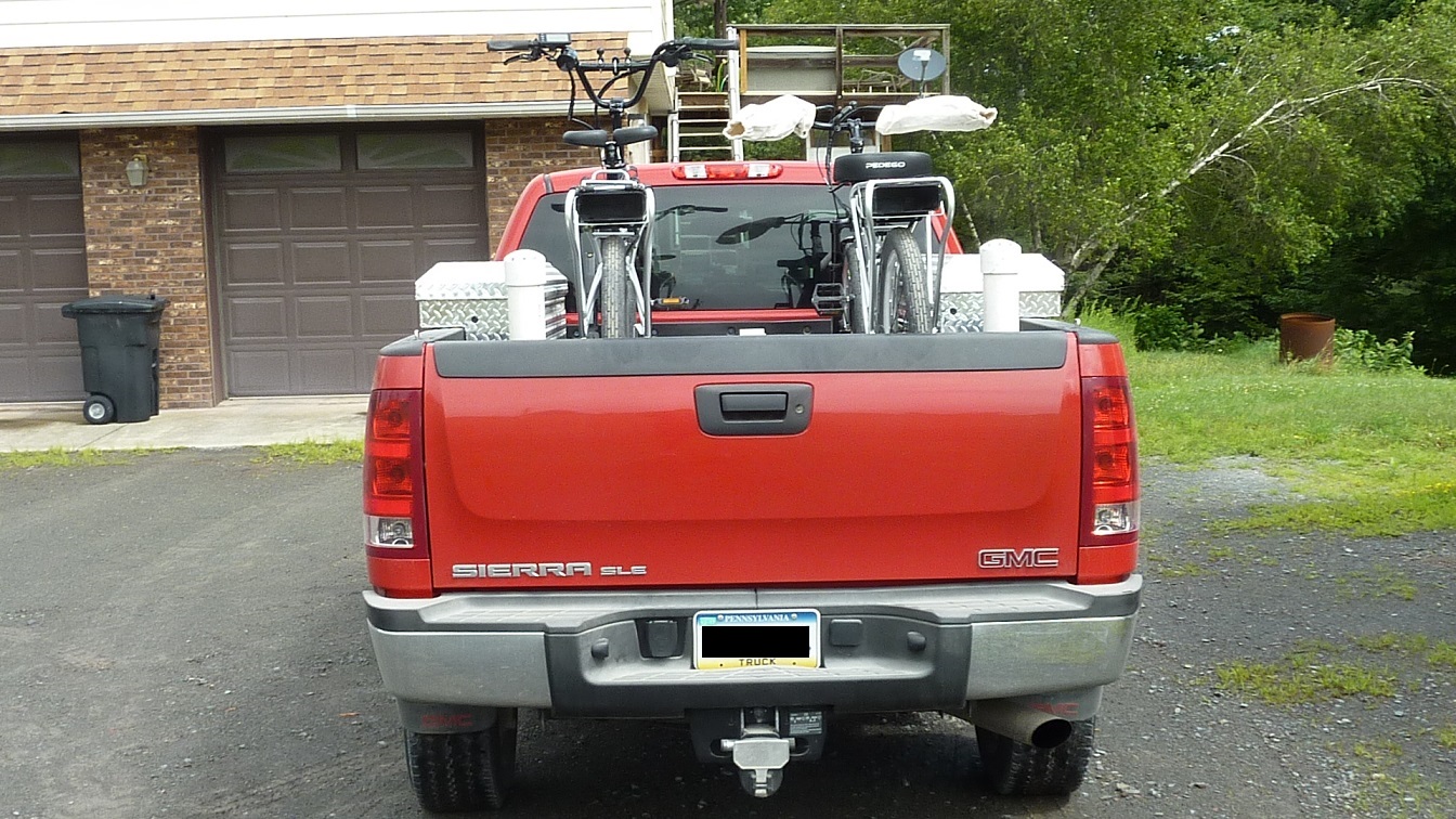

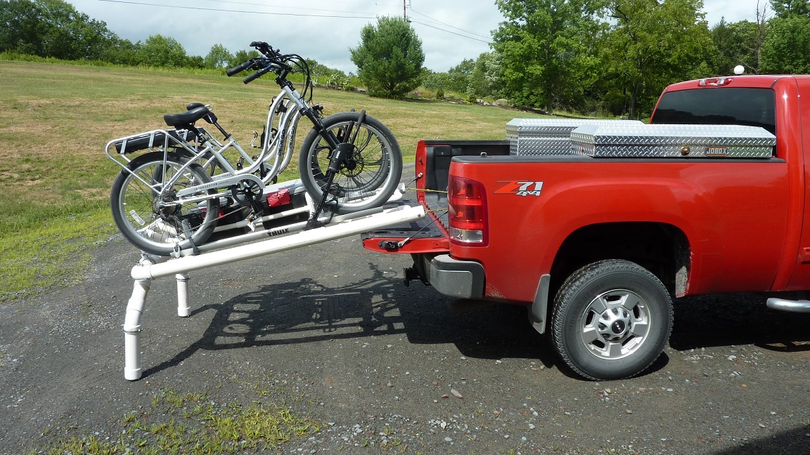

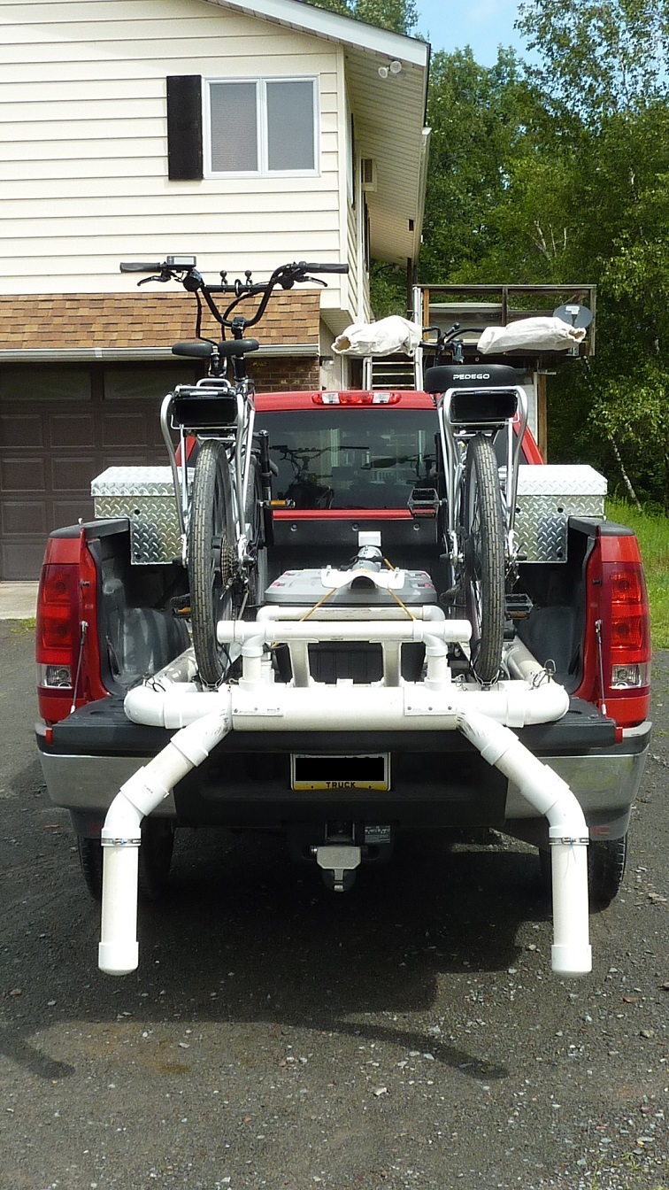

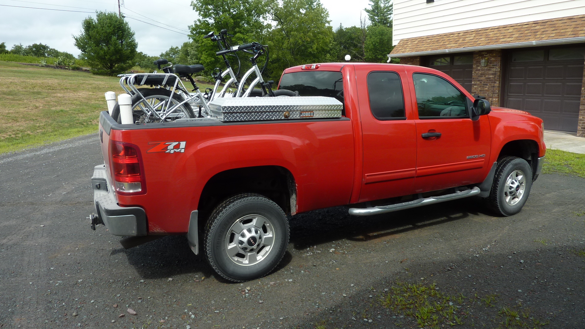

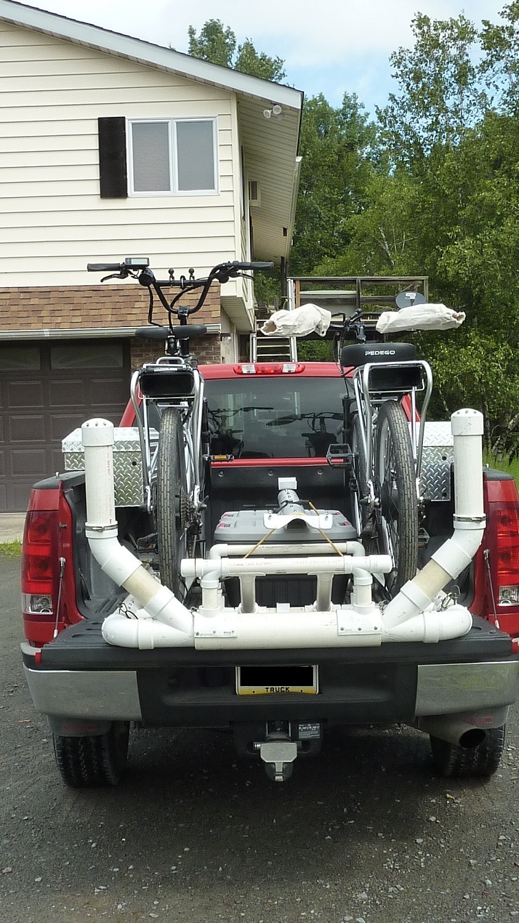

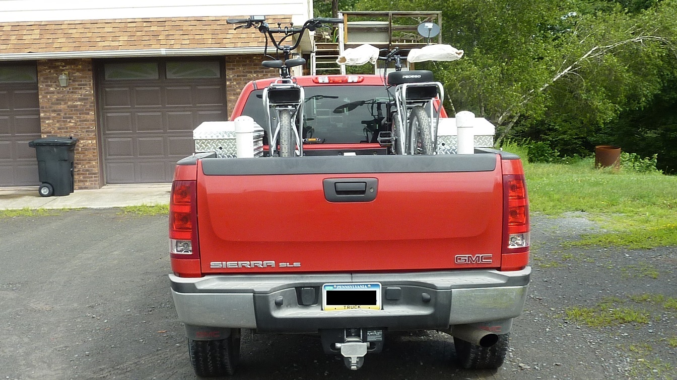

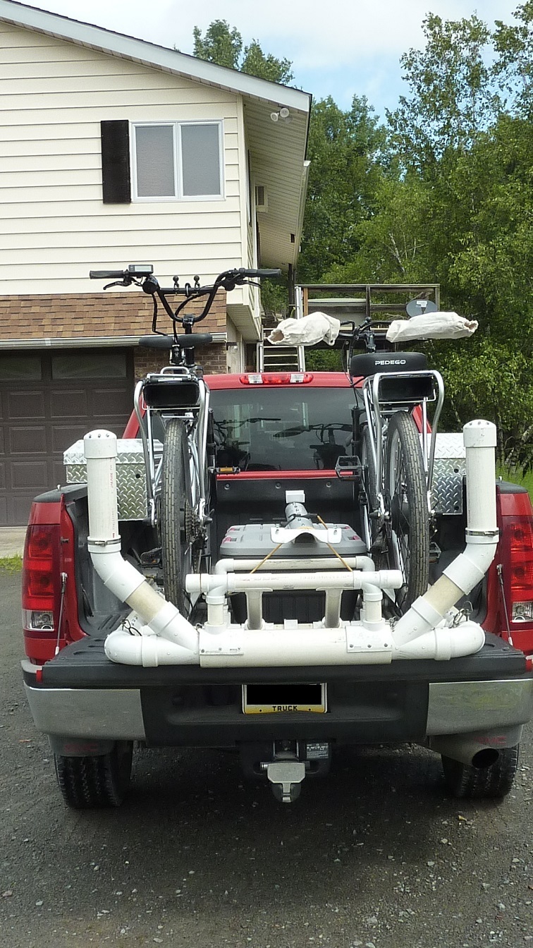

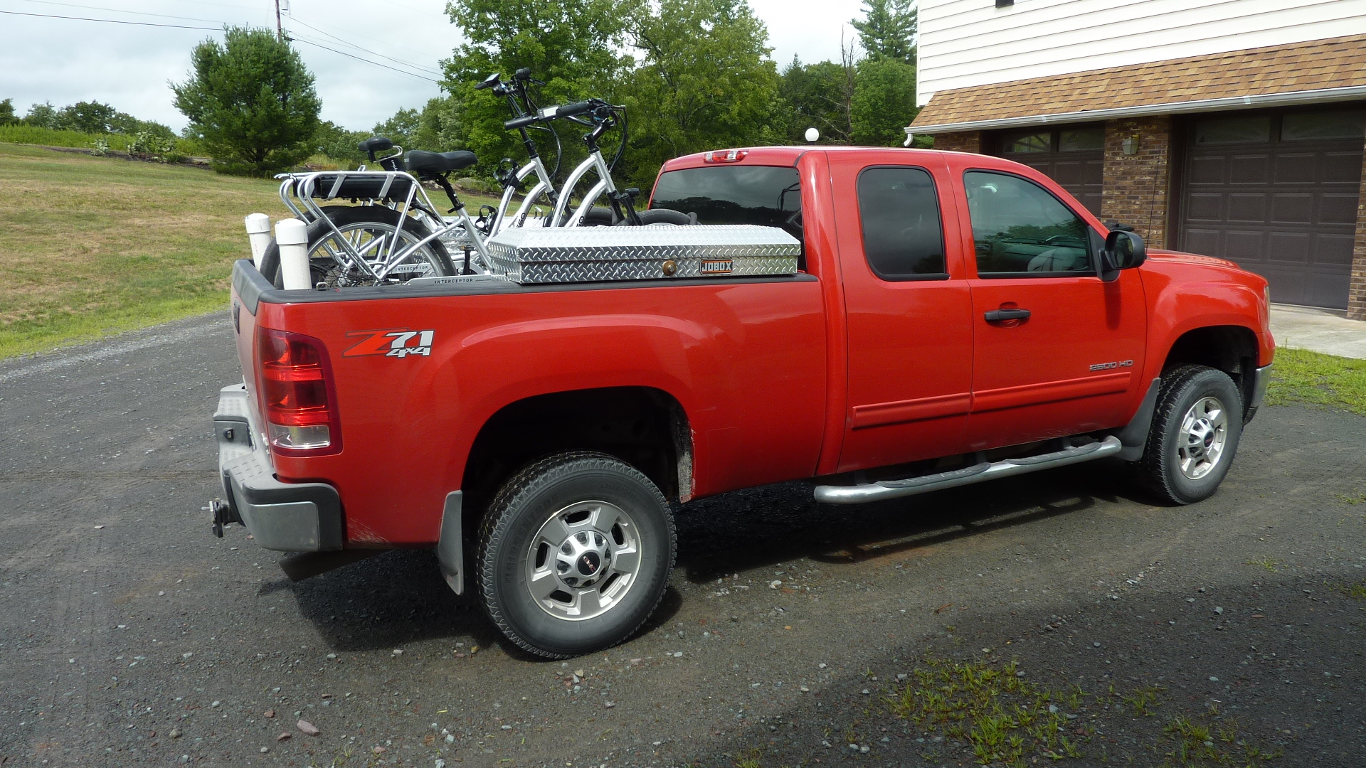

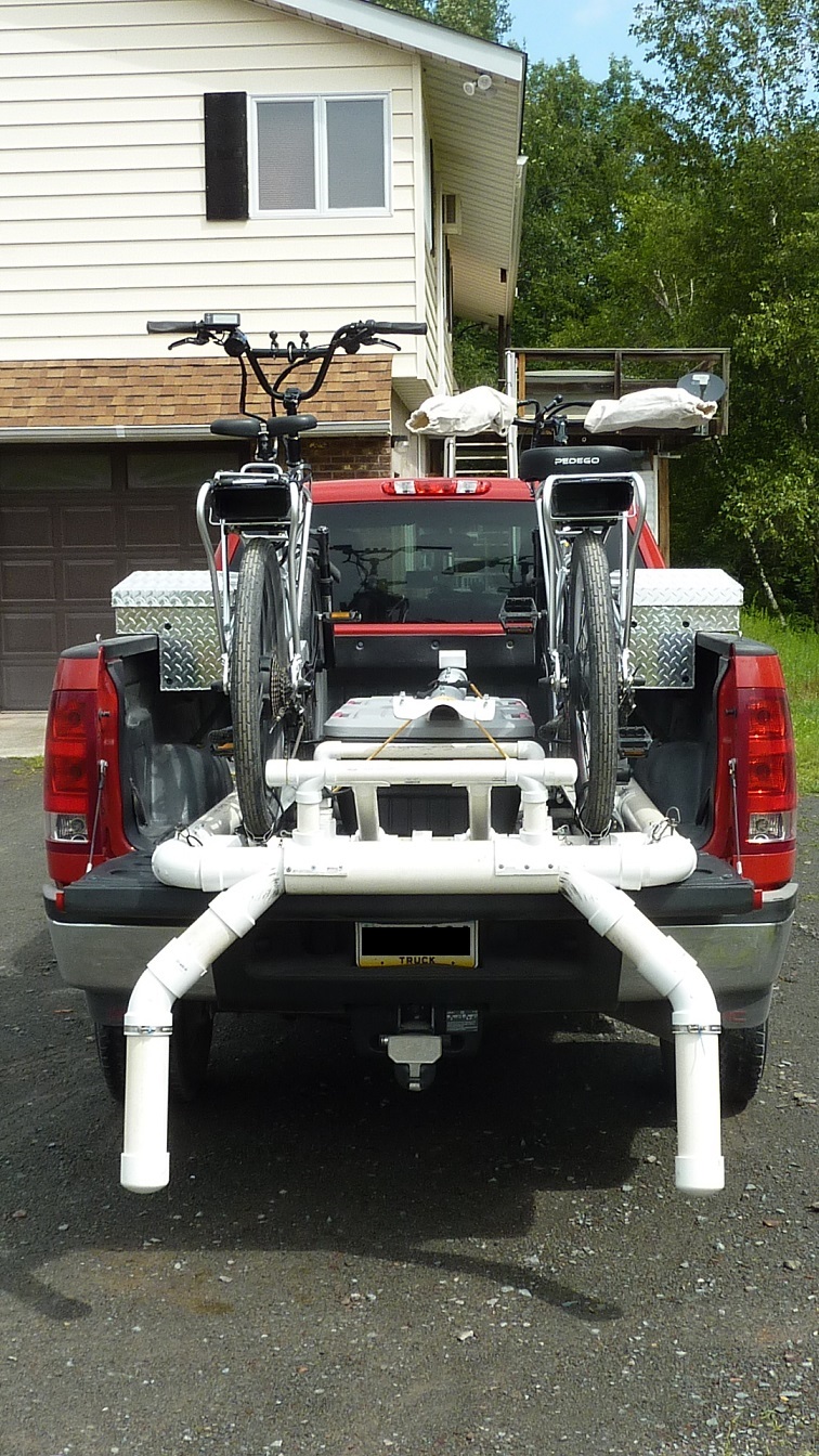

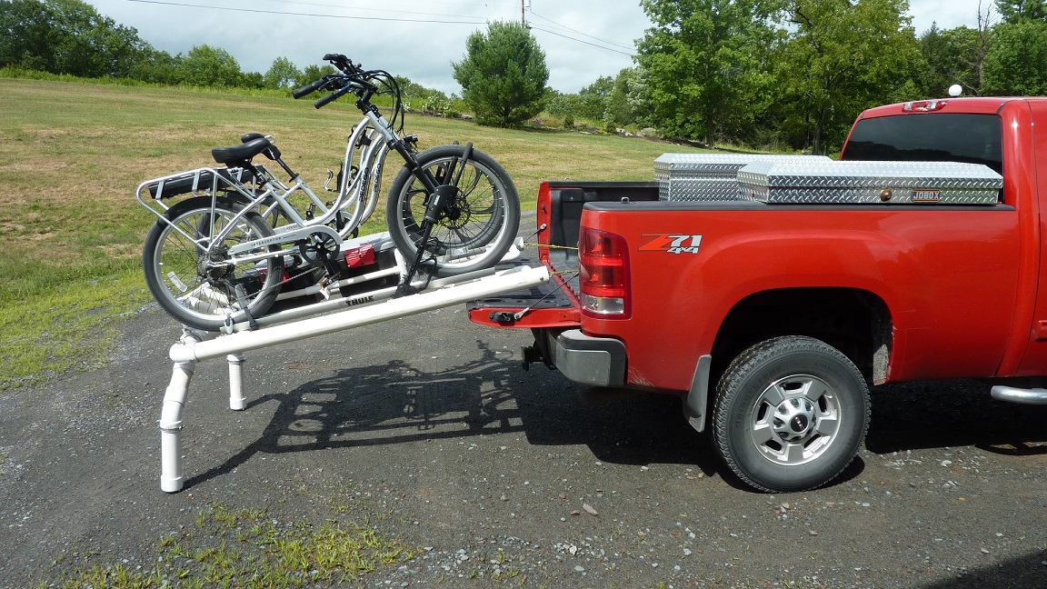

I carry my bikes in my pickup bed on a rack made from PVC pipe and two Thule Sidearm roof racks. The truck is an extended cab with a 76" bed, just long enough for my 75" bikes.
44742 44743 44744 44745 44746 44747
The advantage of the PVC rack is it slides easily and can be deployed with a pair of pivot legs to make loading easier. The rack is a snug fit in the pickup bed so it does not need to be tied in place. To minimize bike side sway, I tie them off to the pickup rails with ratchet straps.
I've seen several other similar racks on short bed pickups that use this type of bed extender with the tailgate down.
44741
The PVC rack provides ample support even if it extends out beyond the tailgate.

I noticed your avatar when I first started the search for a truck bed application and was going to PM you in the spring when it came time to build something similar, thanks for attaching the pictures they will certainly help my design and build process for this style of carrier.

I lock the rack to the truck bed tie downs using Master cuff locks, one on each side:
44920
I then secure the bikes to the rack with Foldylocks:
44918
I also use this audible alarm attached to the back of the rack where it is difficult for a thief to access. It's sensitive enough to alert when someone tries to climb into the truck.
44919
The Thule Sidearm racks have key locks which adds another layer of protection.
In addition, I lock the truck tailgate which makes it nearly impossible to remove the rack with attached bikes from the bed. I realize this isn't possible with a short bed truck though.
Sure, the locks could be cut but they are difficult to access without opening the tailgate. Doing so would activate the audible alarm and only the boldest of thieves would attempt to defeat 3 separate locks with an alarm blaring.
