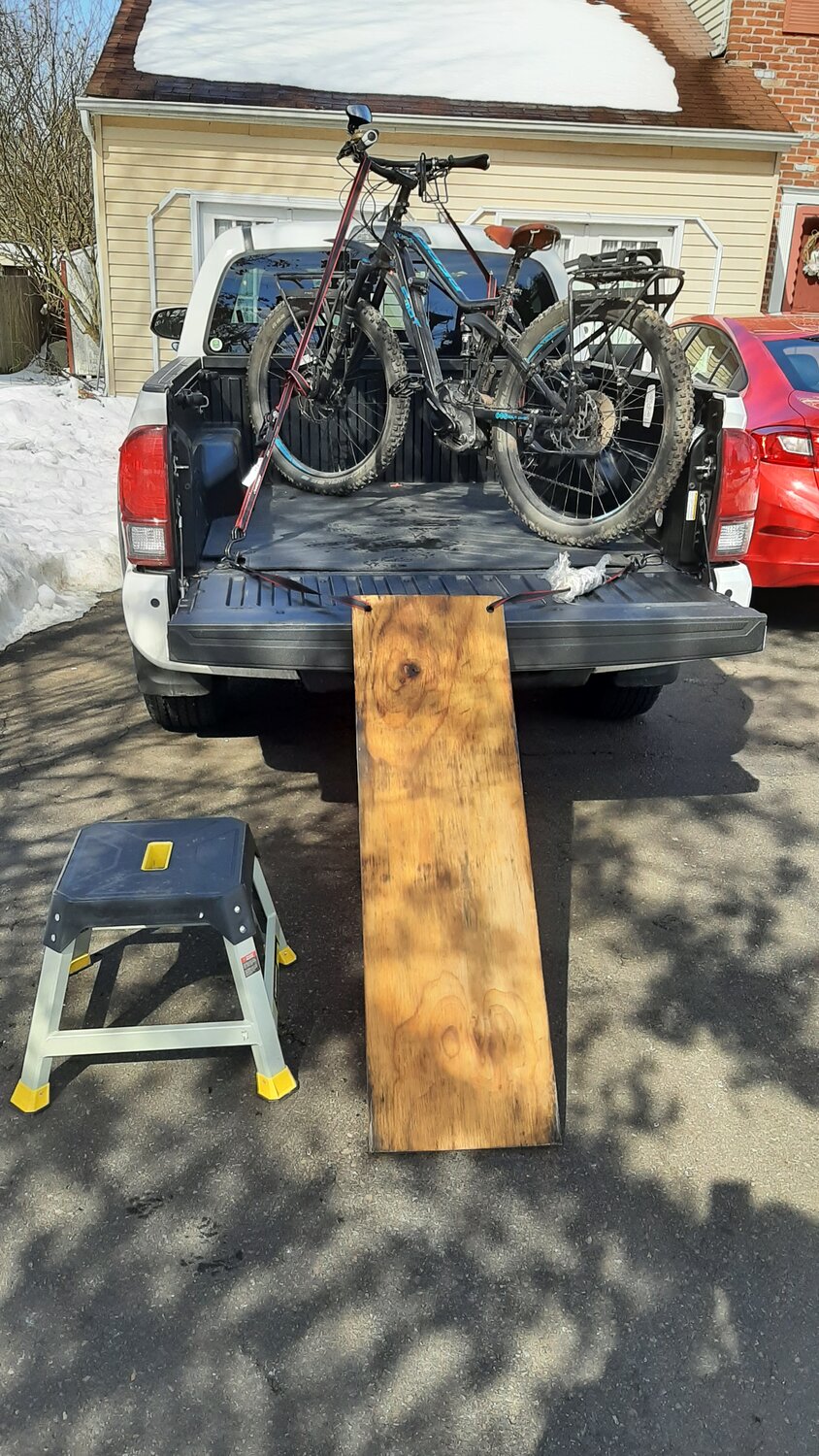

A 4 foot piece of plywood, a stepstool, and a couple ratchet straps to the habdlebars are all you really need. I just tighten the straps until the fork begins to compress. You can also tie off to the saddle rails if you don't have a dropper post.

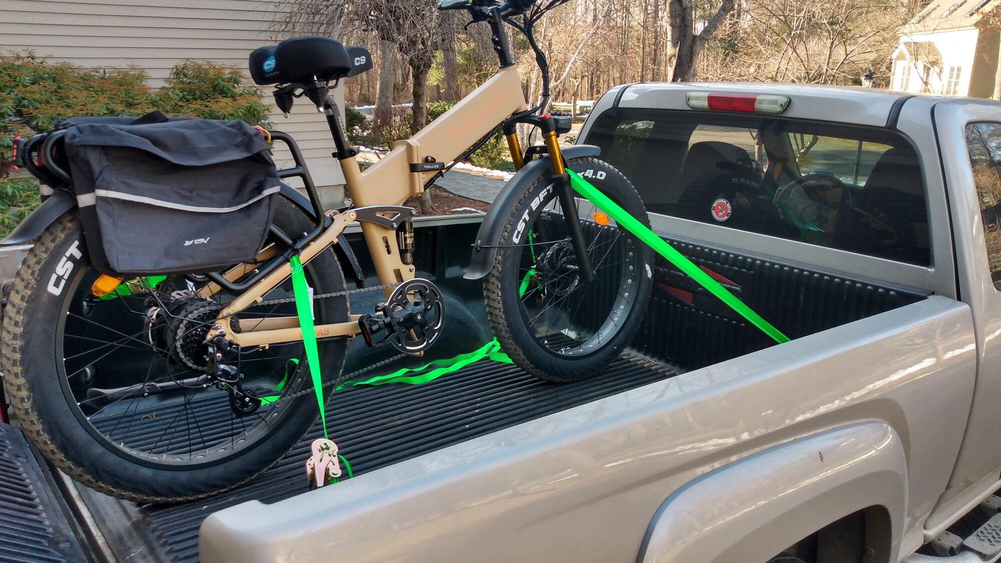

This is a GMC Canyon (small truck). The Wallke ebike has a Walk Mode which lets it walk up the 6' ramp easily.
The ramp cost $51 about a month ago (January, 2021)
