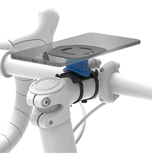

Back to the thread topic… I use the Quad Lock system to mount my iPhone 6. No problems to date.

How does the Quad Lock's Universal Adapter mount to the phone case? By, heheh, the 3M tape? Beware.
How many months have you used that? My Spigen has been flawless for 3-4 months... The temps in Australia are not that low as we experience in Europe now. Any rain?
Isn't it the Quad Lock? The Universal Adapter looks like the one from Spigen.
Note: The Plastic Weld seems to be stronger than steel :) Rated allowable stress is 246 bar while it is 138 bar for Carbon Steel if I'm not wrong.
And why would I bother to glue a mount to my phone which will eventually fail rather than a protective case with the quadlock mount built in?
They offer that for folks that would rather use their own phone case or in my case I use it for my Golf GPS unit. I use the Quad Lock phone specific case for my iPhone X and have the Out Front model on one bike and the motorcycle Handlebar Mount on the other two bikes, prefer the motorcycle mount, seems more robust/solid to me.
I was hesitant at first with the case really because of looks when not in mount with the back 'bump-out' it has, but in reality it is minimal. Wireless charging with case on which is key for me.
