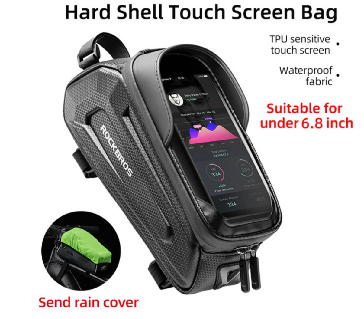

I use that bag.I know this isn't the same thing and most of you don't like clutter, but I found a toptube bag to be the safest thing for my phone. I rarely need to look at my phone while riding as I ride to escape, but I can easily see it when I do and it's also a great place for a wallet, keys etc...
Even the most secure handlebar mount isn't going to protect your phone if things get ugly... and that's when you'll probably need your phone most.
11.96US $ 54% OFF|Rockbros Bicycle Bag Waterproof Touch Screen Cycling Bag Top Front Tube Frame Mtb Road Bike Bag 6.5 Phone Case Bike Accessories - Bicycle Bags & Panniers - AliExpress
