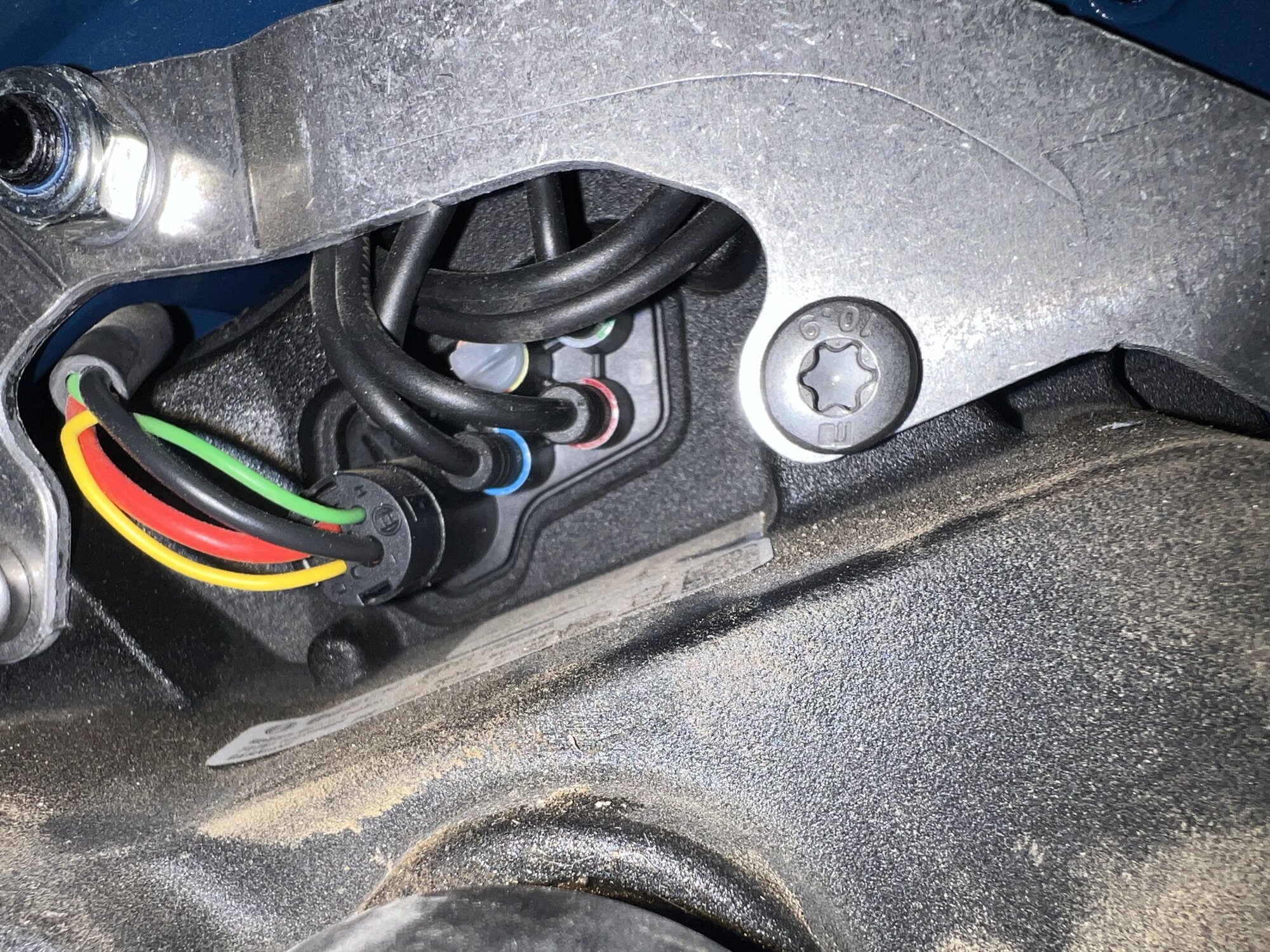

Is the yellow port with the cap an available power source? I am adding a Varia radar.
Also looking for a tech manual for this system as the user manual is pretty short.

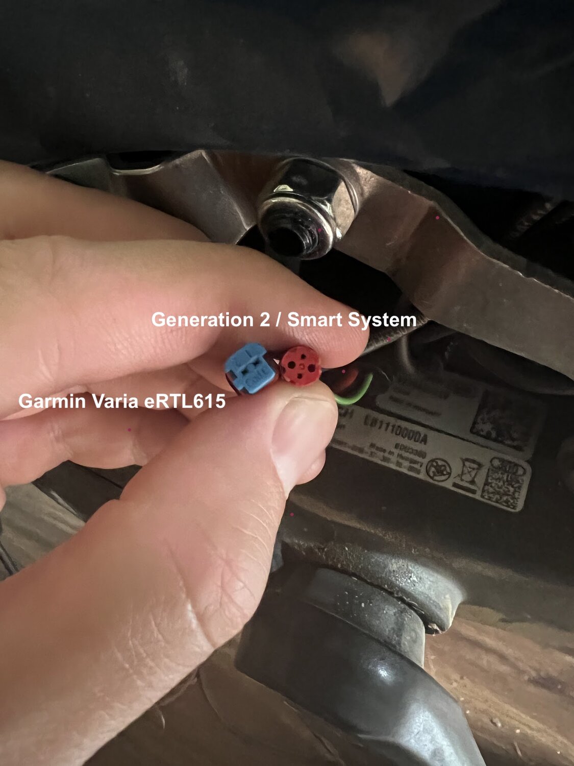

Yep, Bosch Cable (Generation 2) via Garmin, while the bike uses the Smart System.
The dealer is reaching out to their Bosch rep to check for an adapter or other way to hardwire.
The Smart System cables are bit smaller (red = smart system, blue = gen2)
Update: a local Bosch dealer got with the regional rep and found that a simple wire splice would work.
The yellow port is being used.

@AvalancheRun glad you were able to get assistance from the dealer! I'm sorry about your experience when you called in to get information. That has been noted for correction.
But indeed, just like system 2, the smart system has an available 12V port (yellow) for third party connections. Due to the smart system being so new, it will take some time for third party companies to catch up and provide applicable connectors. I came in to let you know about the available cable to splice in.
