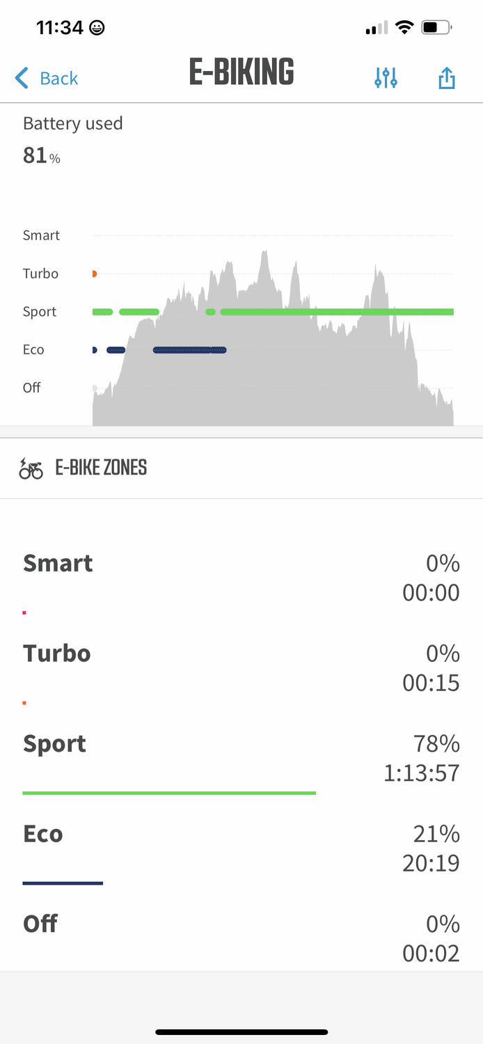

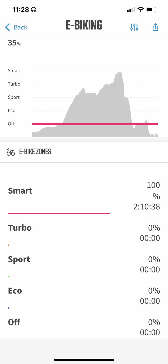

When I use Smart Control - Distance on my Turbo Creo, Mission Control determines how much assist to provide automatically. I assume that the level of assist varies during the ride, but I don’t get any feedback to confirm this. It seems that the Assist level would increase when I apply more power to the pedals, as though the motor automatically shifts to Turbo on hills and then drops back to Eco on flat ground. Or maybe the assist level rises to 90% on steep sections and reduces to 20% on level surfaces. My experience on the road does not match these expectations. Thankfully, the assist provided in Smart Control - Distance mode meets my needs. But I don’t get the sense that the power level is going up or down as riding conditions change. It’s certainly very noticeable when using manual mode - Turbo feels and sounds significantly different from Eco or Sport. It would be nice if the assist level in Smart Mode was displayed so I could see how much assist Smart Control has deemed appropriate. Then I could override it if I need more assist or want to conserve battery. The first screenshot below shows my Zones for a Smart ride. Telling me that I was in Smart Mode for 100% of the time has no value. I’d like to know what assist level was applied, either by Zone or by %, like I see when I ride in Manual mode - see second screen shot.

Your observations are correct Johnnie.
The primary function of the Smart Control - Distance, that is, ensuring you would achieve your distance/elevation goal with a given percent of the battery charge left works like a charm. Let me describe the logic there:
  • For the first miles of your ride, Smart Control is trying to determine the current Range Trend. If you are gaining range with the initial Smart Control guess then the assistance is increased. Whenever the Range Trend becomes negative, the assistance is decreased. You could ride with Smart Control on at a constant assistance for long long miles if the Range Trend appears to be constant;
  • Smart Control distance does not increase the assistance uphill. If you need a Turbo burst, press the + (or the next assistance mode) on the remote/TCU and you will get the Turbo assistance for 30 seconds;
  • In case you press the minus on the remote (may not work on Creo TCU), the assistance goes off; clicking the plus restores the Smart Control where it was left;
  • In case you press the pedals harder (or spin the cranks), the motor power is temporarily increased. However, Range Trend becomes negative, so the assistance is corrected by Smart Control to be lower for a longer distance (until the Range Trend stabilizes).
Smart Control can do miracles in case you are unsure whether you can make your goal with given battery charge. However, Smart Control deprives you a lot of your own control regarding the assistance.
I use Smart Control for emergency rides. For instance, I suddenly decided to ride for a fairly long distance against stiff headwind having only one fully charged battery in my arsenal (it was a Vado). Using Smart Control was the only reasonable way to return home with assistance. On normal rides, I plan the battery usage and control the assistance manually.
The new Mastermind has given riders two new tools: Range Trend display, and MicroTune (micro adjustment of assistance as you ride). The two tools allow the rider perfectly control the assistance (probably no Mastermind on your Creo).
