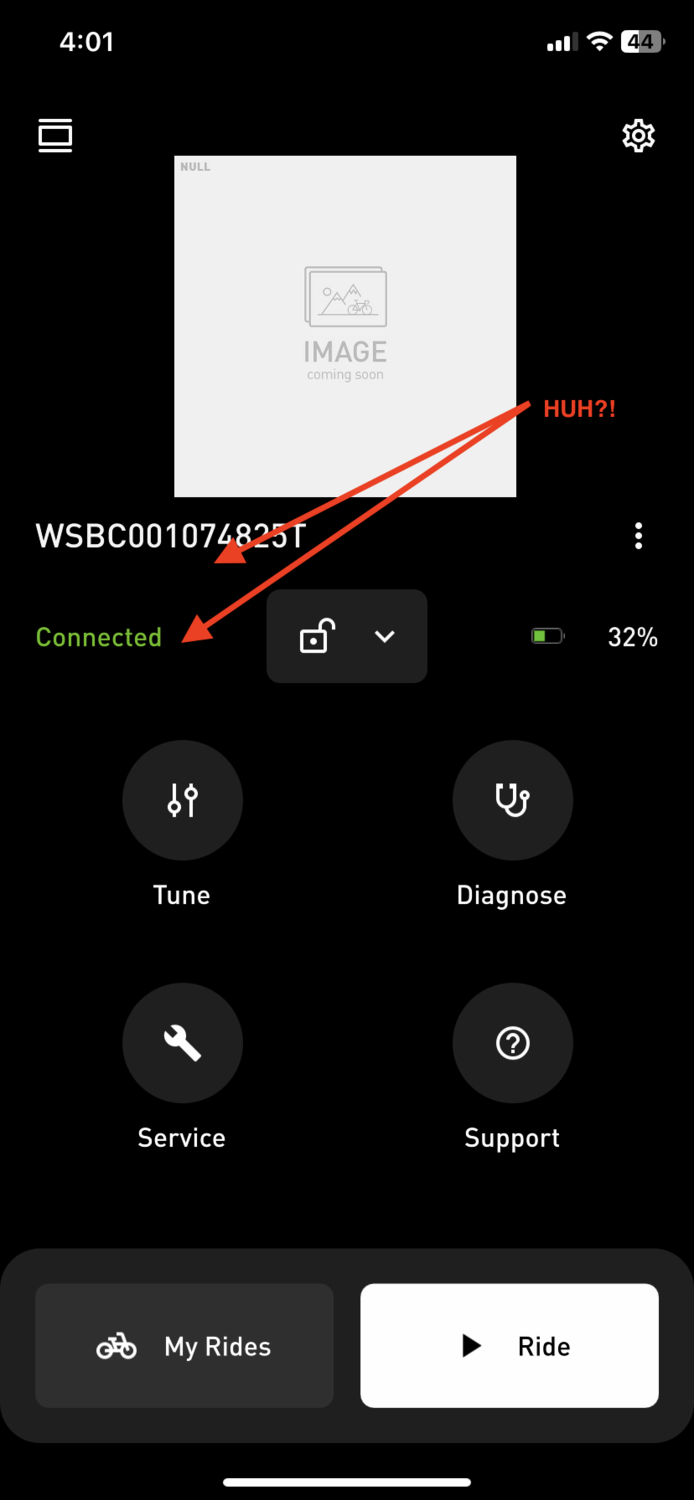

During my ride back home, it lost communications and acted weirdly.
Zero communication between bike and iPhone.

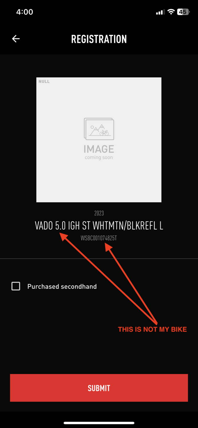

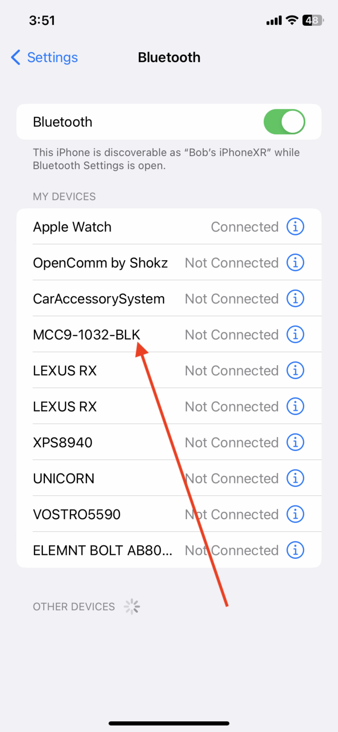

Upon arriving home, I inspected the bluetooth connection and it was not pairing successfully.
It was not showing a WSBCxxxxx serial # normally associated with Specialized e-bikes.
It was showing as MCC9-1032-BLK, very, very odd.
I ultimately "forced" the pairing to the MCC9***** and got it to see the bike. But it thought it was an IGH bike.

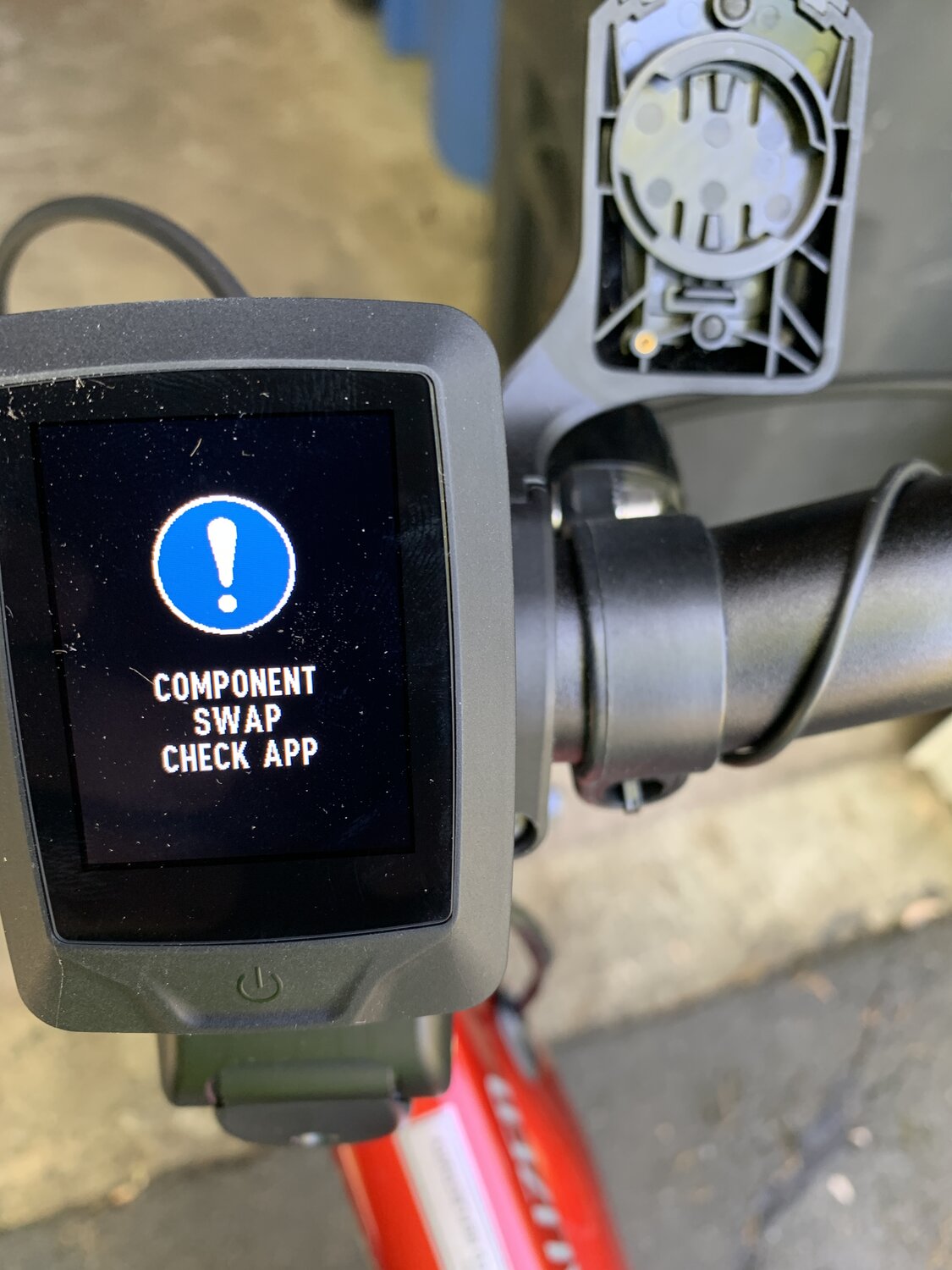

Then this:
Then this:
And this:
So, it seems the LBS did not correctly program stuff, I made a 2nd trip back to the LBS the following day and they reprogrammed things.

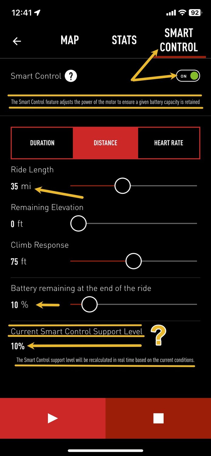

Here is the issue.
I've never before seen the display in Smart Control/Mission Control screen with the 10% referenced as per screenshot.
Anyone?

So, sharing this with the LBS, they referenced the following screenshot

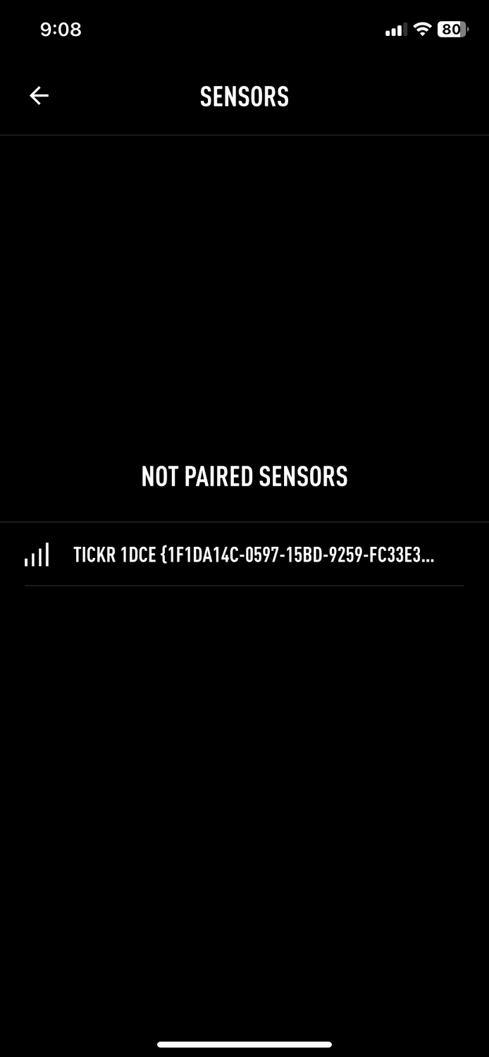

Not 100% sure what may have changed since the firmware update, etc., but I'll un-pair and repair my Wahoo Tickr and report back tomorrow.
My only concern is that I choose DISTANCE, not HEART RATE, so I do not see the relevance
So yes, I had a Wahaoo Tickr paired previously which still showed as a connected bluetooth device in Mission Control.
I dis-associated, unpaired it.

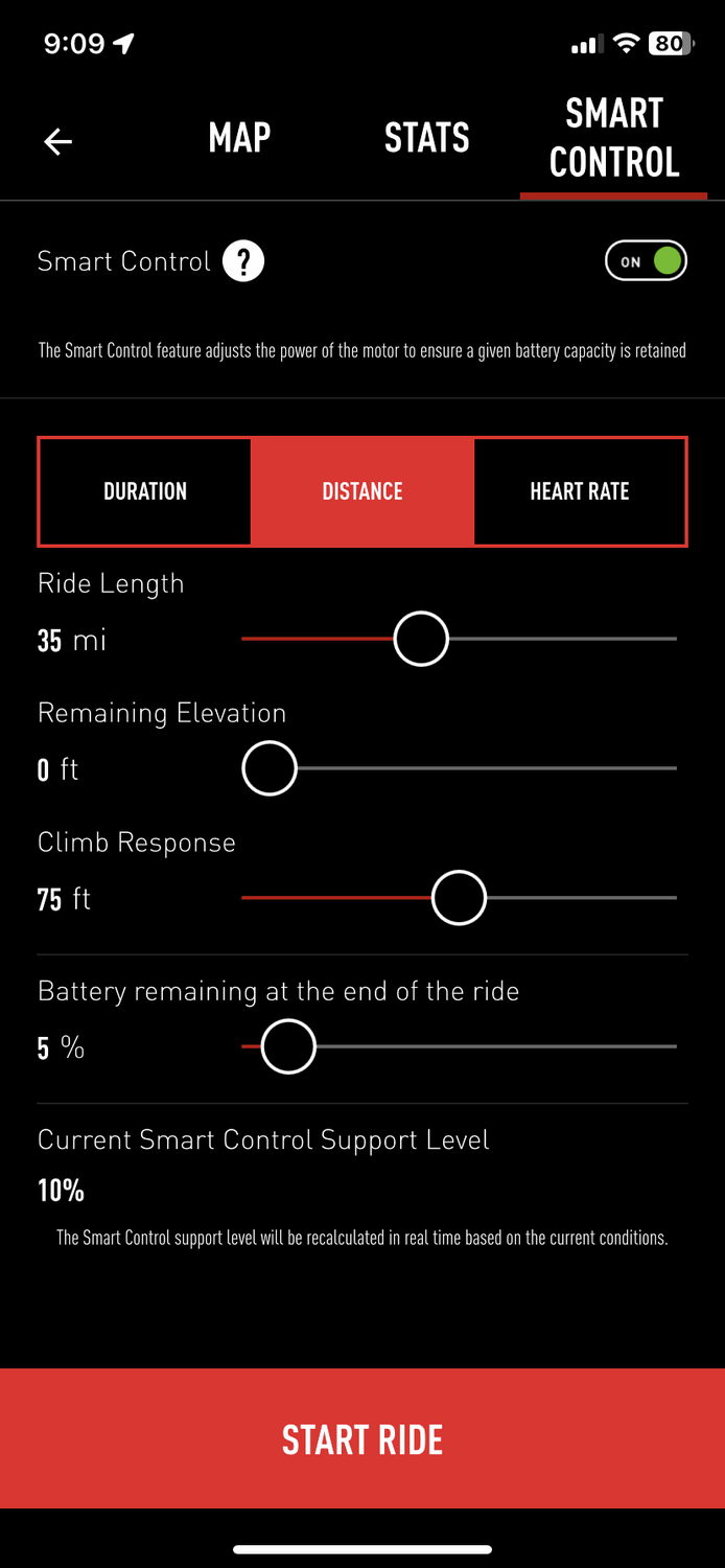

Still, Smart Control shows a 10% assistance.
Screenshots attached.

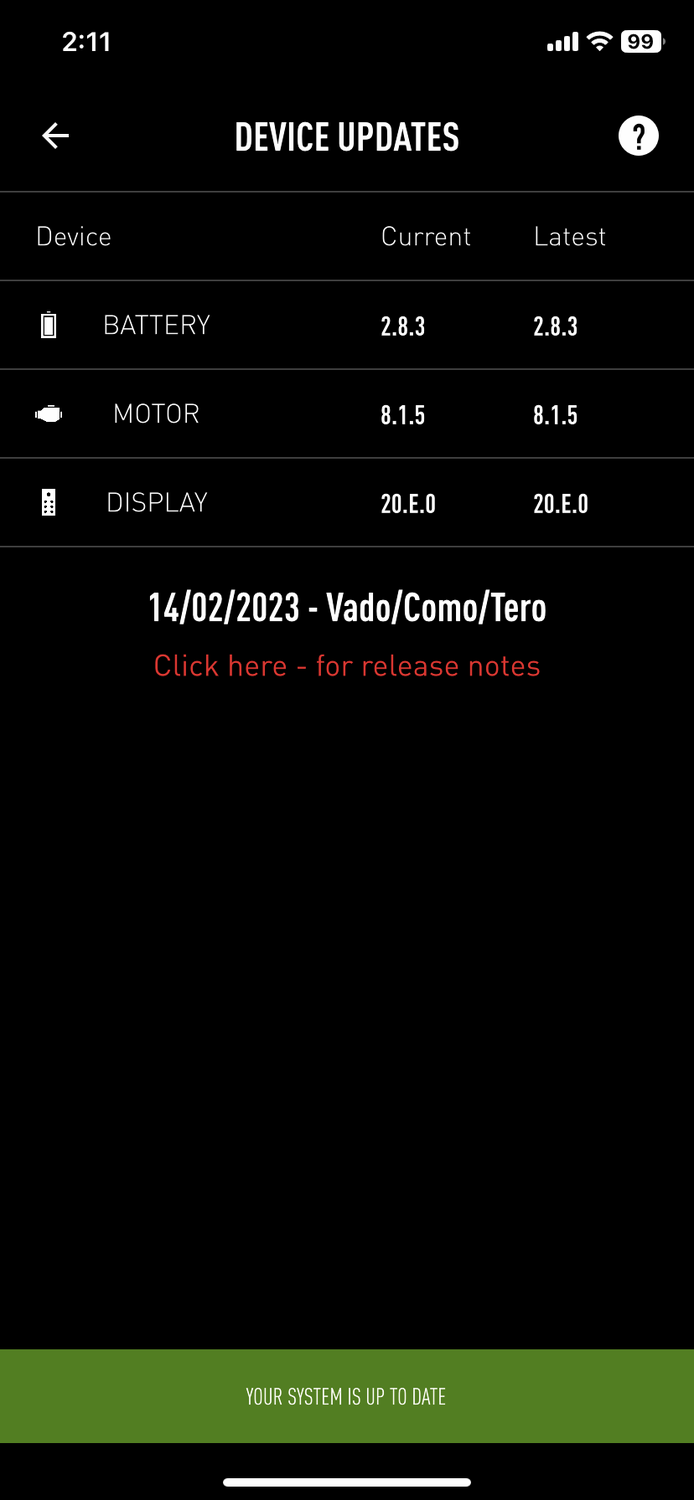

PRIOR to my bike getting the control and display swapped out, I HAD the latest firmware for everything.
My wife's Como did not have any firmware updates for almost a year (2 or 3 behind).
SHE experienced the very same thing just PRIOR to my experiences as well as when I took my bike into the bike shop on the 2nd trip to swap out the items again, the once more reflashed all firmwares, as well as my wife's Como, which I brought to the bike shop with me.
So....both bikes latest firmwares, same issues???
The manager of the bike shop called me and informed me that he checked a few bikes on the floor with the new firmware, and they reacted the same way....10% and almost no assistance in Smart Control.
He said he'd be reaching out to the mothership.
Anyone else have the same experience with Smart Control?

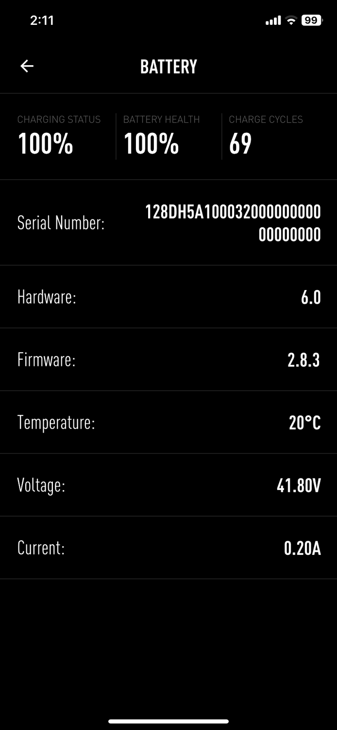

Attached reference screenshots of firmware(s) and Battery Health

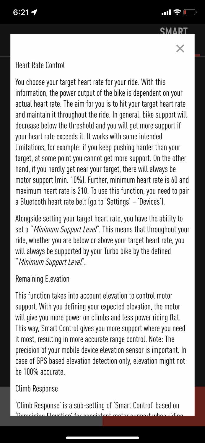

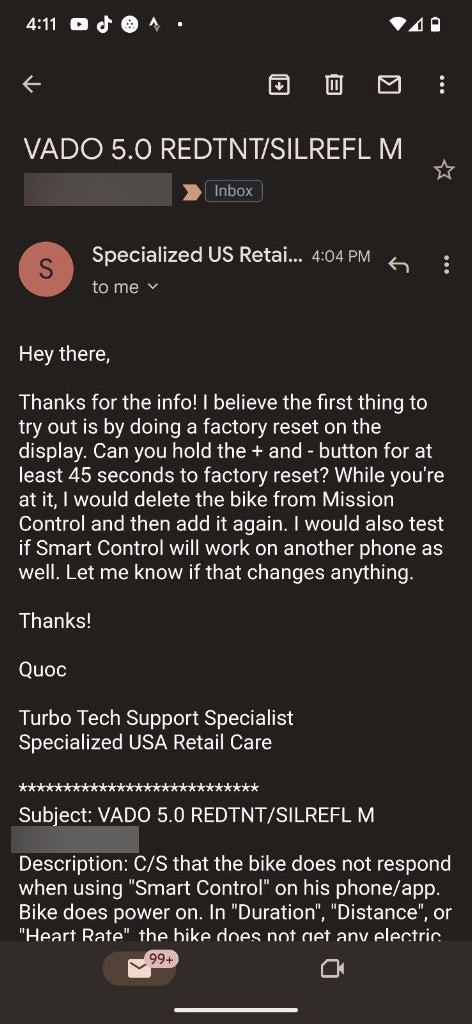

Well, this is the reply today to a LBS tech (BTW, I have already done multiple times what they suggest)
