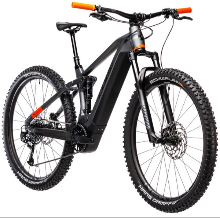

I have a new Cube ebike with Bosch Smart System CX Performance motor. When motor is off mode or even when it is totally off, when I am pedalling I feel something holding me backward and reducing acceleration. I have checked everything like brake disk or any other similar things, when I hold bike in air and pedal, everything is ok, but when I ride it I feel as I said. What can be the problem ?

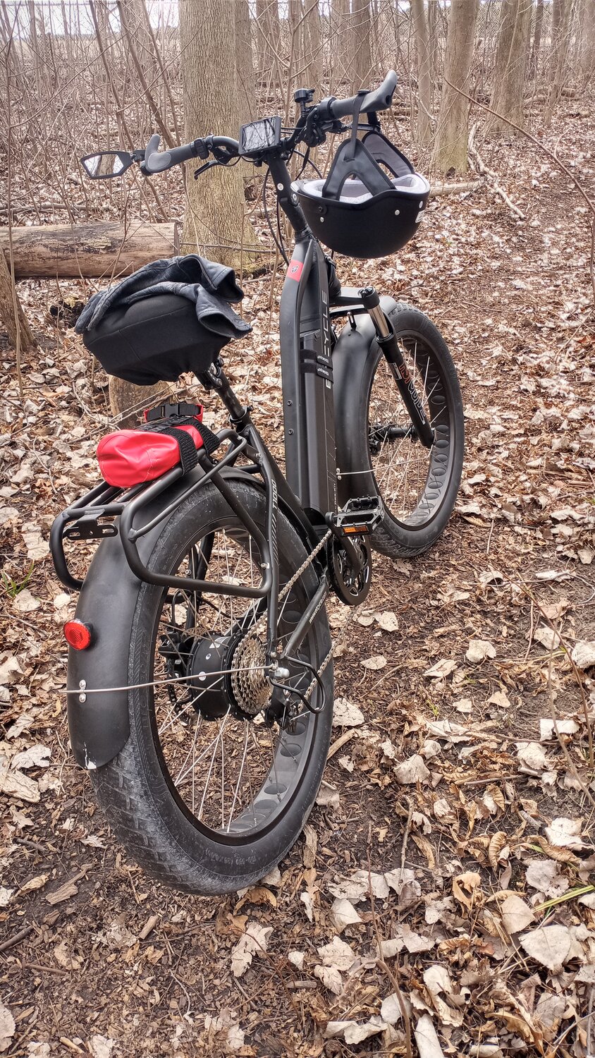

I am riding my bulls right now and the difference in effort is pretty big. 2" tires verses 1.5" tires. lately I am lucky if I can average 120 watts on my commute. on my trek I just did 149 average watts on my bulls. to get that on the trek I have to work my ass off even though the trek has 85nm of torque verses the bulls at 63.

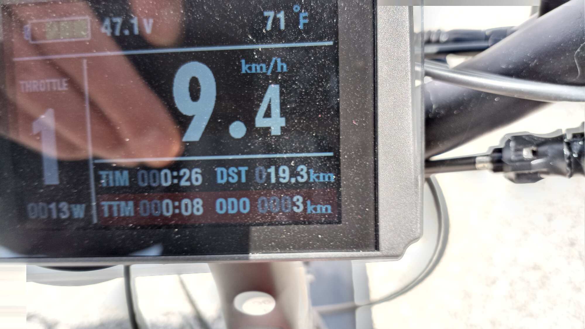

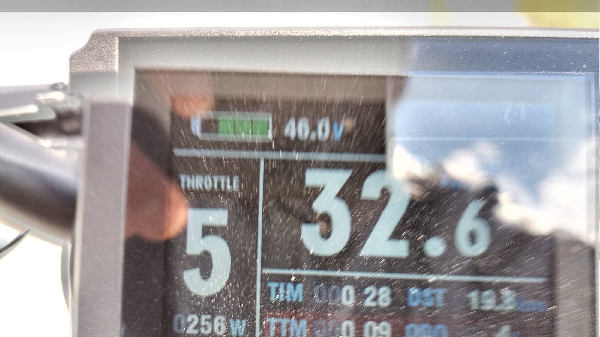

I was only using 13 Watts to go 9.4 kph on asphalt.
It took 256 Watts to go 32.6 kph a couple of minutes later.
If I had "normal" nobby fat tires, deflated to 6 PSI for comfort or sand, I'm sure it would take 250 Watts to go 5 kph.

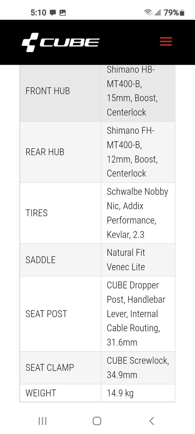

If this is your ebike,..
And these are your tires,..
And you are not doing this,..

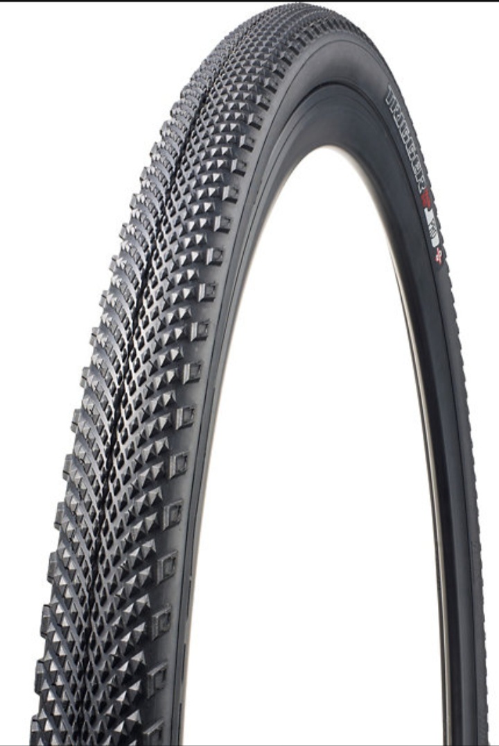

Then more efficient tires can go a long way towards making your ebike easier to pedal and not work your motor as hard.

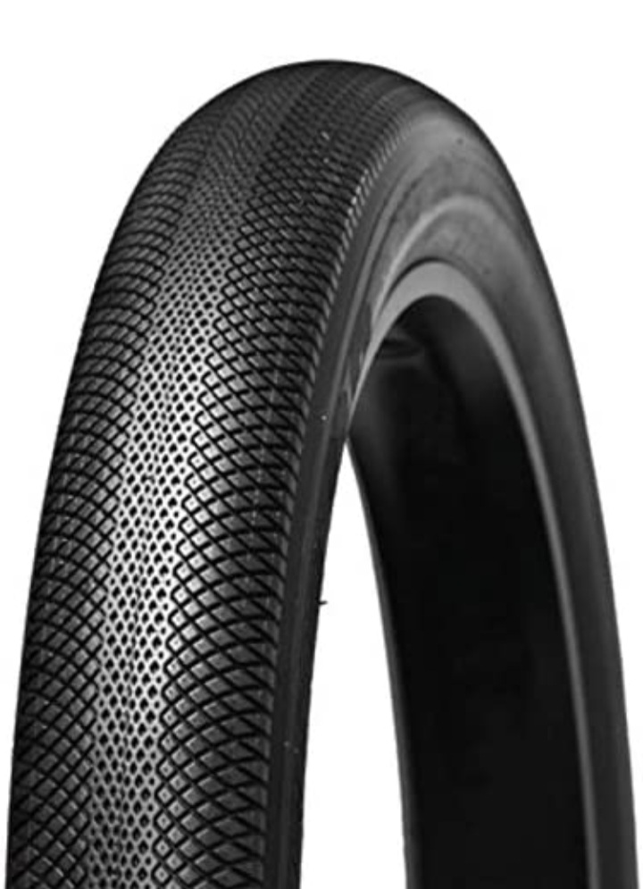

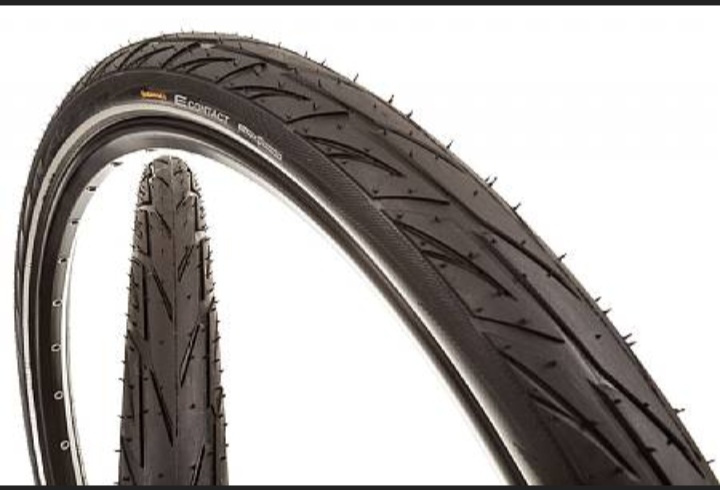

Something more like this can make a BIG difference,..
Or even more of a street type tread,..

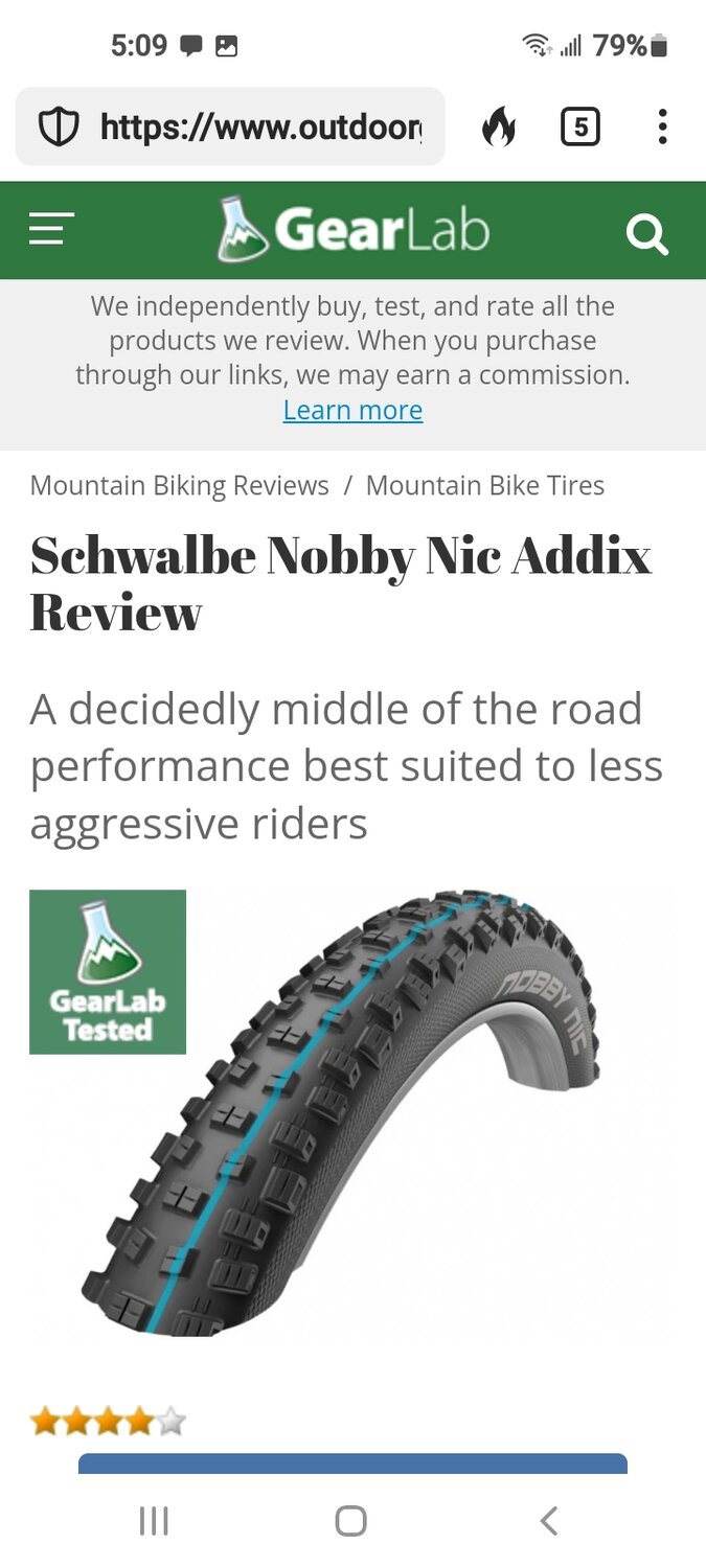

Screenshot_20230404-173354_DuckDuckGo.jpgScreenshot_20230404-173023_Amazon Shopping.jpg
Smooth tread can let go on slippery surfaces (like wet leaves on pavement), but so can nobby tires.
I had a dirt bike with big nobby tires and it was dangerous on pavement.
