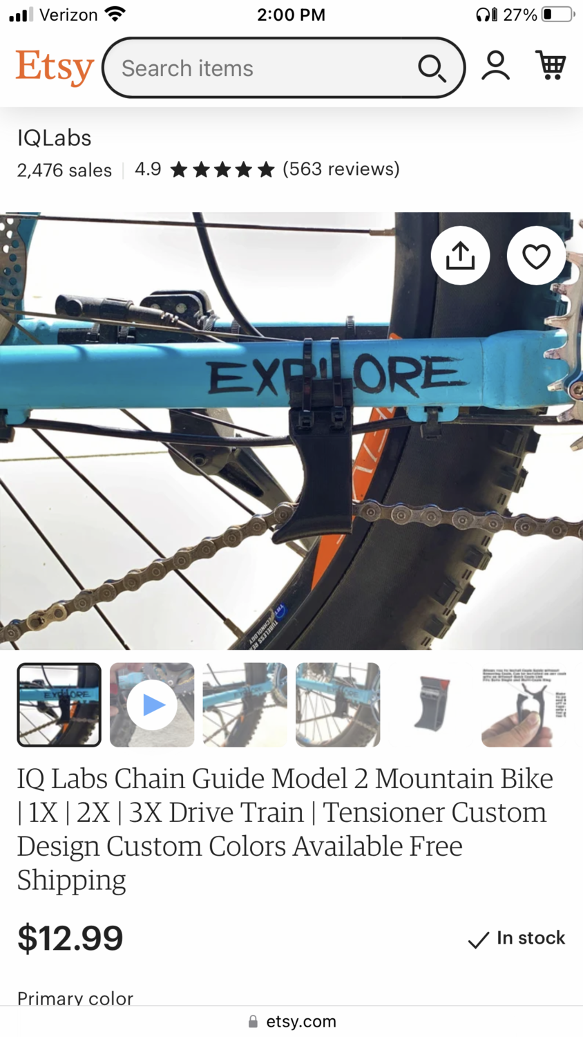

There is this I came across, which mounts to the bike’s chainstay….don’t have any personal experience with the design.
