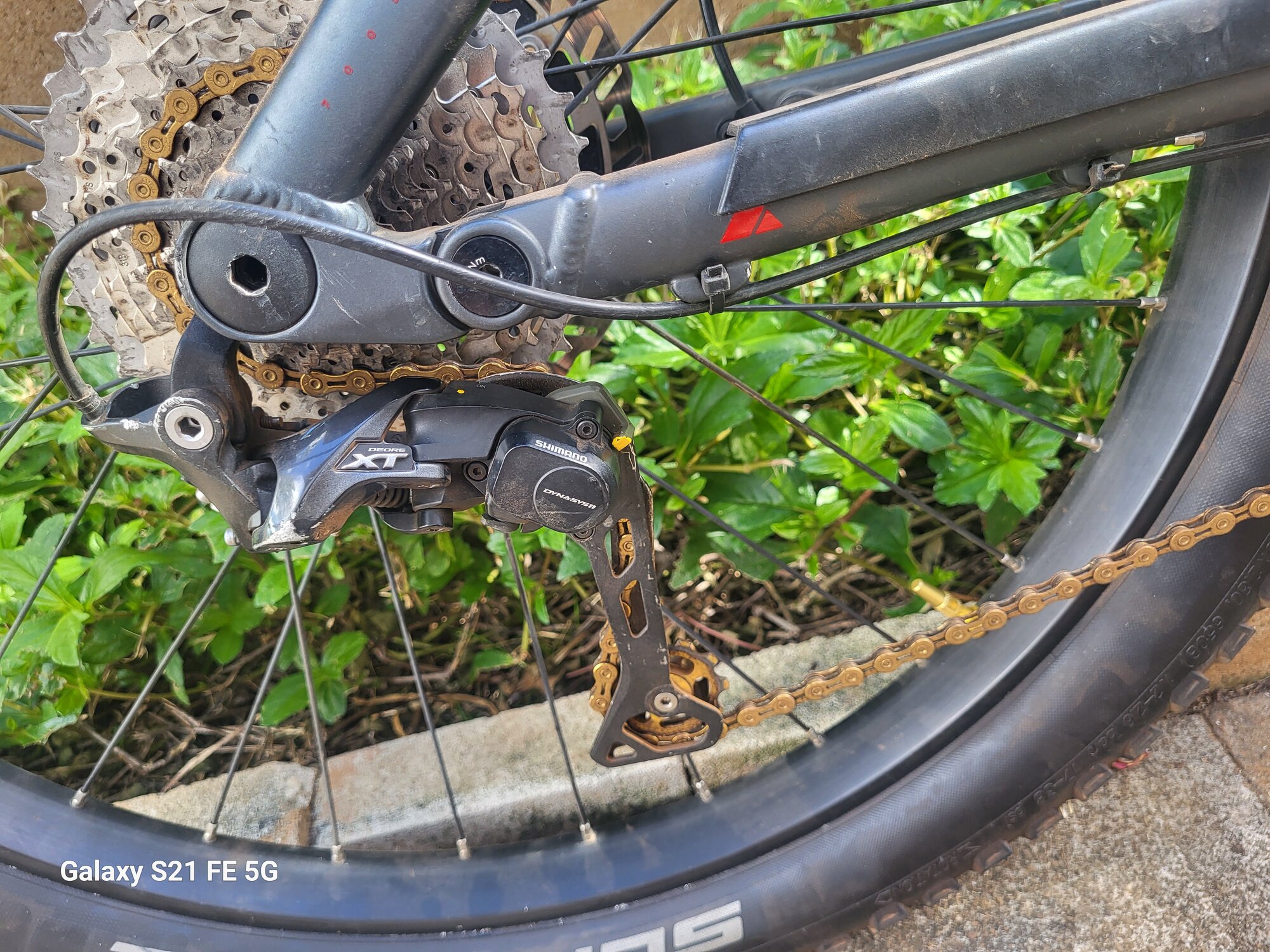

question for Vado SL riders do you guys ride with the Clutch engaged or not on the derailleur ?
i get mixed answers from different LBS.

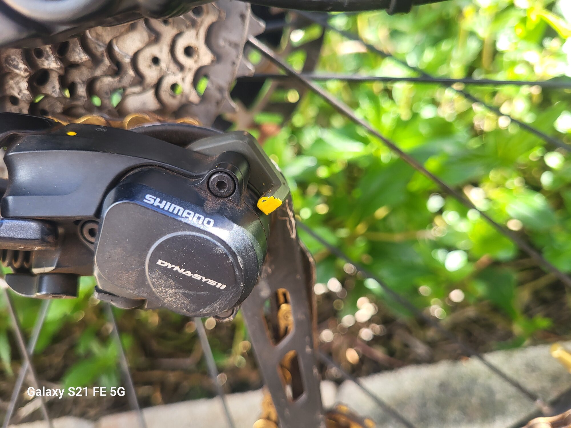

I have Shimano drivetrain there is clutch lever all it does is to make derailleur stiffer to reduce chain whip. It's always engage. Another benefit is when I disengage clutch makes it easier to remove and replace chain.
No clutch that I'm aware of.
Not really familiar what derailleur specialized Vados is equipped with.
Look-see at derailleur there should be a lever if not there then no clutch.

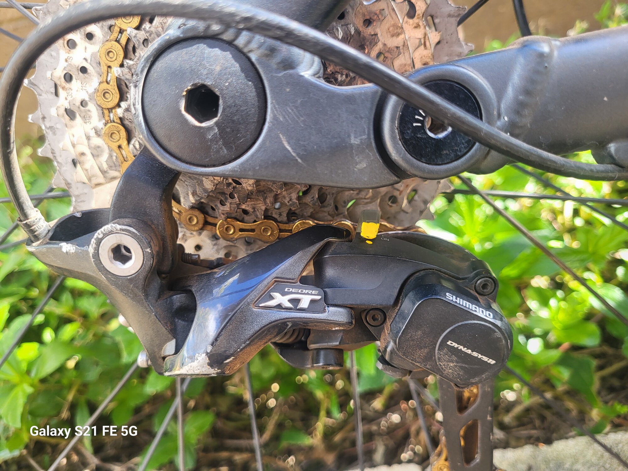

Zoom on pictures I marked it with yellow paint pen. Down position is disengage up is engaged.

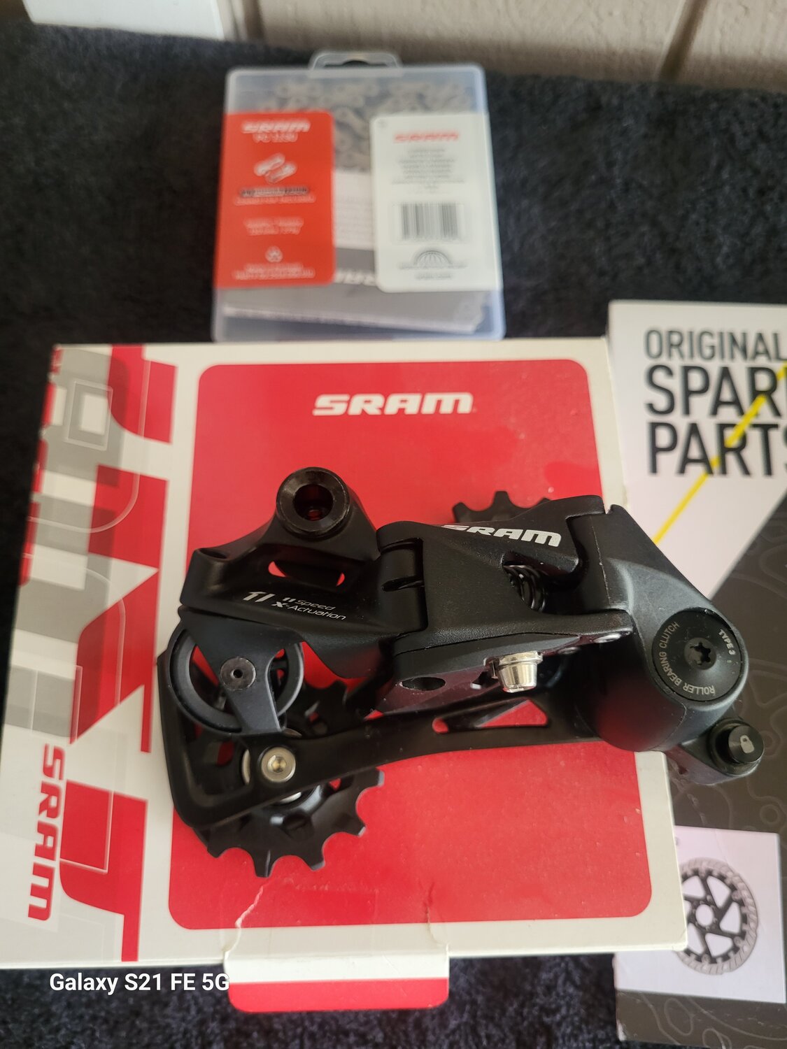

My spare derailleur and chain this cheap derailleur has no clutch my biktrix Monte Capro's oem derailleur original chain was 120 links I experiment with cutting off two links made it shorter because I rarely use lower gears than 7th on an 11speed cassette. Result is less skipping under heavy load. I didn't mention my bike is powered with bafang m620 it eats chains and needs new ones every 7-1000 miles
Guys:
Shimano MTB derailleurs (from the Deore class up) have the clutch.
SRAM derailleurs have no clutch.
I always ride with the Shimano "Shadow+" clutch on. The only reason to have the clutch disengaged on a ride (sealed roads) is a slightly easier shifting, or the need to remove the rear wheel.
There are two three* ways to prevent the chain drop off the chainring. Shimano went with the derailleur clutch first (the clutch is a chain tensioner). As SRAM had no clutch, the brand invented the Narrow Wide chainring most of us use nowadays (a patterned chainring keeps the chain as if the latter were glued to the former). It is said the Narrow Wide (or a different pattern such as WAVE) chainring prevents the chain drop better than the clutch. Nothing wrong to have both if your system allows them. The clutch is especially useful in rough terrain where MTB bikes are dominant.
SRAM has a button to lock the derailleur cage so removing and reinstalling the rear wheel is easier.
*) The third way is the chain guide, only used on MTBs.
Thanks, I was told that to disengage for rear wheel flat and tire repair or chain replacement. Just wanted to make sure
That is correct. Disengage when you prefer lesser tension on the chain, such as wheel removal or chain replacement. Otherwise generally keep it on.
