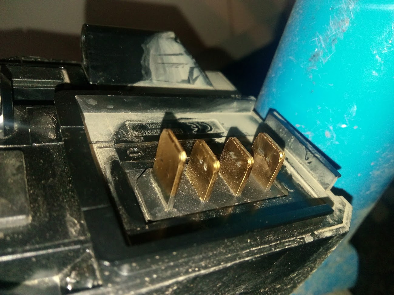

Hi Jen,
I suggest ask the shop to apply dielectric grease directly to the gold contacts on connector . As in the image above you would apply the grease directly to the 4 gold spades stiking out from connector. In my view the issue is related to contacts rubbing more than dust/dirt getting in...grease stops contacts rubbing and wearing. Seems counterintuitive but take it from an electronic engineer fretting is a common contact Issue in automotive industry
You can get grease from repco or supercheap.
I can't guarantee it will work but I'm now at 5000ks with no issue, I commute daily on very similar bike.

I had same problem @2300k. 100% agree with what Dave above says this is a connector issue caused by fretting(vibrating and rubbing in electrical contacts which leads increased resistance) or dirt and dust ingress . Any contact grease(dielectric grease) will prevent it in future. After cleaning - apply petroleum jelly or you can buy a application specific contact grease from most autostores.
Di-electric grease
Picture below shows what worn contacts look like....once I cleaned and greased the contacts bike is now @4600k with not a single error since. Frustrating yes, but simple to fix once diagnosed.View attachment 21079
