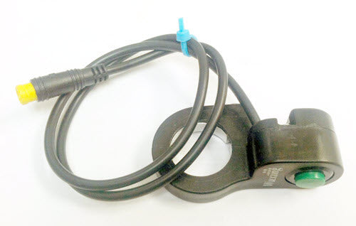

A very popular item, i was a beta tester and most thought it was just another bit of kit that added complexity when a simple brake tap, or slight back pedal did the same thing. I have 3 or four in my parts box where they’ll stay. I did put a Green Button on my wife’s bike. A thumb tap and shift.

I believe in the adage KISS, the less things to go wrong the less will go wrong. The brake sensors are essential and a safety mechanism, but to me gear sensors are not essential. I learned to drive on a three on the tree 56 Chevy, coordination between the left foot, right foot and right hand. I worked in train service for forty years, you don't make good time attaining speed you do by maintaining speed. I anticipate the hills and stops I make so as to lessen the need to shift under load. One question, what is a Green Button?
